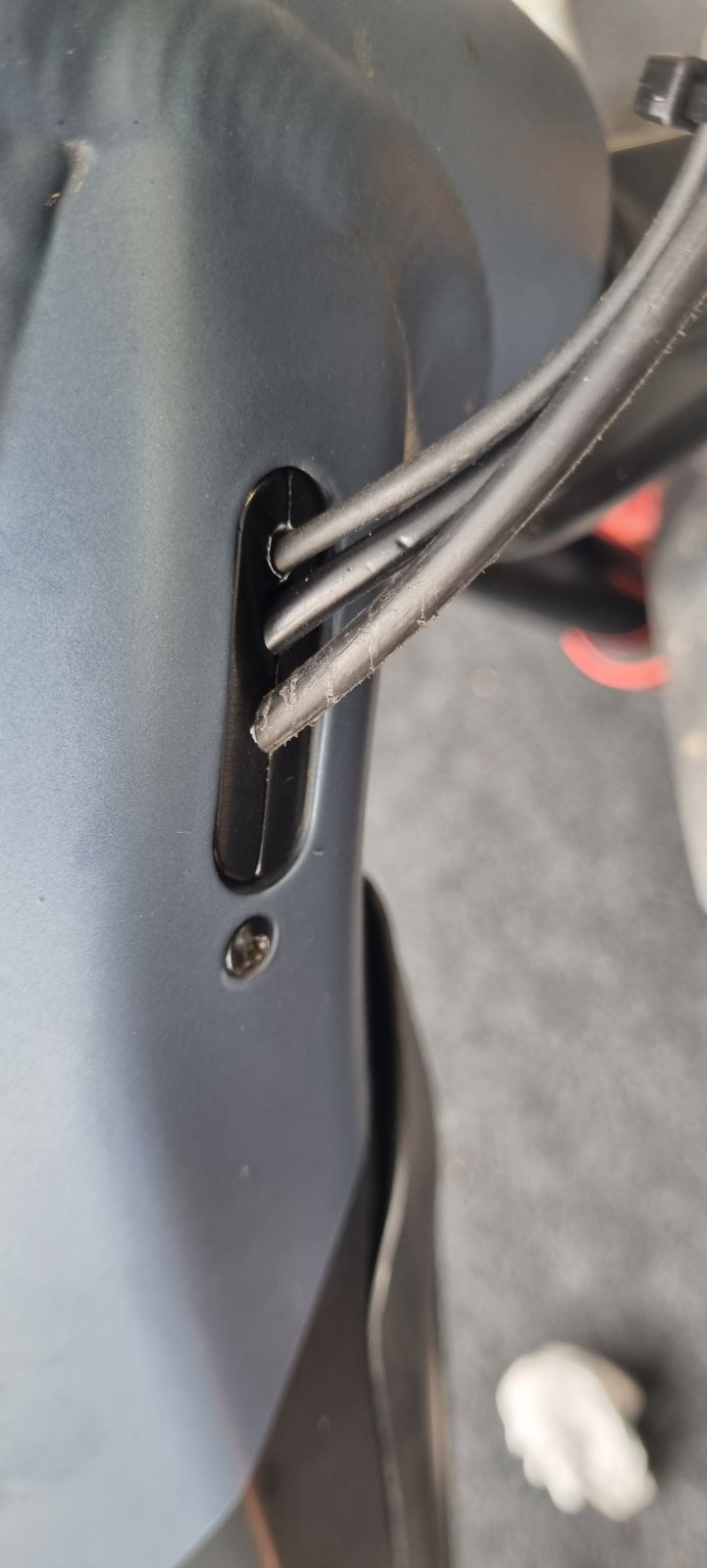

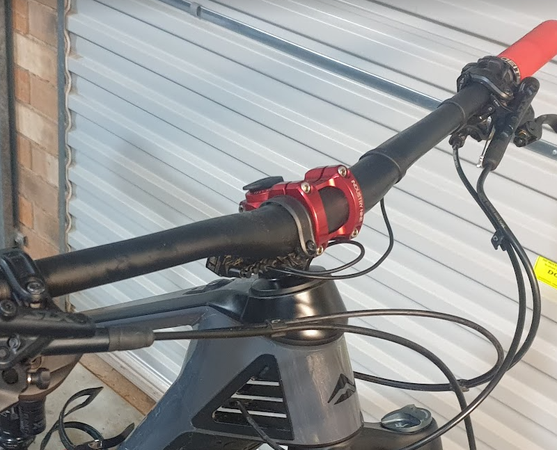

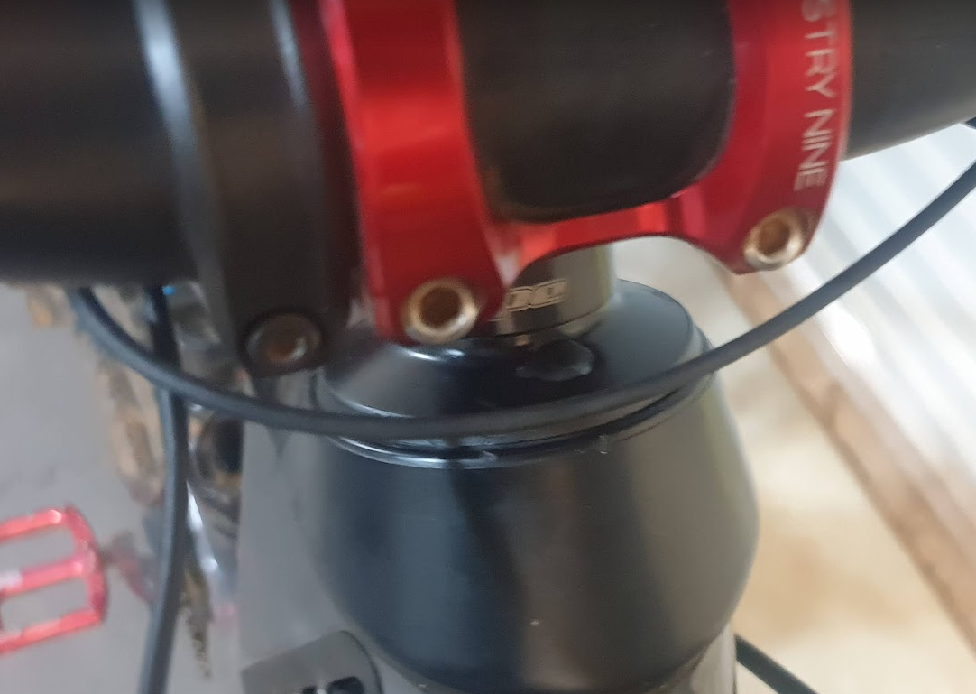

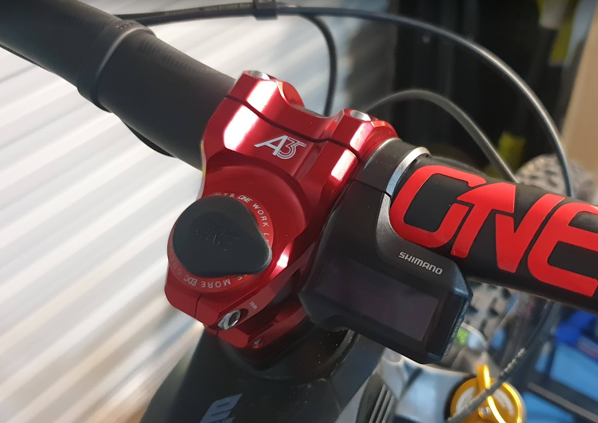

I removed the light, changed the stem and spacers on my 2021 E-One Sixty 8000 a couple of months ago. I also filled the small hole on the headset cap with some part epoxy as otherwise your headset bearings will fill up with water incredibly quickly.
I fitted up an Industry Nine stem, hope headset spacers and re-routed the LCD cable through the side vent on the bike.
Also to note that the mode controller cable runs internally through the handlebars, so it may not be compatible with all stems due to where the cable comes out of the bars. (I changed my bars at the same time and got some of the little shimano rubber bands)

I routed my computer cable and light cable through the existing cable block as supplied with the alloy frames. Just drilled two new holes in the block. Not as tidy as through the headset, but so much safer! Also noticed both bearings were stuffed after 10 months ago ordered some new ones.
There was a 2 month old carbon e160 at my lbs this afternoon which had cut through its cable with the knock block...
