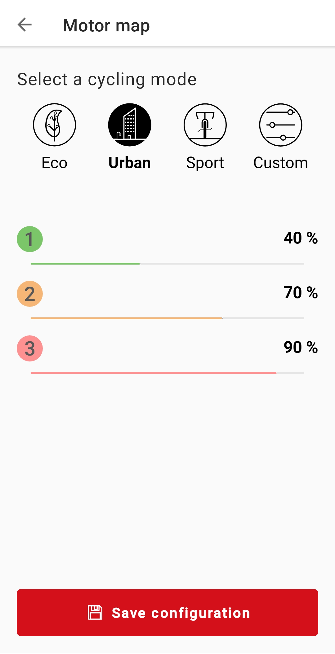

Hello, did anyone manage to connect the new Mahle app with the Dyname 3.0 to do engine mapping? I can connect, but once connected the app does not allow me to do aynthing...

What do your screens look like? Can you select anything else like engineering mode or ebike info etc? Are you signed in?
This what mine looks like connected

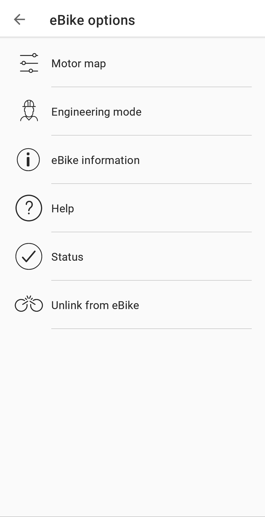

Then when I click on the double gears in the upper right corner.
Nothing is greyed out.
