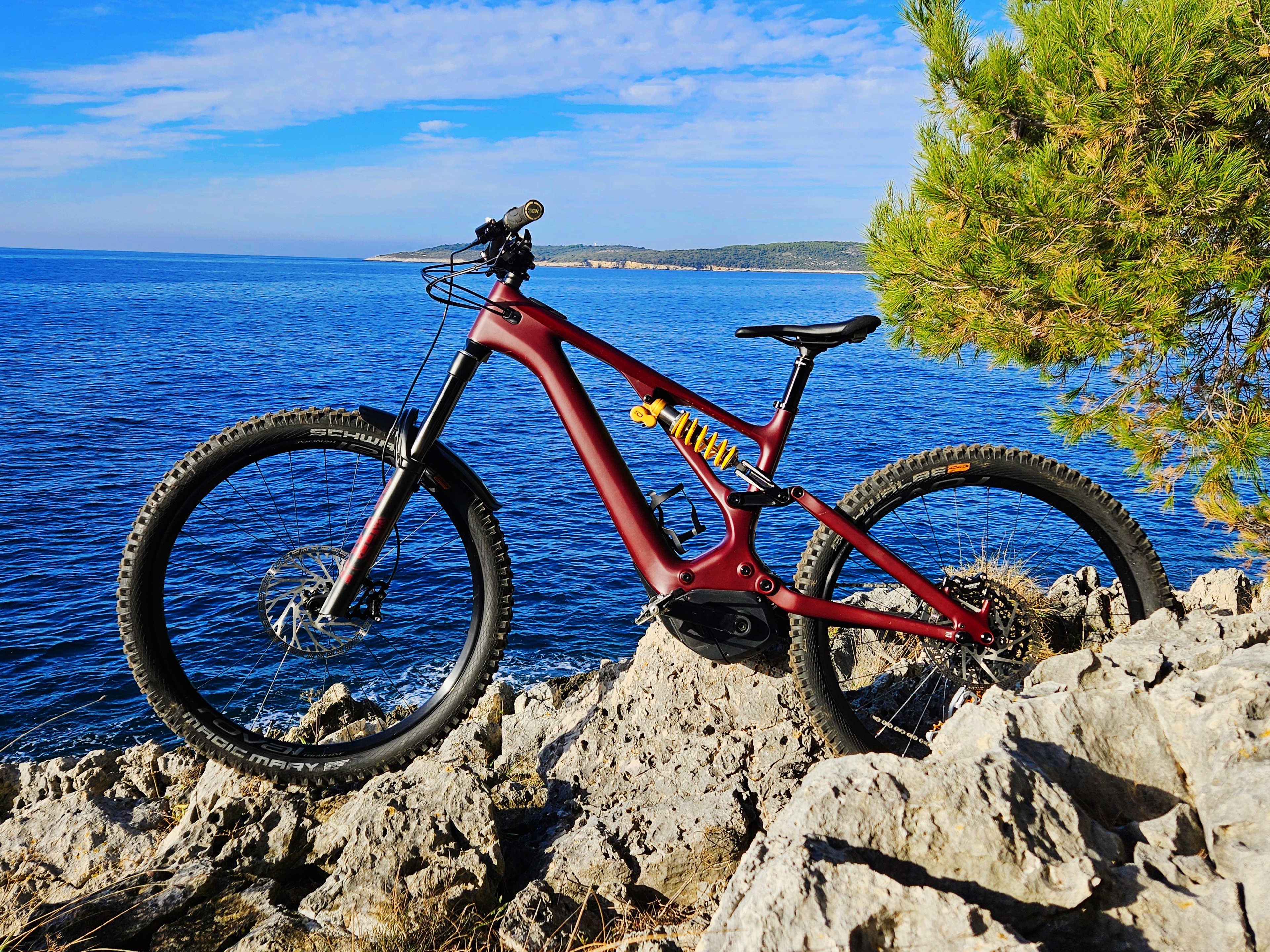

After two seasons on Roval Traverse wheels on my Gen 3 Levo, I sadly managed to damage the rear rim.
After years of experience with bicycle jewelry and and exotic wheels, I have become a pragmatist, especially in emtb category, where wheels seems to be more prone to damage.
It's led me to consider the DT Swiss HX 1700 (35 mm) as a replacement. However, I can't help but be a tad concerned about the lower spoke count (28) on the pre-built wheels.
To address this, I'm also contemplating going the custom route with DT Swiss 350 Hybrid classic hubs, paired with 27.5" HX 581 35mm / 29" HX 531 30mm rims, laced up with 32 Sapim Force spokes.
What's your take on the DT Swiss HX 1700 wheels, especially considering the lower spoke count? And does anyone have experience with custom-built wheels on a setup similar to mine?
For a bit of context, my ride is Gen 3 Levo Expert rocking few mods:
- Fox 38 170 mm fork
- Vorsprung Smashpot
- Öhlins TTX22 230x65mm shock
- Cascade long shock kit
- Trickstuff Direttissima brakes
- Galfer Shark 223 /203 mm rotors
- BikeYoke Revive MAX 213 mm
- SQlab 3OX carbon 12° / 31.8 / 45mm rise handlebar
- Hope Gravity 31.8 / 50 mm stem
- Schwalbe Magic Mary 29" 2.6 front
- Schwalbe Big Betty 27.5" 2.6 rear
I weigh in at 85kg and tend to enjoy the rough and rocky terrains.
Cheers!

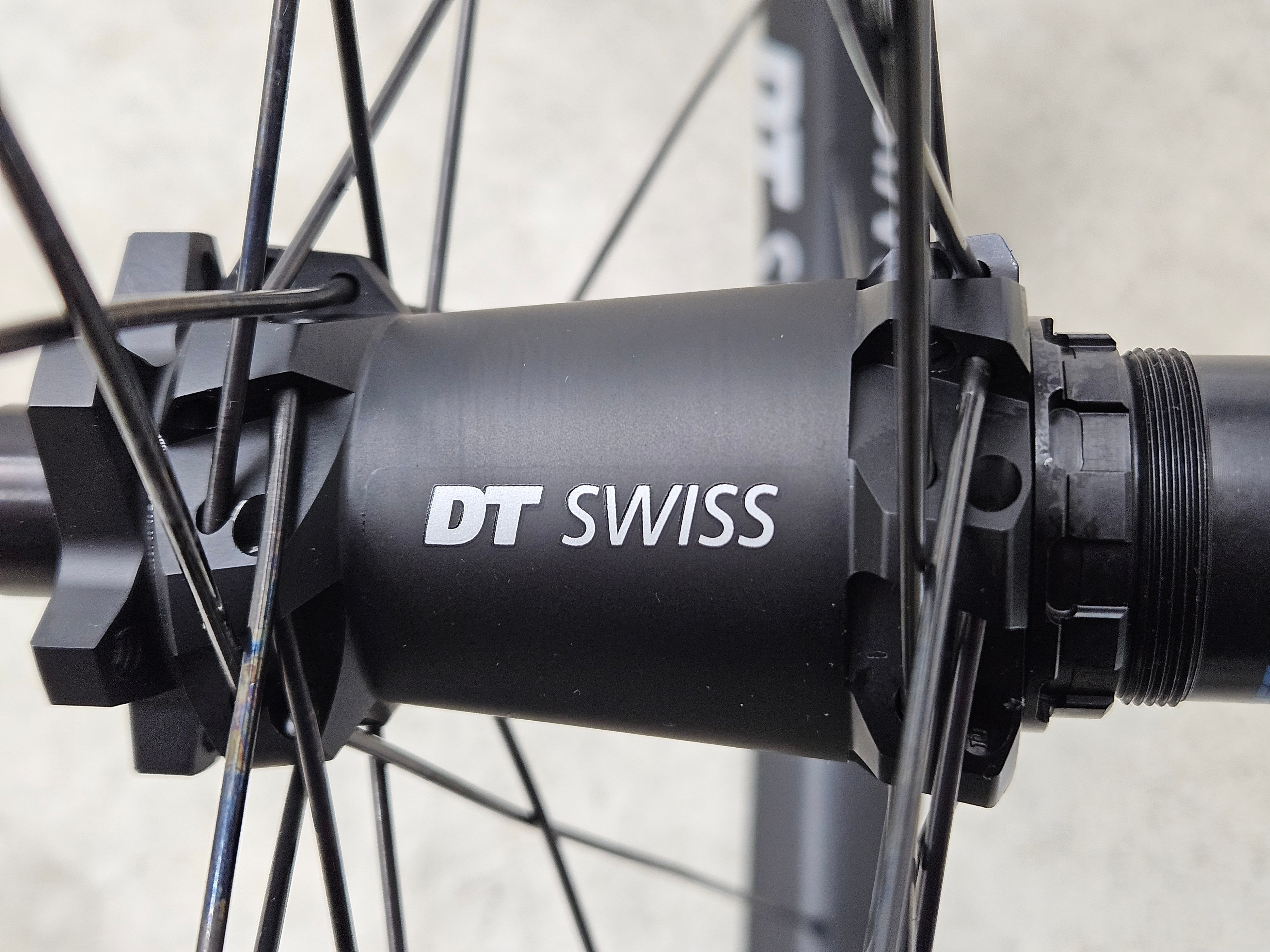

I have the HX 1700 Hybrid wheelset on my bike and it seems pretty bulletproof. As a complete factory build ( the new 350 hubs, HX351 rims, and reinforced Hybrid 1 spokes) I think it at least removes the potential for a less than perfect custom build. Bit pricey though!! The complete set up has been specifically designed to withstand the extra forces involved with an EMTB and the 24T ratchet system is also well sealed and very low maintenance unlike most pawl systems.

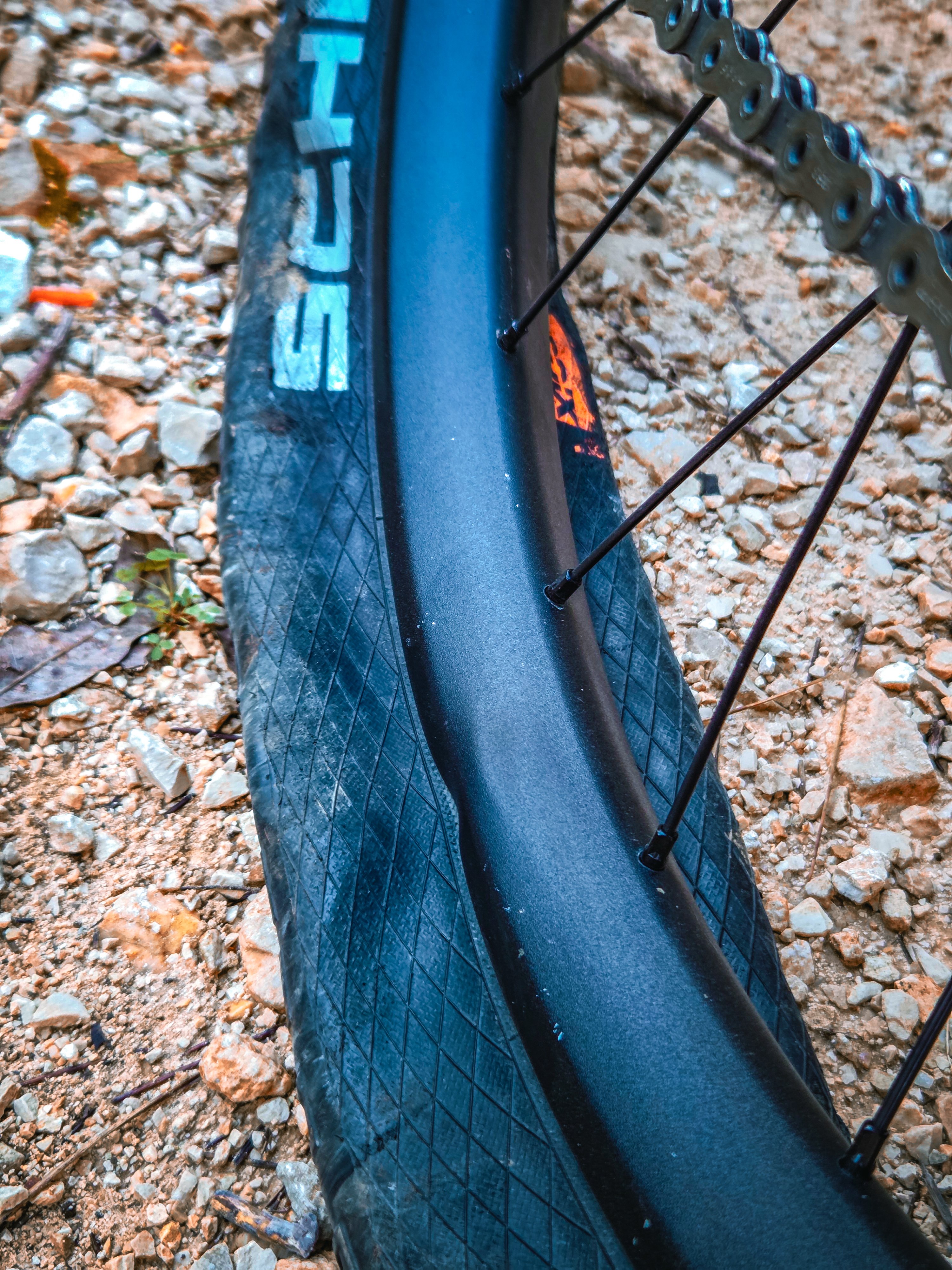

I run 2.6 tires on Newmen sl.eg 35 rims. The tires are much more stable at low air pressure on 35mm rims than on 30mm rims. I tested it 1 on 1.
I can believe that...but the tyre also adopts a more square profile with a wider rim so that can impact performance depending on the tyre in question. I think higher volume tyres increase comfort but as I said above that can be at the expense of stability on the rim in my experience. My preference is 2.4. in terms of tyre width.......each to their own though!
