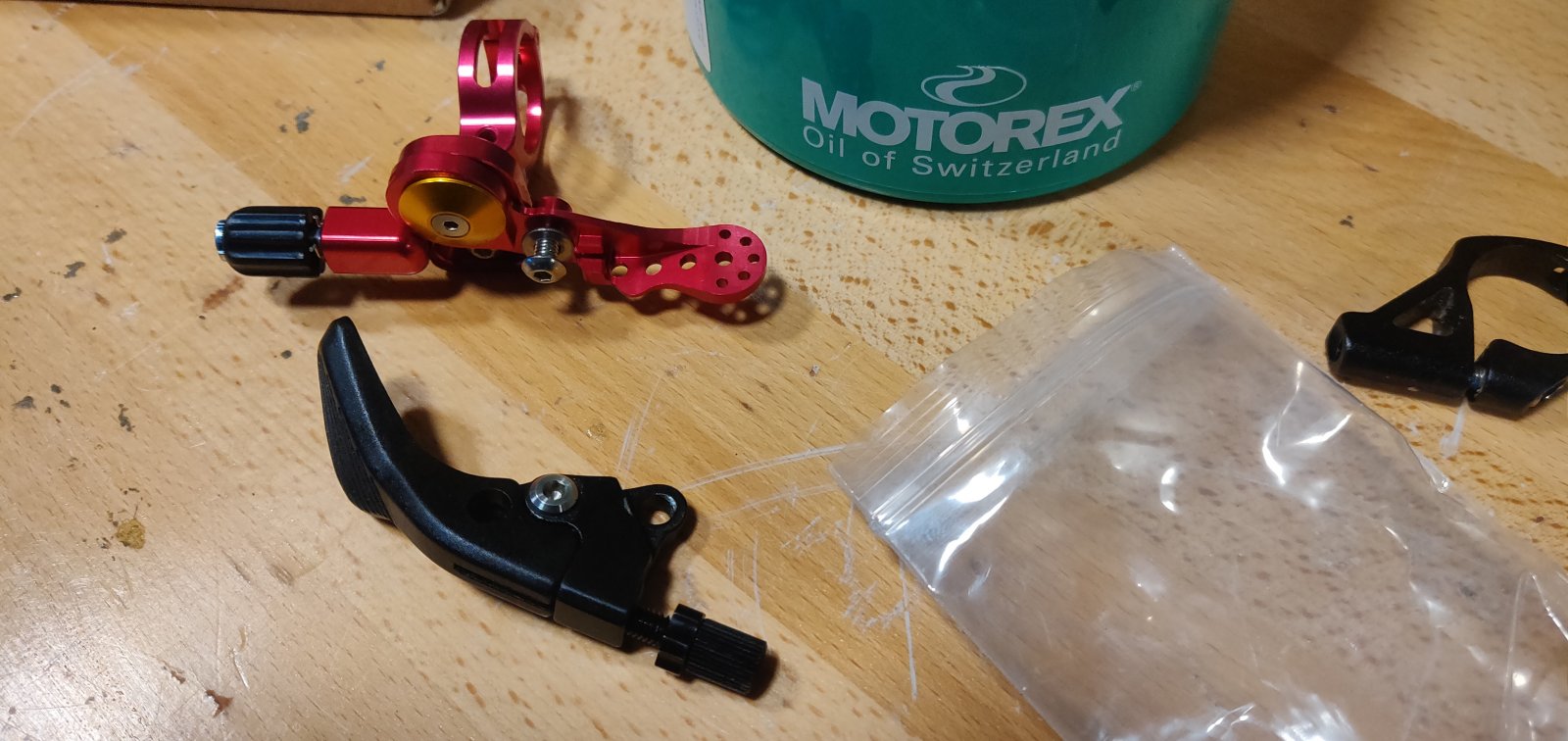

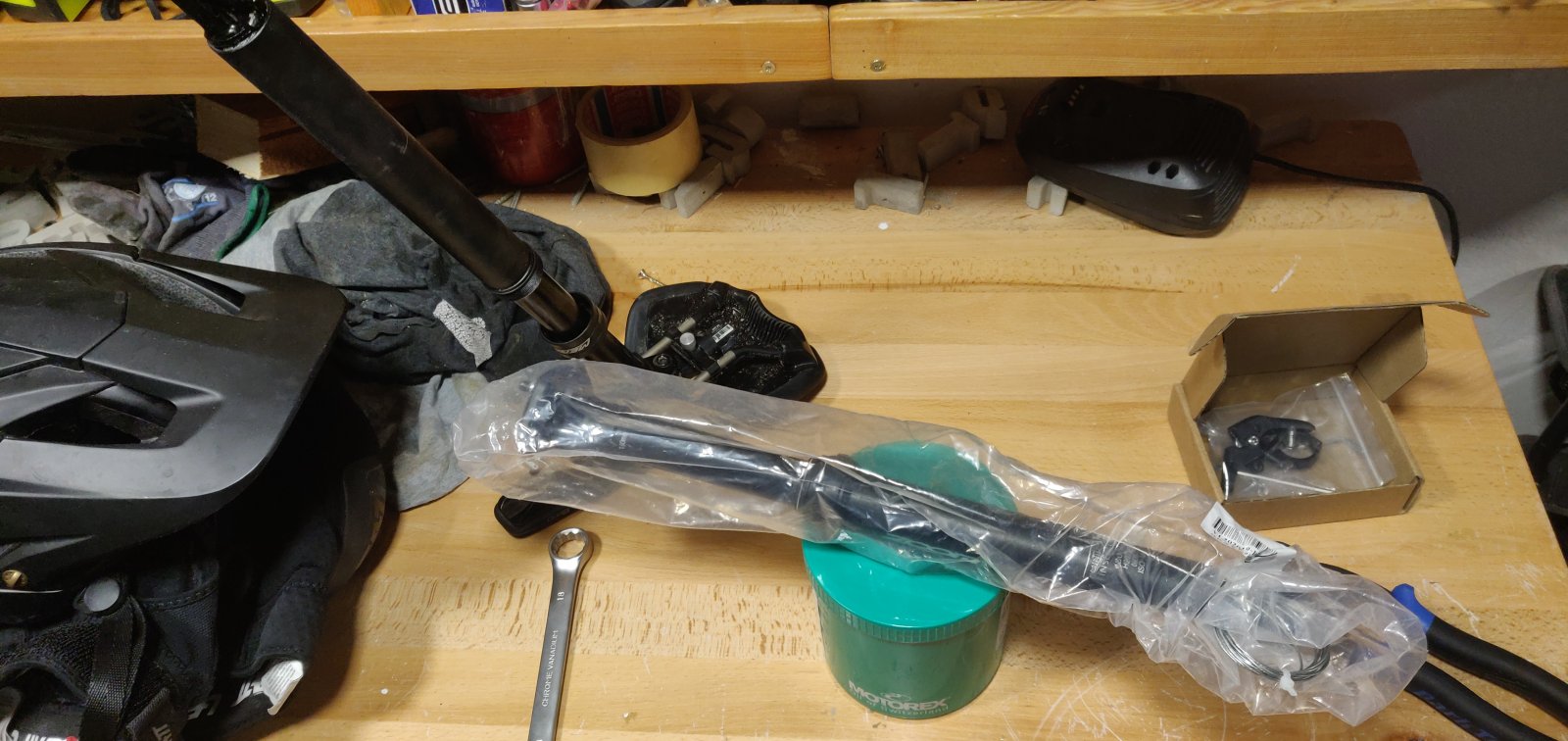

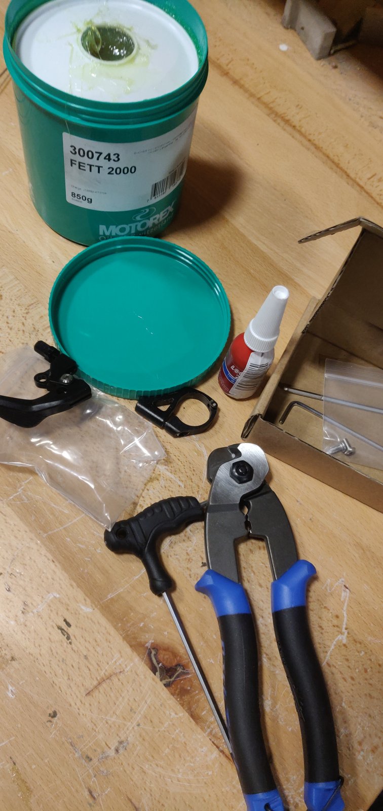

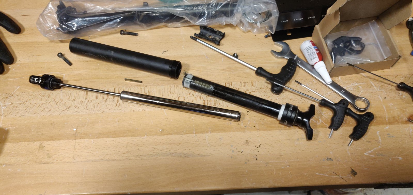

In this case I replaced only the cable and lever, I also cleaned the dropper post completely. I greased the cable before putting it in the hose.
anyone else think the original Merida lever sucks ?
