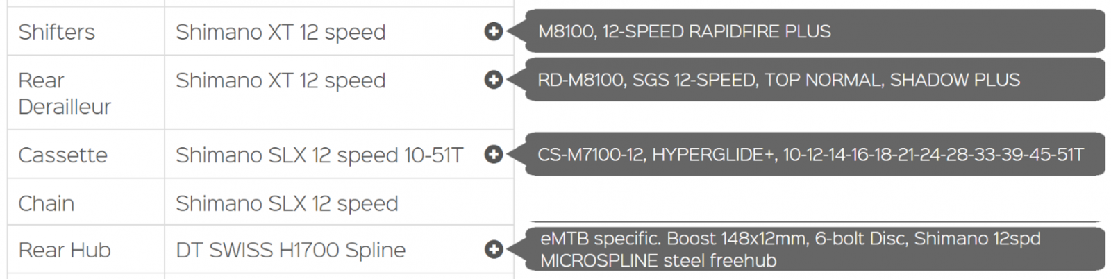

I tend to swap chains when they hit 0.5% stretch, but hit that marker at only about 550km on my 12-speed Vitus emtb. I’m not sure I’ve ever troubled the largest cassette sprocket, and my sensibilities were offended paying £40 for a replacement chain, so was considering downgrading to probably 10-speed when the drivetrain gets knackered. Then I had perhaps my stupidest and most annoying crash ever on the road about 100m from my house, banjaxing my rear mech, so am planning the downgrade now.
I’ve only ever really done simple maintenance, generally only replacing components like-for-like. Given the sheer stupidity of the crash, my brain has decided that my penance is to do all the replacement work myself.
So, I have to replace the cassette (obvs), mech, chainring and shifter. However it hadn’t dawned on me ‘til this morning that I’d need to replace the freehub. I’d like to get the job done in one shot, without popping to LBS. (I’m “shielding” as the wife is on industrial-grade immunosuppressants.) So, my question is, what if anything am I forgetting? Ta loads.

Cheers Rusty. I'll certainly swap cables and do all that sensible stuff. I've never really poked around with freehubs, so I've no idea if the same could be done with mine.
Here's what's on there at the mo ...

Me, I would go for the following:
XTR M980 10 Sp Shifter
XT Shadow Plus RD-M786 Derailleur
Deore CS-HG 500 11-42 Cassette
CH-HG54 Chain if wanting to stay Shimano (or my pref KMC X10)
Not certain if the DT Swiss hub will take 10sp - best to contact DT Swiss support.

go Zee FR mech and Deore 11-36 cassette with a SRAM 1030 chain (cheap and durable)
The Zee mech slightly stronger than the XT and being short cage will be bettewr tucked away and give you better clearance from hits
I actually prefer the cheap 10speed Zee shifter to XTR or Saint (but that's just personal preference).
SRAM 10spd cassettes are not as strong/durable as Shimano 10spd cassettes but are slightly lighter (comparing at similar pricepoints)
You'll need to swap out the microspline freehub for the DT shimano HG freehub that fits your particular hub (DT do make one for yours)
