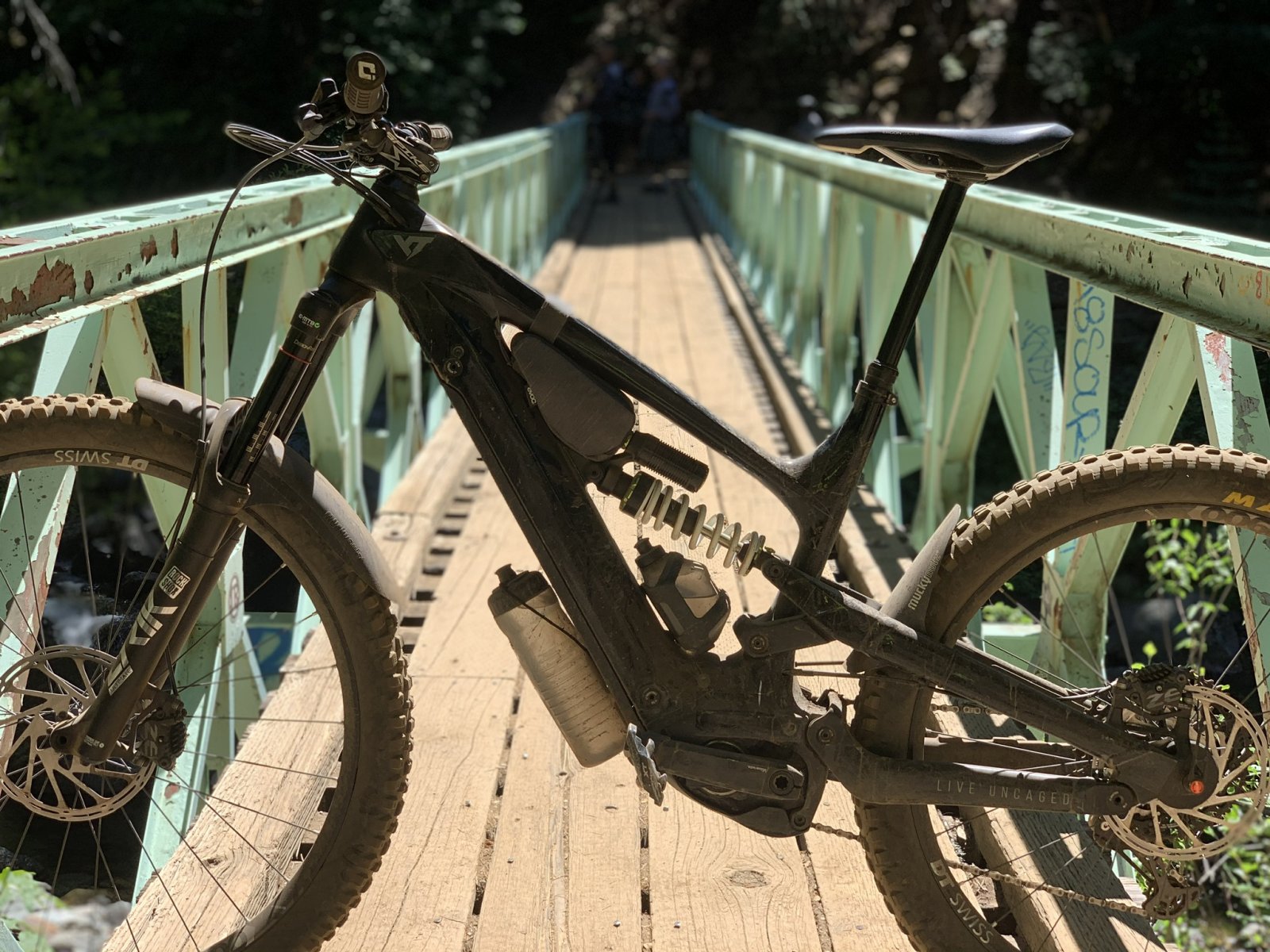

What is that accessory bag you got wedged between the top & bottom tube? Looks like it also has a pump. Looks like it could hold everything I need inside, including the multitool. Like I said I don't care bout fitting a bottle, I just need a place for the repair kits & tools.

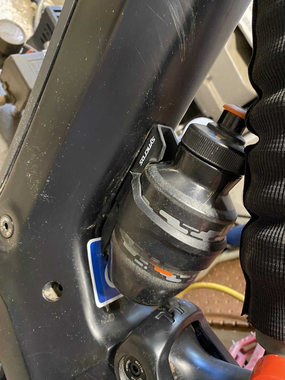

Syncros Kids Bottle/Cage will fit and work on the YT Decoy. You don’t get much water, but I feel it’s just the right amount for a 2 hour ride. I end up drinking less water when I eBike and who wants to pay $50 for the YT one. The Syncros Kids Bottle comes with the side loading cage, too. You may have to grind some of the plastic on the lower part of the cage, but that is easy.
https://www.syncros.com/us/en/product/syncros-kids-set-pak-12-bottle

Thats good, i like it. My yt bottle has some wear to it now and theyre $80 cad with shipping. The syncros has a left side removal option too and thatd be preferable with our right side brake lever.
For op: i have a one up pump with the one up multi tool inside mounted beside my yt bottle, just need longer water bottle mount screws
If you zoom in on the pic its got an Evoc label on it.
