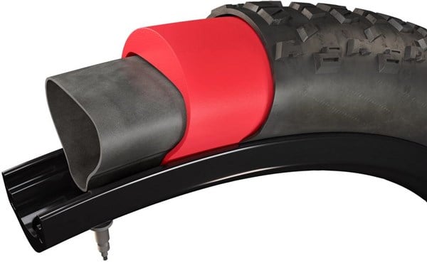

Just ordered a Tannus armour insert for rear tyre to protect the tube which has been punctured 3 times in my first 2 weeks of riding a new ebike.
Does anyone have experience of this product? Is it any good?

A lot of interest lately, I think they're great.
Tried tubeless, kept getting leaks, could have been my bad fitting job.
Had tubes and Tannus in for over 300mls now, majority off road.
They are firm even at 20-22psi, so you can go 16-18 easily.
I find 18 is the sweet spot on mine with the current tyres, that may change in wInter when I put some more aggressive boots on. They'e still stable in corners and take any hits, roots and rocks, not had a puncture :)
You can fit yourself, its relatively easy, just be methodical and take your time and have "good" levers.
I'm 27.5 x 2.6, Tannus are 2.5 but dont let that put you off, I spoke to Tannus direct before buying and they confirmed they'll be fine in a 2.6, they are :)
£29.99 each, but they don't need any maintenance, just bought another two for my wife's E-cube.

Just reflecting, you also get a damping effect/feeling that you notice when you've fitted them, I notice it most when pumping on lower pressure.
Another advantage is if you run summer & winter tyres , they just change with the tyres no extra cost, I believe tubeless would require the fluid changing.;)

Still no punctures , the difference of the extra weight is negligible.
I run 20lb pressure F/R
In my opinion, tubes, armour inserts or tubeless, you still need to look down the trail at what’s coming and ride light.
If you plough through everything thinking indestructible , not that you are, it has to back fire at some point.
