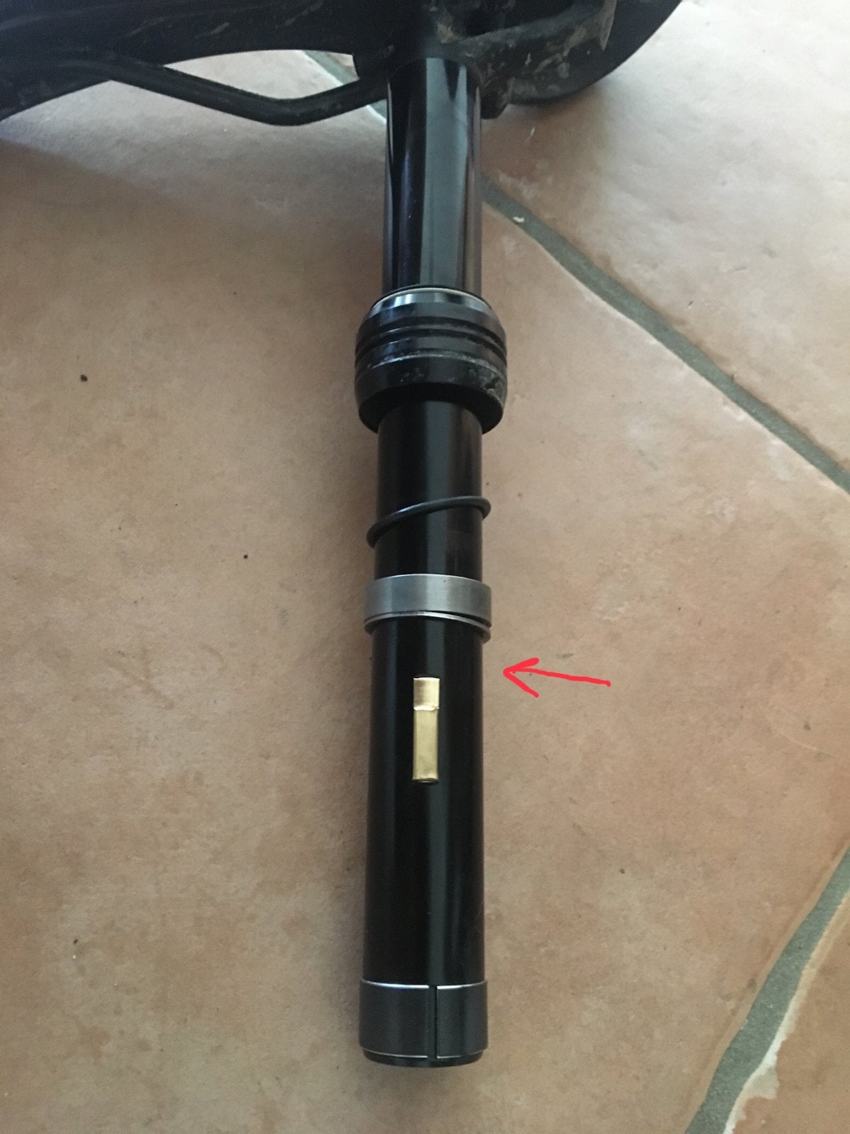

12psi I find is good for me. You can go as high as 20 and as low as 10. It just changes the speed of return.
If you run too high pressure you will damage the brass guides. Best to let it slide up the inside of your leg to slow the rate of extension to avoid brass guide damage also. I have fitted an extra o ring to act as a bump stop to alleviate brass guide damage.
You can increase the pressure in the 10-20psi range if you find it starting to get sticky. But it’s best to pull apart, clean and re grease.
Add a o ring here to stop brass guide damage as in photo.
That's an interesting idea, I might try that.
