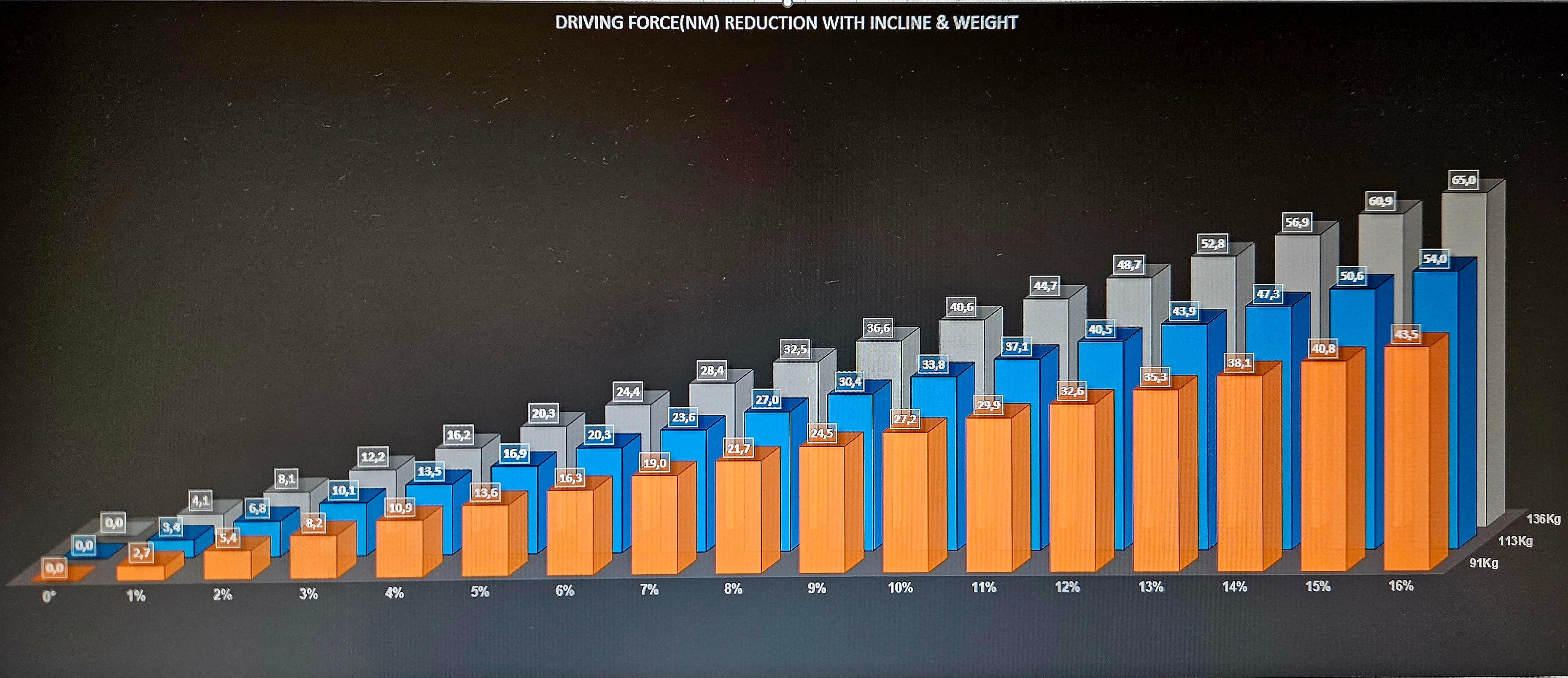

Additional for anyone interested I am also attaching a graphic presentation(my own online research) of how system(rider+bike) weight with slope incline affects driving force(Nm).
The number you see in the graph is how much motor torque you loose with weight and slope incline,
I. E. if your system weight is 113kg at an incline of 10% you loose 33,8Nm of avaliable motor torque and so on...
This could be useful, say for someone deciding between a full fat or an SL ebike.

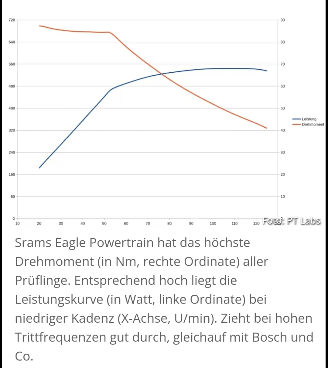

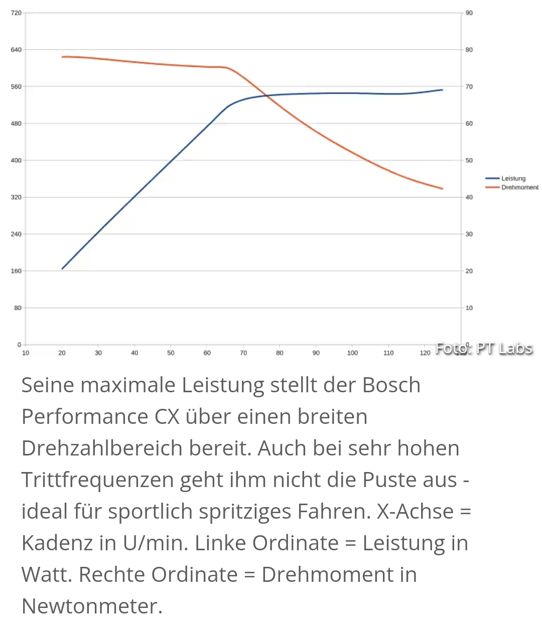

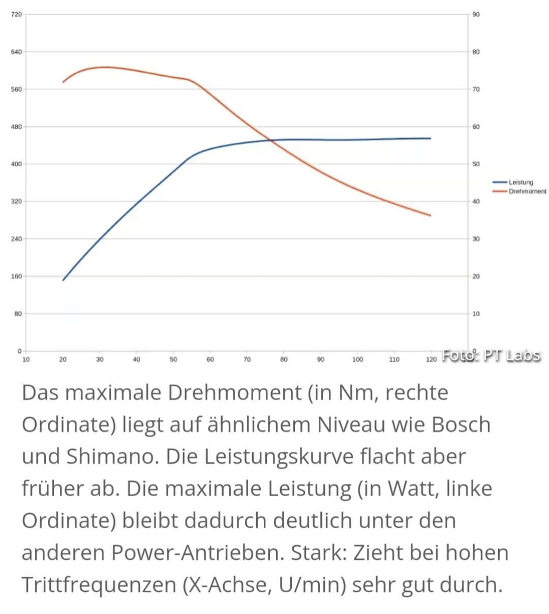

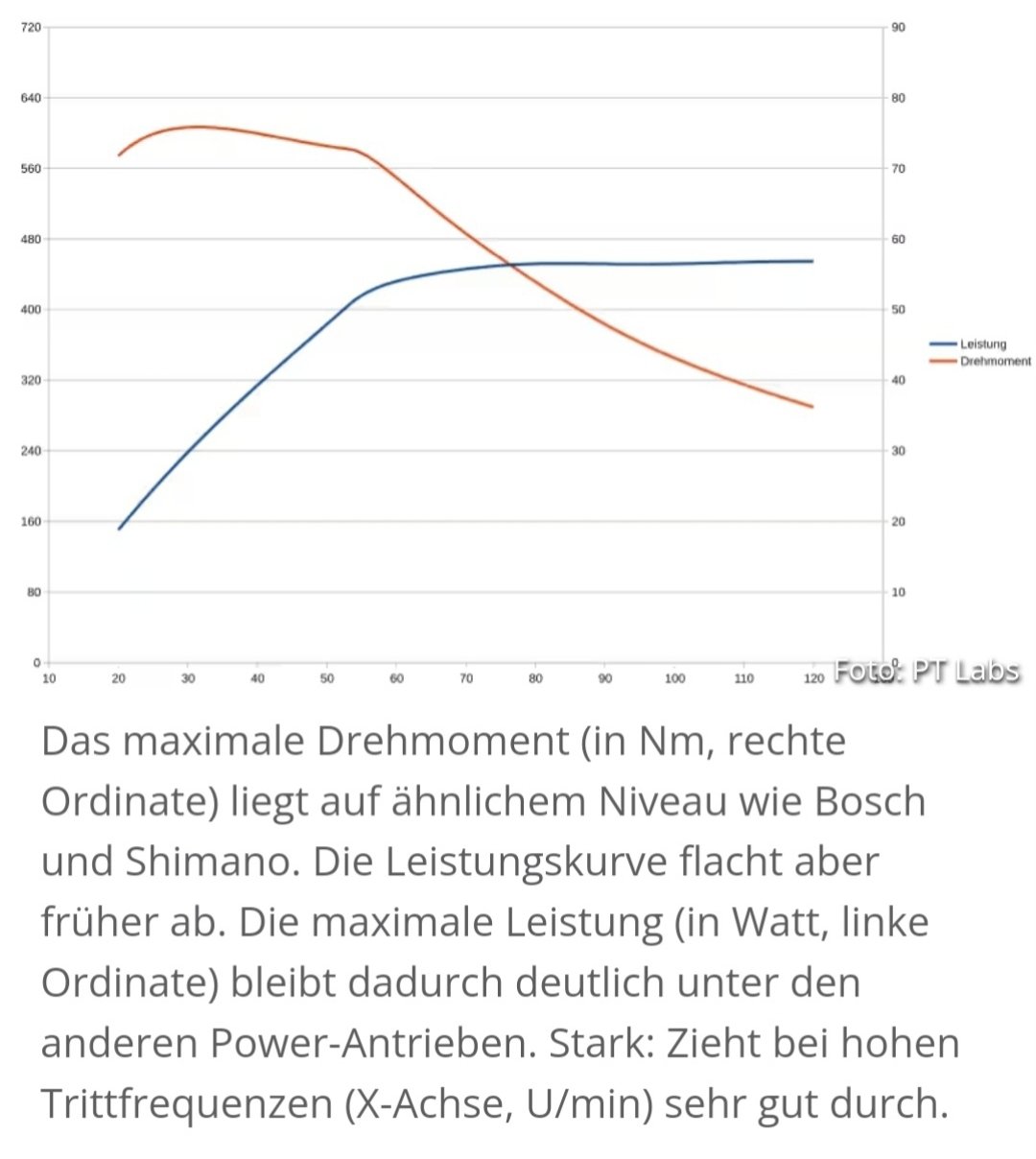

If manufacturers would include graphic presentation like this, that would be the best...here you can see a clear relationship between torque, power and cadence. Looking forward for first lab tests of the Avinox. That will tell the real picture how the motor behaves.
Orange lines is torque, blue lines is power.
You can see here that Bosch can maintain high torque up to 70rpm, Sram has a higher torque as of begin up to 55rpm then drops to Bosch levels at 70rpm, the Giant's torque starts at lower levels than both other and starts dropping further at 60rpm.
As you can see, higher the cadence > lower the torque > higher the power > higher power > higher consumption. If you can create a motor that can maintain a wide high torque/cadence window you have a winner. Interestingly the Spesh guys mentioned in their interview they also focused on the cadence/torque relationship in the development of new upcoming bikes...
Sram Eagle/Brose
Bosch Performance CX
Giant Syncdrive Pro MG
