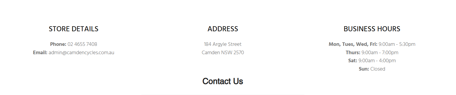

I've had a great relationship with Camden Cycles in Sydney Australia, who are a Amflow dealer. They have been nothing but exemplary with looking after bikes I have bought from them. I would expect the Amflow to be no different.
They are a Specialised and Giant dealer. I bought a Giant Talon from them. I would be extremely surprised if they would take on the Amflow dealership, if there was any chance of tarnishing their very good reputation
I have been in to talk to them about the Amflow, and they have only good things to say about the information coming out of DJI.
So whilst I appreciate your drone experience and joining this forum today to express your drone experience. Once again I will defer to the people I trust in the EMTB world. Which is people like Rob and other reputable long standing EMTB journo's. And also my local bike store like Camden Cycles, who have earned my trust through nearly 50 years of servicing the local bike industry.
That said. If you get some experience with the Amflow bike. I would love to hear it. :)
Oh BTW. The boys at Camden Cycles tell me the Amflow PL Carbon Pro 800wh is currently their best selling EMTB. With the other 2 Amflow variations coming in second and third. So I guess we'll find out quite quickly how Amflow perform as an EMTB manufacturer.
Over what time period? Have they physically touched an Amflow bike yet?
Every LBS I’ve spoken to about Amflow has admitted it’s a gamble, but doesn’t want to miss out on sales if it turns out as good as the hype, suspect your LBS is the same.
Go buy one and report back in a few months if it’s broken and how good the warranty is.

That is something that is fantasic and not in any doubt. Zero.
However you said they have had good things coming out of DJI. That's to be expected. DJI are not going to be saying bad things or being difficult right now. However the fact is no one in this industry has long term dealing with DJI really yet so yes they may be hearing good things but that don't change the fact of how they are as a company and have been for the last 14 years.
Rather than speculating. As we want to give this forum the most accurate data. Why don't you call them or email them, and they can answer any issues you have ?
As an expert on DJI. You should be able to ask the right questions, to satisfy your concerns. Then post a full report of factual responses direct from an Amflow Dealer.
I look forward to your report, as I am very interested in these bikes. :)

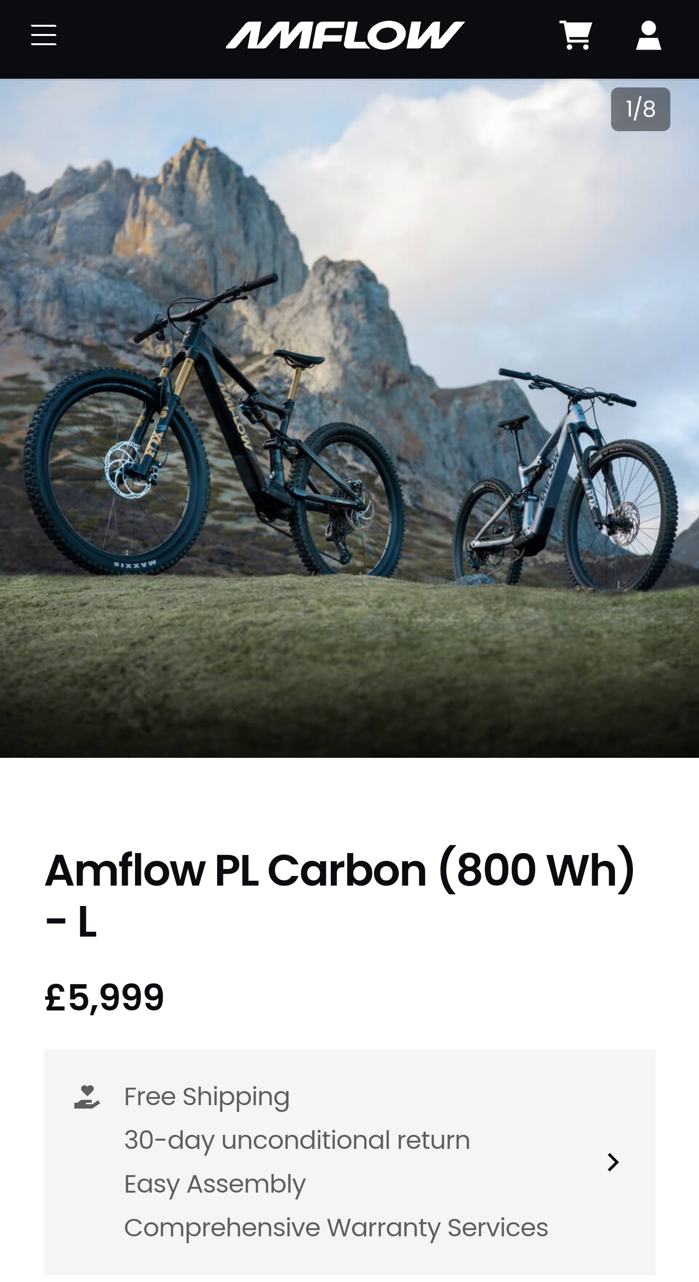

The Amflow starts at AUD$9,400. That's only £4785. For a light weight carbon bike with high spec components, it's very well priced, and this is mainly due to our good trading relationship with China.
We are experiencing the same benefits in Electric Vehicle pricing. So whilst I'm cautious about China. I enjoy the benefits of our close relationship.

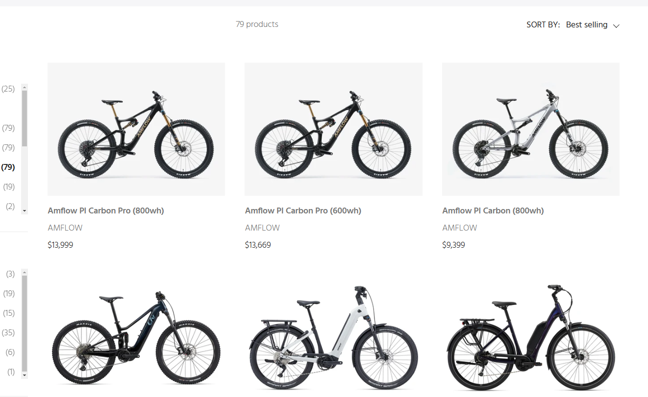

I'm just reporting what they have told me. You can confirm this by going to their website and sorting on their best selling bikes.
Here ...... I'll do it for you.
Do it yourself if you wish.
Regarding purchasing one. My EMTB is only 6 months old. So there is no need for me to rush in. I'm sitting back and waiting for the many sold to be reported on from actual Amflow owners. We are getting reports in this thread, and not just Rob's, Will's and Steve Jones. But from everyday people. So I'll wait.
Regarding being a gamble. These guys have one of the best reputations in the region, selling Santa Cruz, Scott, Specialized and Giant. They are not a big chain, and prices reflect their personal service and reputation. I don't see them gambling. But sure ........ I could be wrong.

I wish the black Pro was £5999! 😂
I had the email as well, I suppose like everybody who registered interest, but I’m going to change the habit of a lifetime and wait for a test ride and some more long term reviews.
I was also out on my 70Nm Shimano E8000 yesterday, made me wonder why I needed more power to be honest!
Definitely won’t get fitter with 110Nm…
Damn it, why do I still want one?! 😂
