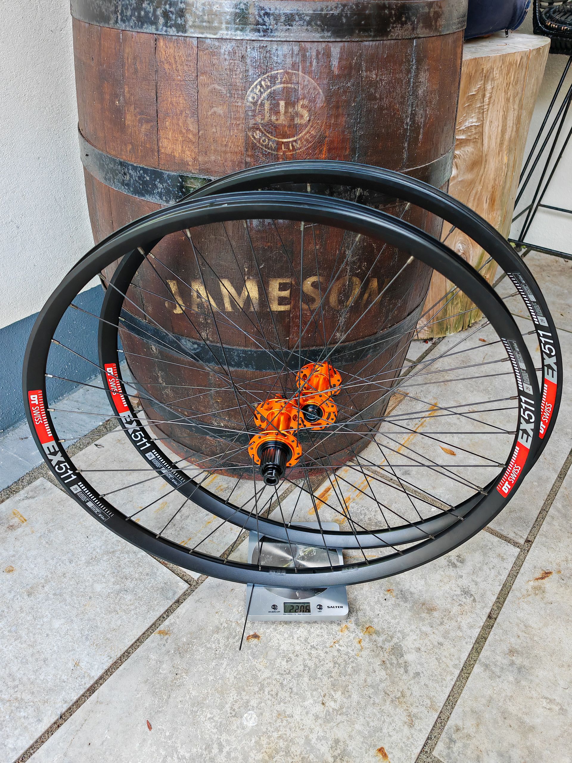

Yes, yes.... I have made another set of wheels. This time something strong for heavy duty use. Long story short:

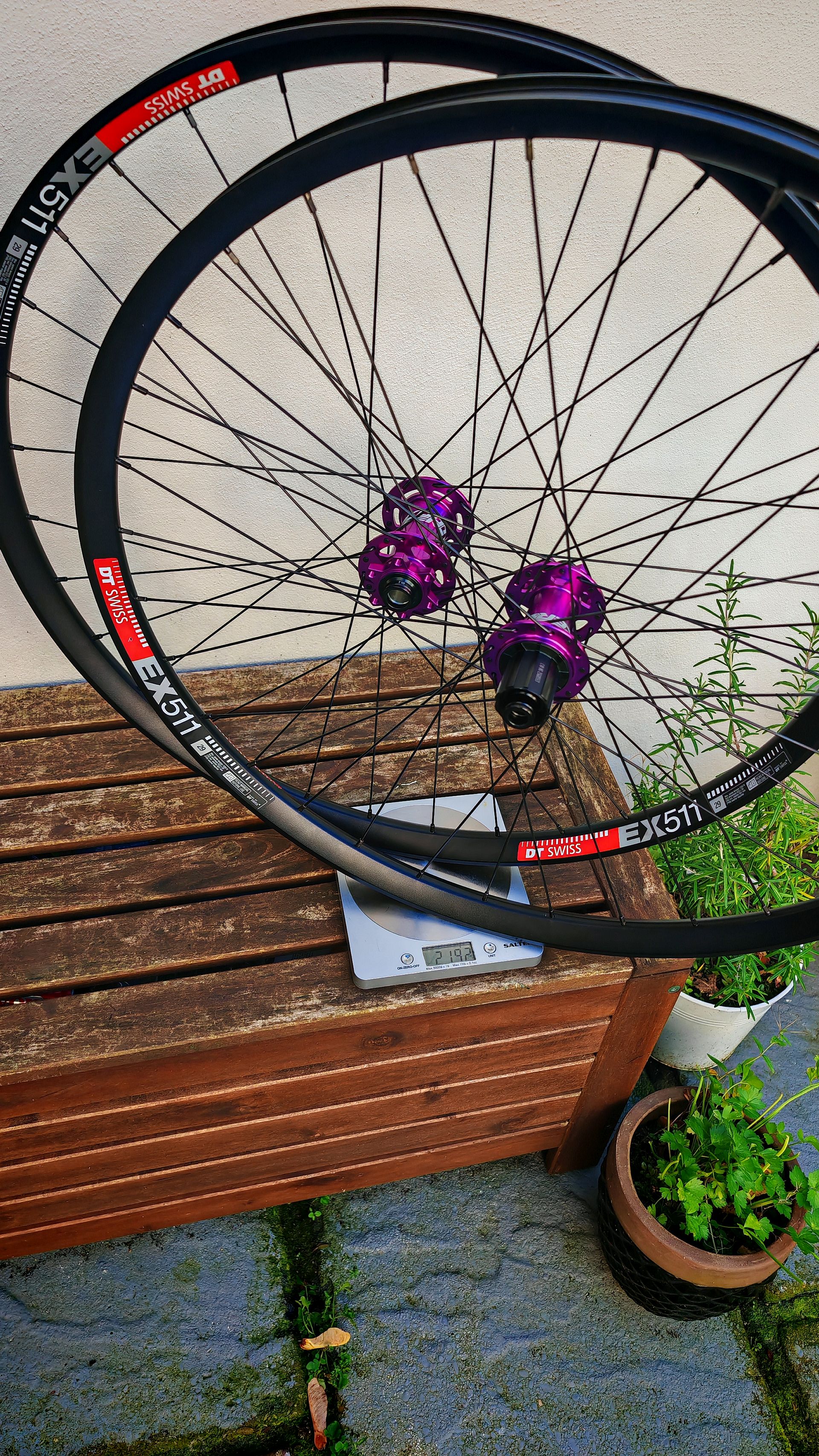

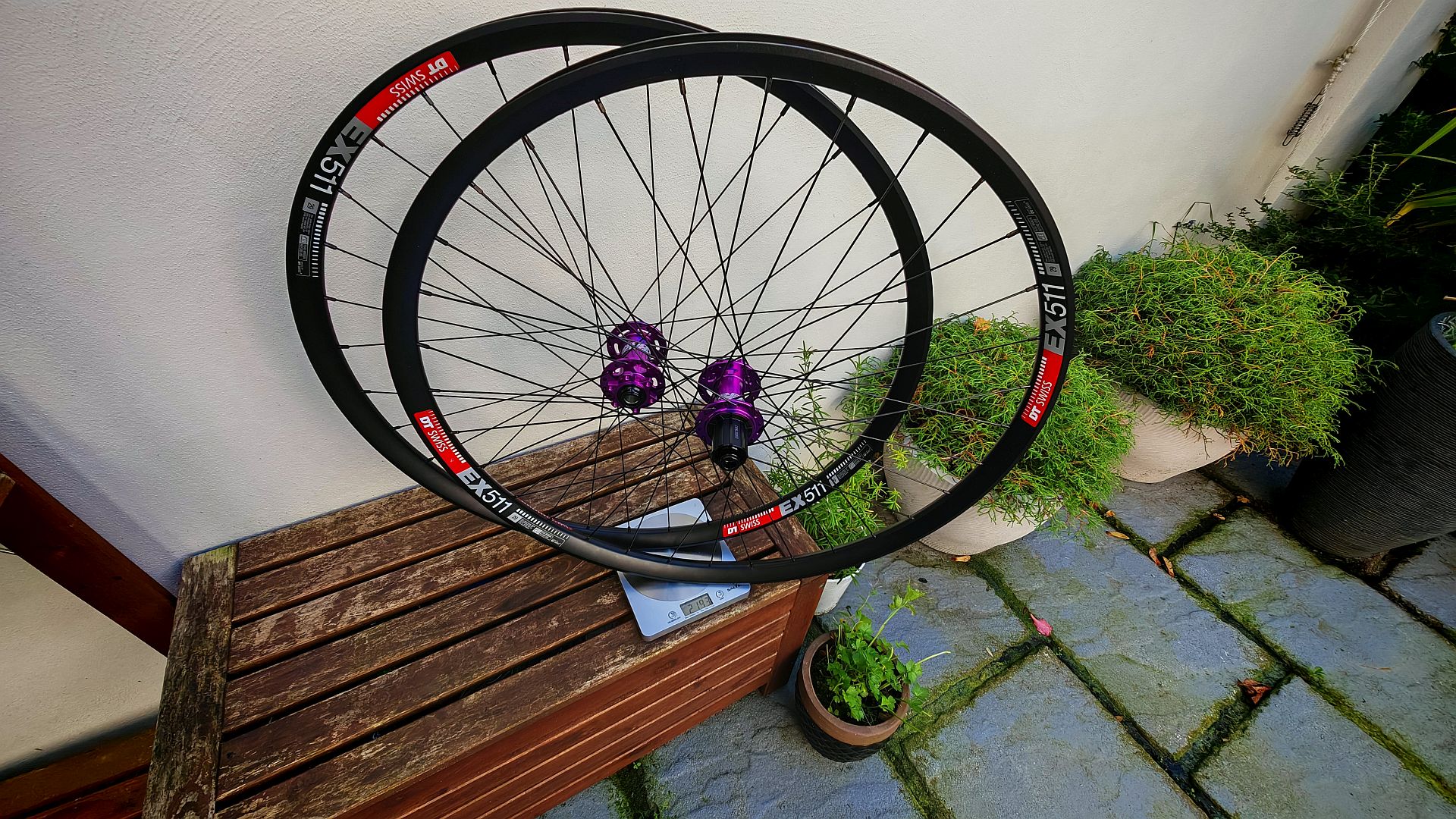

A few pix from lacing procedure:

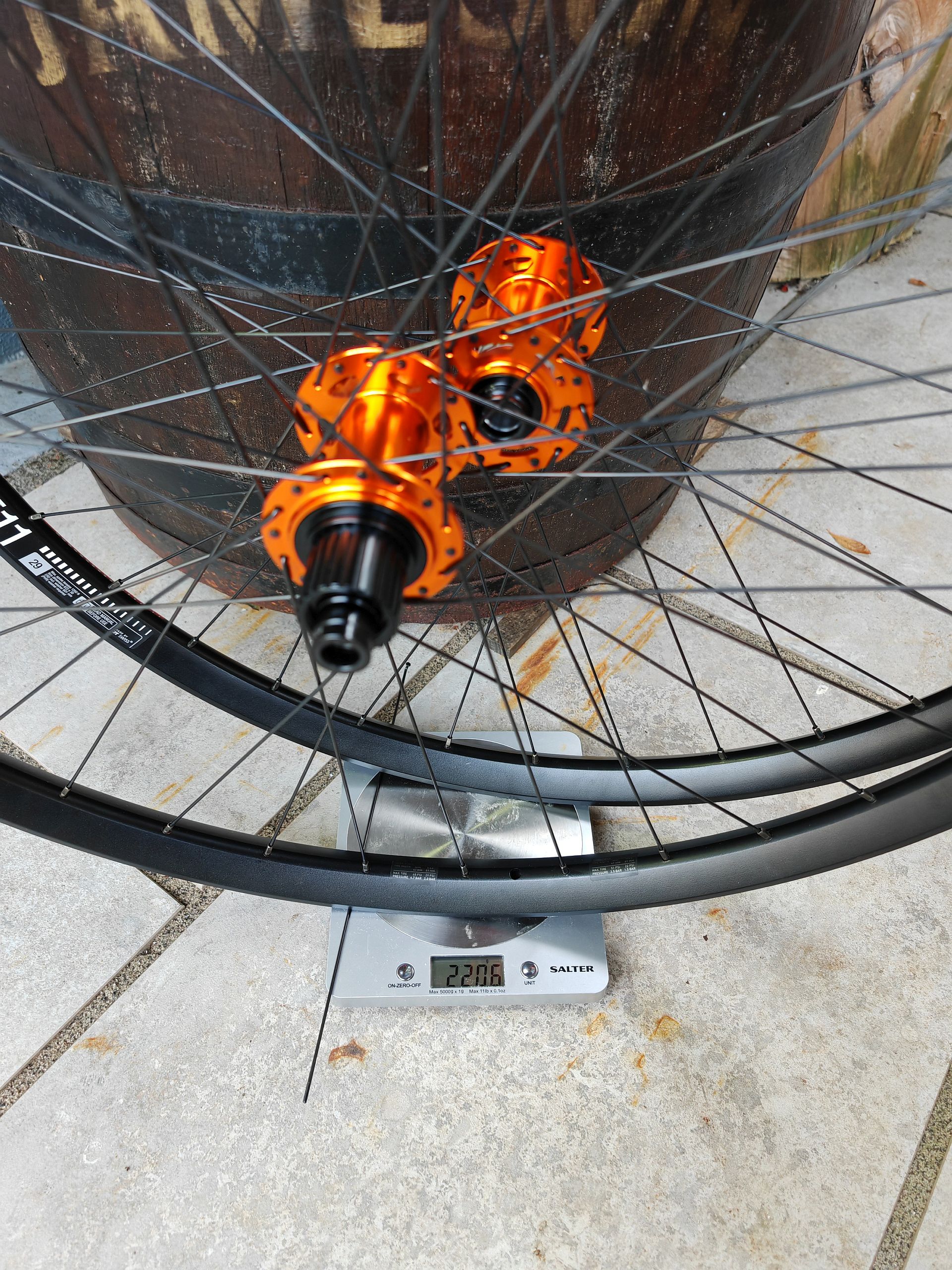

Good news is that wheel-set is lighter than a barrel of Jameson but it weights a hefty 2,2kG.

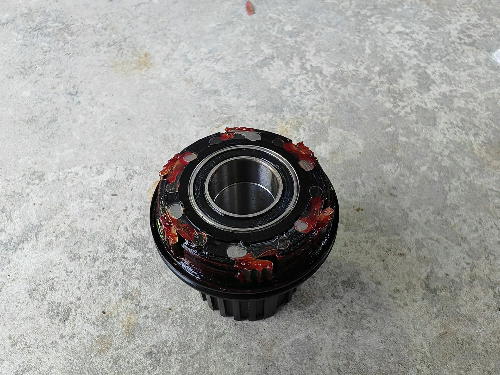

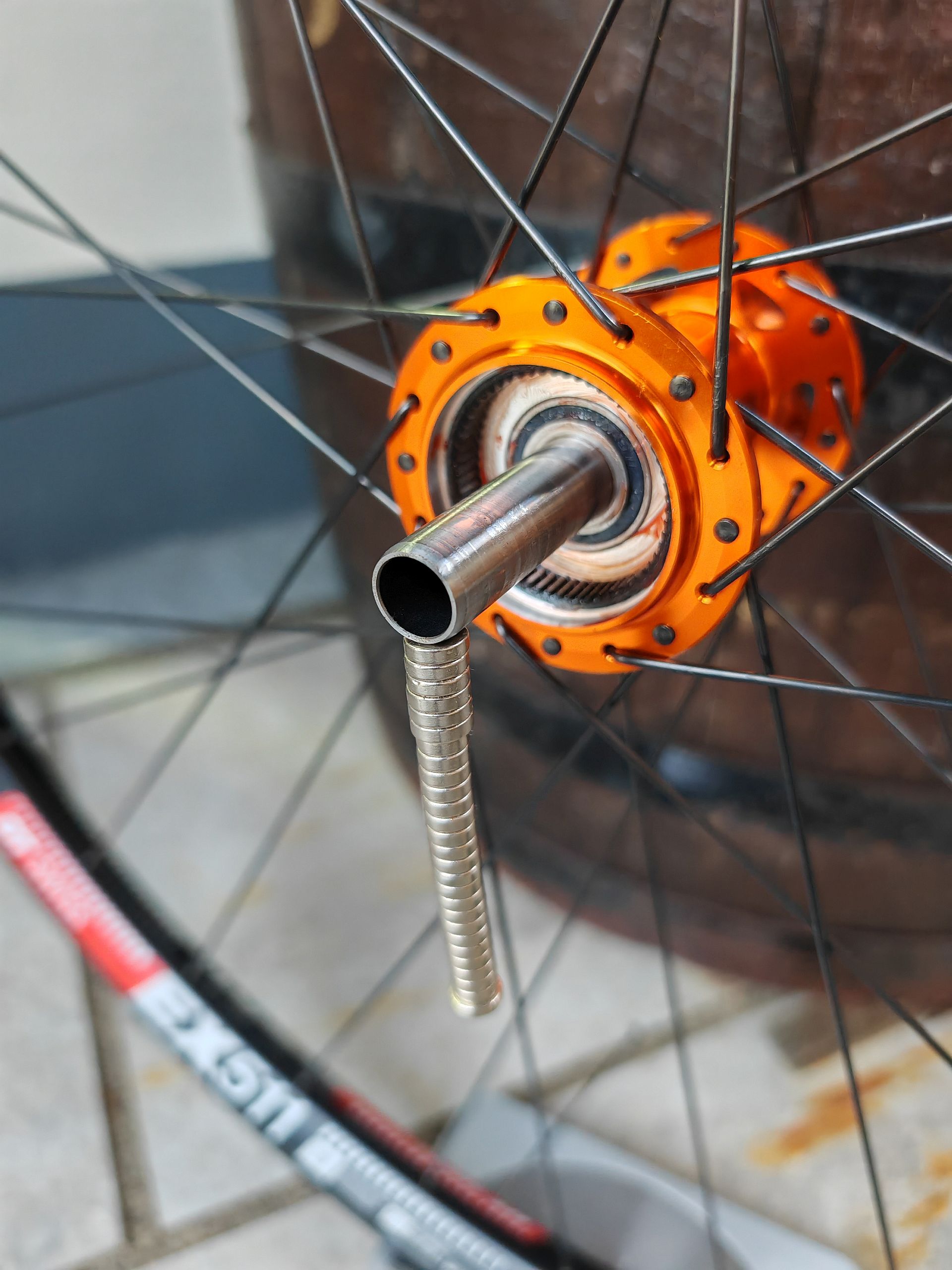

The rear hub looks promising, steel axle, double row (wide) bearing in freehub body, 3 tooth pawls. Hope all of that will last for a good bit under a heavy rider on heavy e-bike. IMG_20240910_192759.jpg

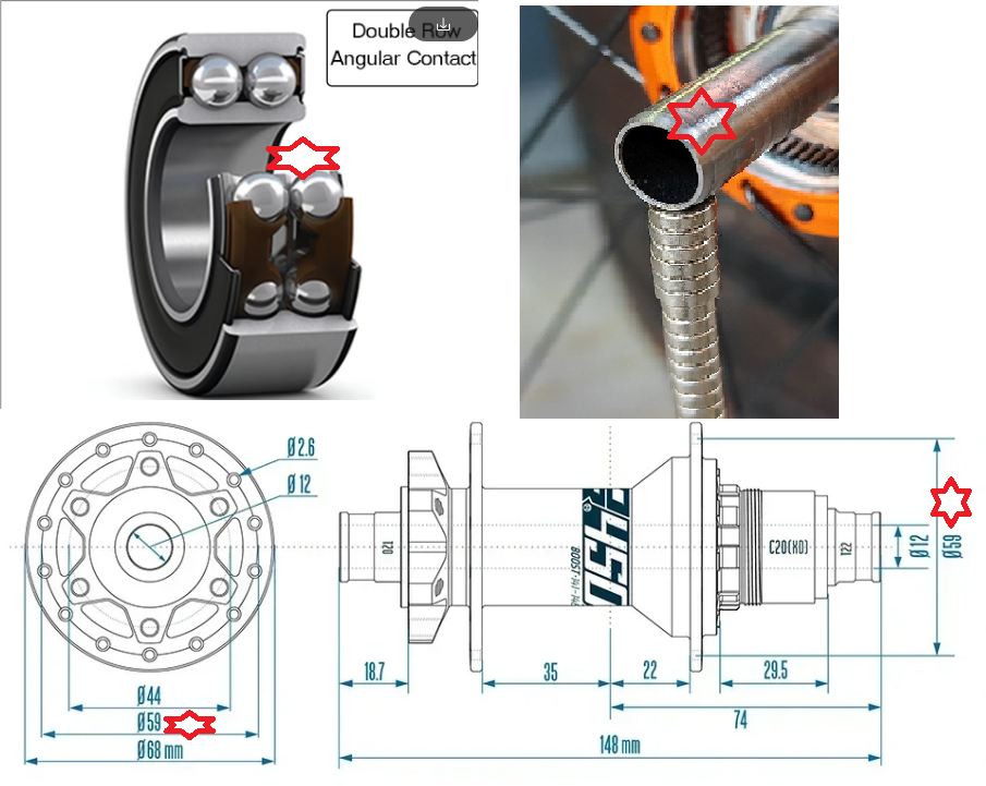

What made you choose that specific hub from Koozer? Many people on these forums have bought wheels with xm490 pro hubs and been very happy with them.

I have marked a few stars on the picture.
Bigger flange diameter will form a stronger triangle = stronger wheel.
Freehub inner bearing is always first to go in my case, so double row bearing should make thinks easier.
Steel axle also will be stronger.
120POE (points of engagement)
I am only not sure about one thing, how well is the hub sealed up. In Ireland I can not complain about lack of water :D so we will see.
450 hubs are released a few months ago and are a newer construction than 490pro.
After bit of thinking, as a rear rim, FR541 could be better/stronger.
I weighted EX511 rims and there are 612g each, roughly the same as FR541.

Thanks for the detailed answer!
The xm490 pro boost hub also has the same CrMo steel axle! They both have it in the rear.
Looking forward to hear your experience with these hubs!
