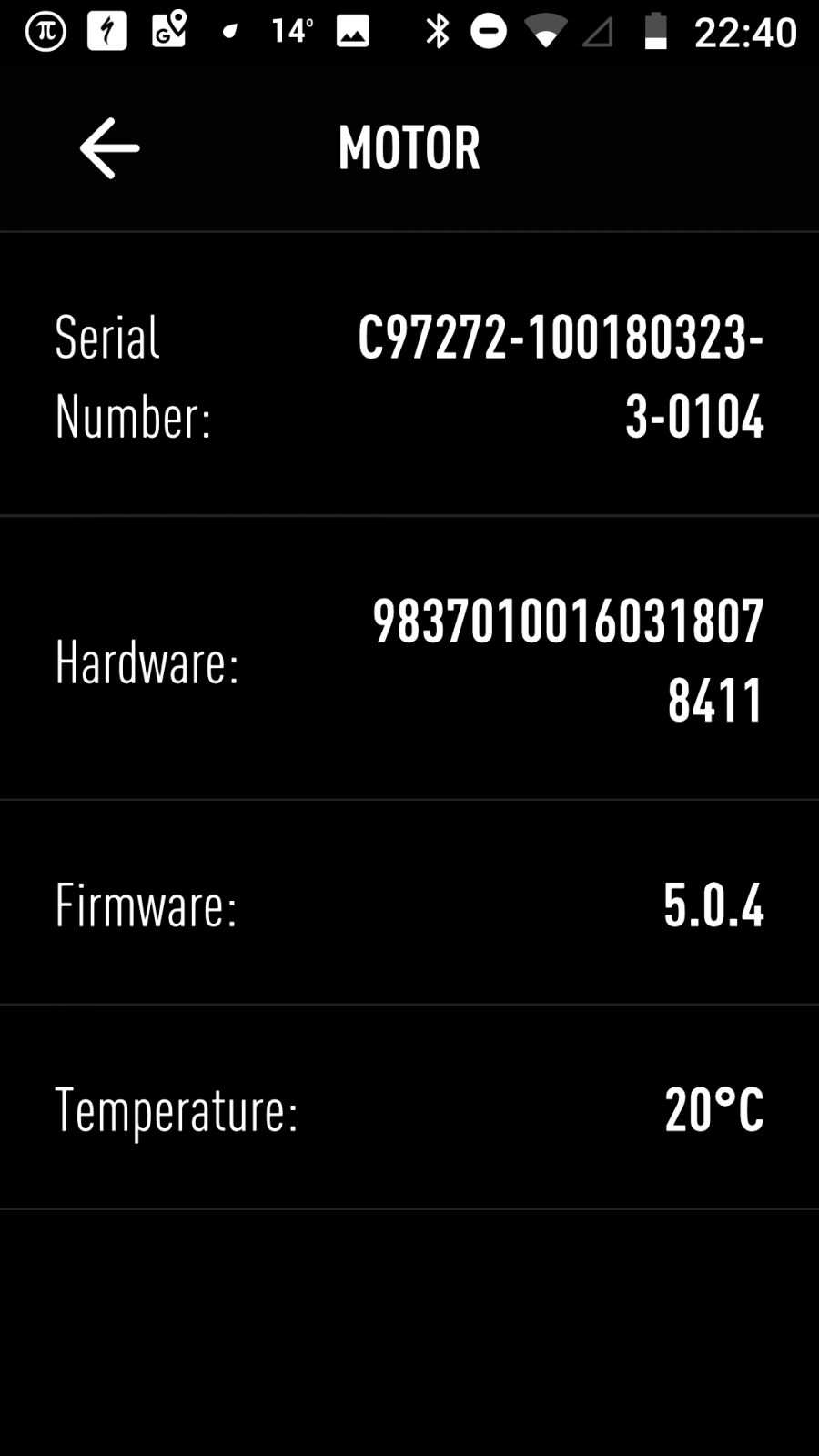

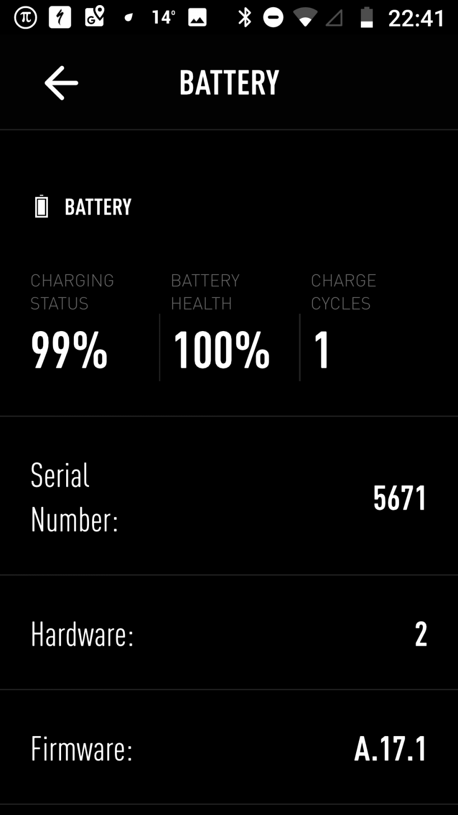

Ok .. so the bike is together .. battery charged .. still need to do a full check over tomorrow, but I did ride it several meters and IT WORKS ! Mission Control connected easily first time.. nice ..
It's a beast - or it looks it anyway ! Menacing !!!
@Specialized Rider Care can you confirm if the firmware is uptodate or not ? many thanks.

You have a Turbo 1.3(should peak at 800watt) motor and it's up to date, your battery is also updated. As mentioned above you should see 20amp on turbo with this motor.

Great news !!!! :) I really expected it to come with year old firmware .. that's a result .. thanks for that :)
