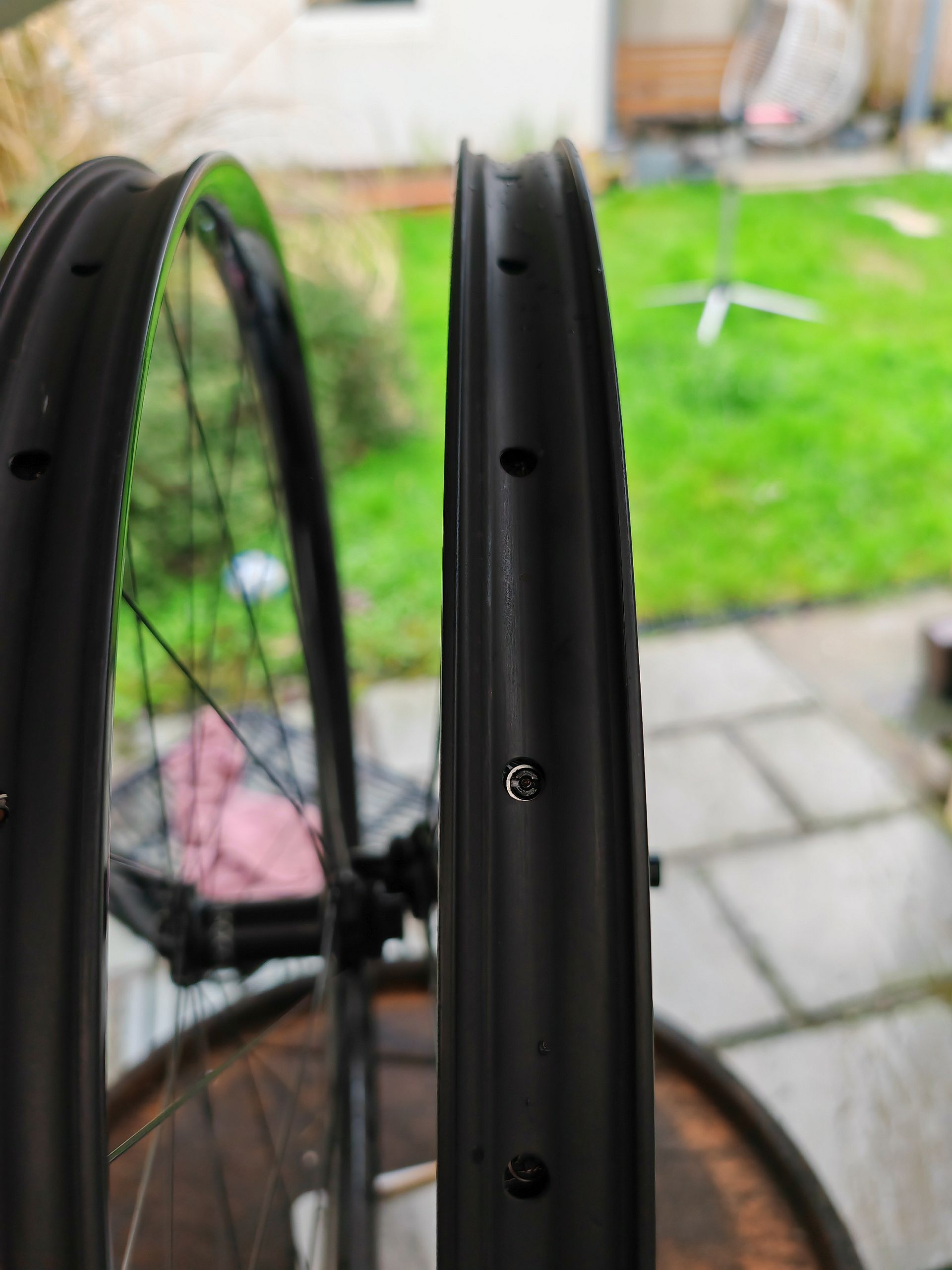

This time I decided to try 29" carbon rims. Bought pair of shallow BTLOS M-i30AS rims. Rims are in enduro version (a bit heavier than XC and AM finish). To make long story short, all the details bellow.
BOM:
-2x BTLOS M-i30AS carbon rims (enduro version)
-set of ZTTO M1 hubs
-60pcs D-light sapim spokes - all 306mm long
-one pack (70pcs) of Newmen MG washers
-60 bras Sapim nipples

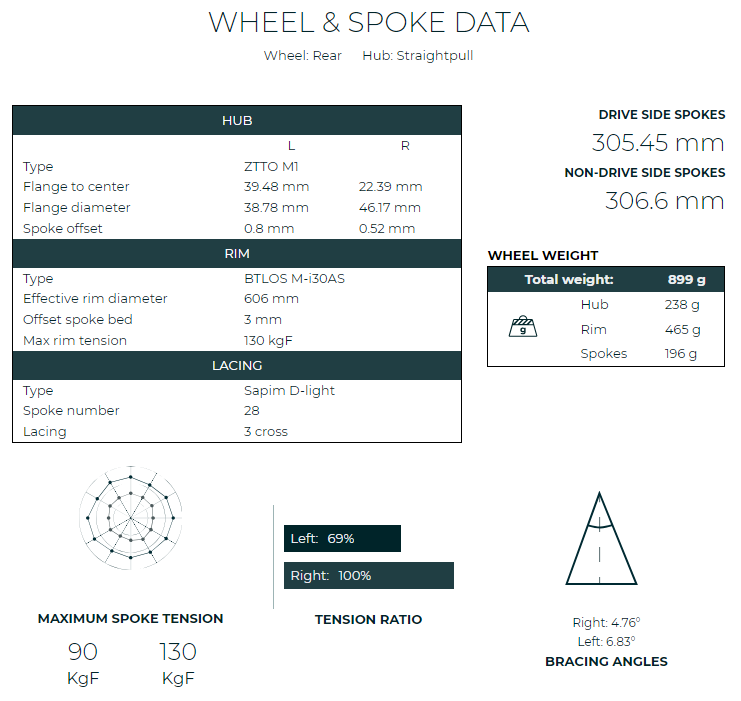

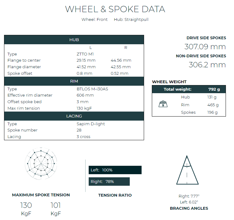

At first bit of the math. Rim ERD is 602mm but we have to add 4mm to it (2x MG washer) to make calculations right.
Front wheel.
Rear wheel.
I have ordered all spokes 306mm long. Now the fun part, lacing the wheels.

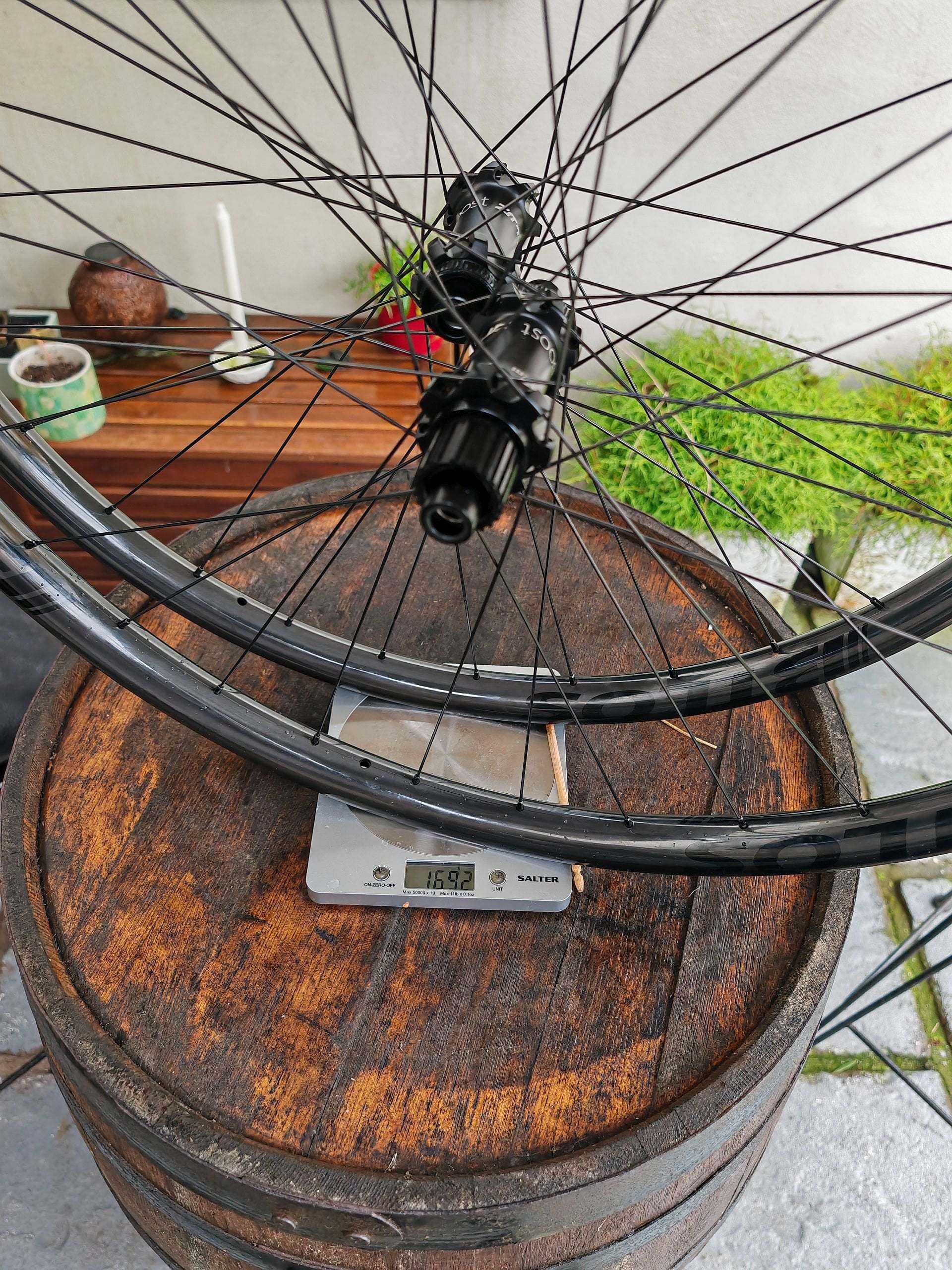

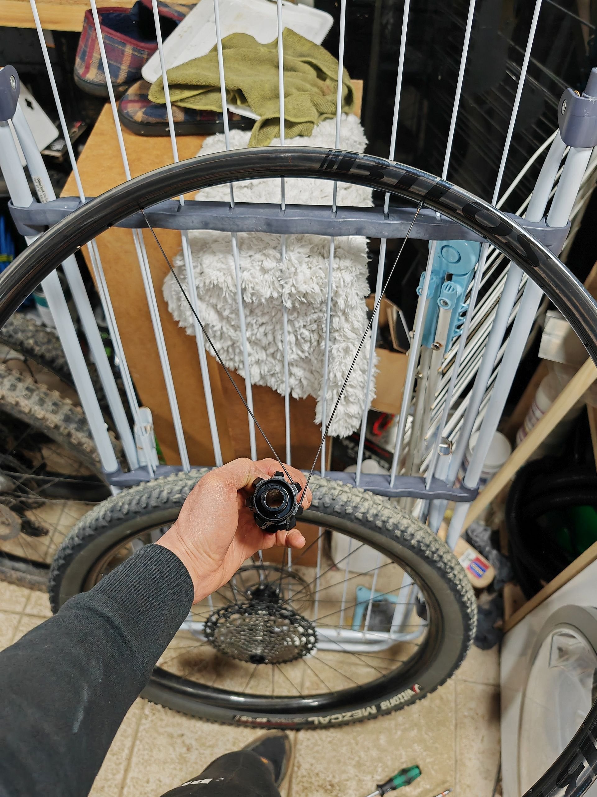

Lacing straight pull hubs is extremely easy, took about 20 minutes a wheel. Truing process next 30 minutes a wheel.

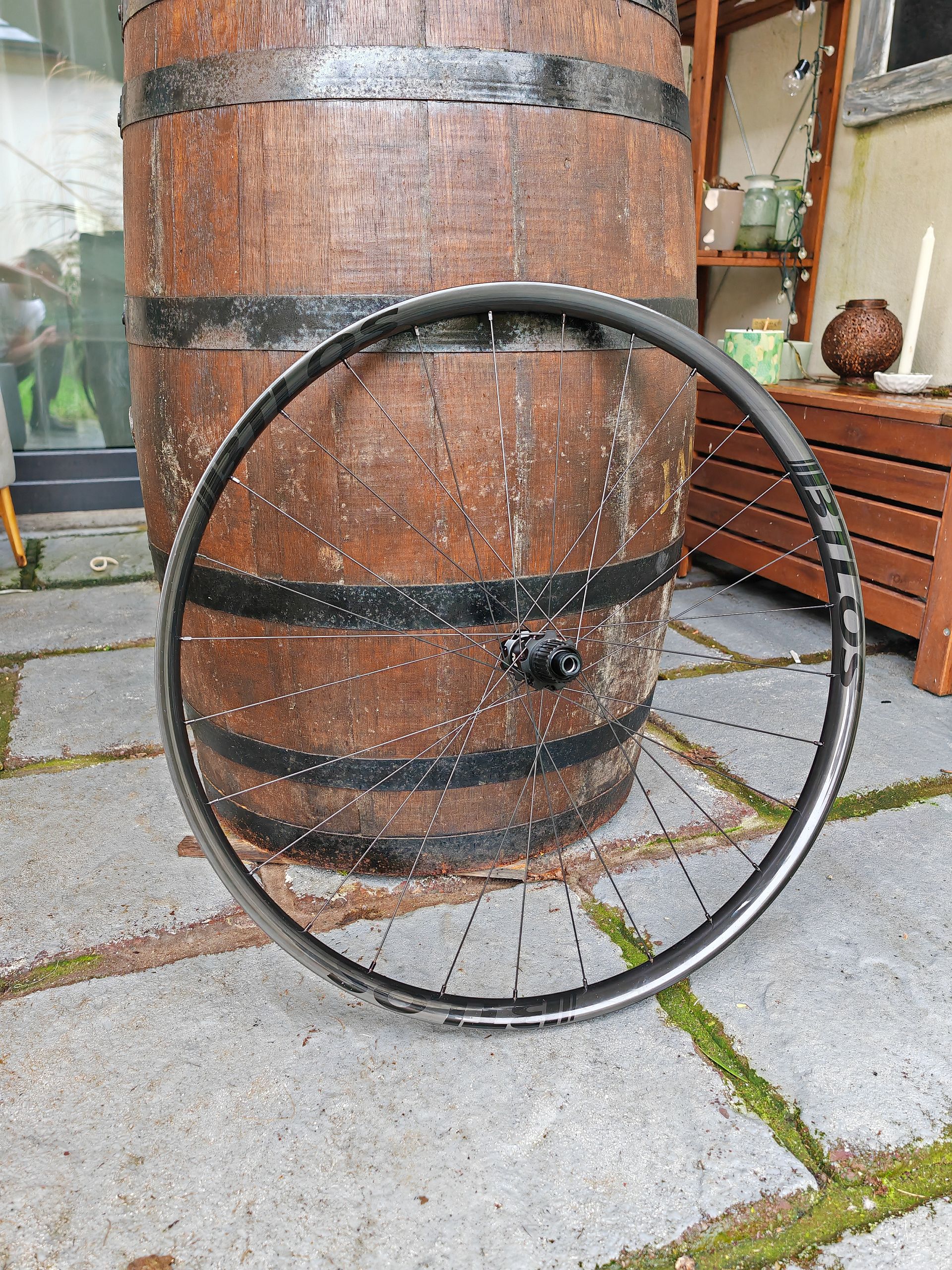

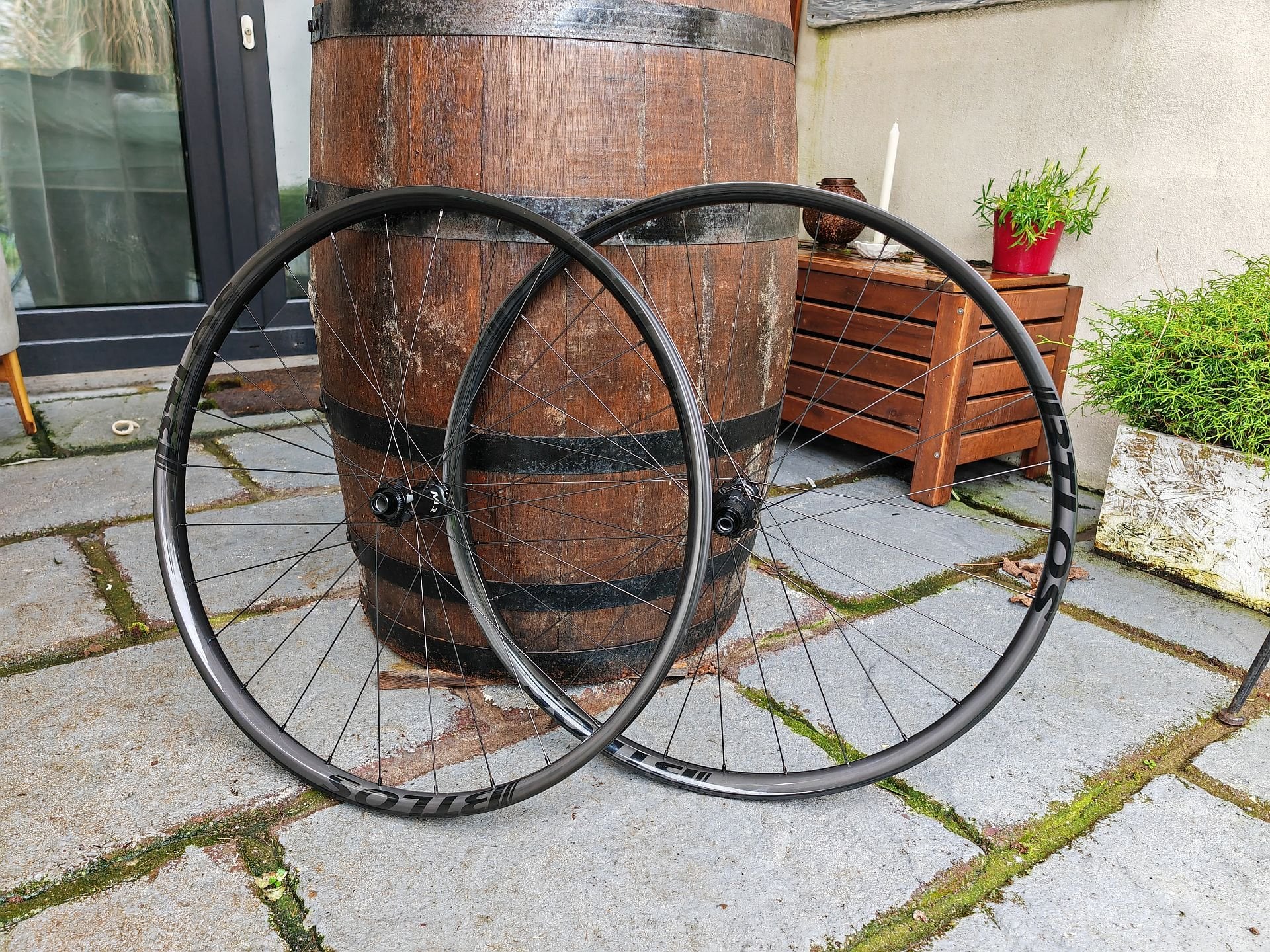

Final result bellow.
IMG_20240316_103450.jpg IMG_20240316_103558.jpg IMG_20240316_103853.jpg IMG_20240316_103931.jpg
Weight of the ready to go enduro wheels ended up at about 1690 grams.
The costs:
Rims 422Eur
Spokes + nipples 80Eur
MG washers 7Eur
Set of M1 hubs 80Eur
Total 589Eur
The wheelset could be a bit lighter, using aluminium nipples, rims in XC or AM finish could result in about 1500 grams. The weight is not the priority for me. Stronger enduro wheels are more preferable.
I have build similar wheels with Newmen SL30 rims some time ago:
Now, the question is, is it worth of spending extra money on carbon rims ? Simply I do not know, but I am going to find out.....
First ride in next few days.

I think I can see it’s the centerlock version, so ratchet version?
I have a 6 bolt with 6 pawl version and one pawl failed after 500km… they sent me a new one under warranty but I have no idea how to lace new wheels!
I’d like to give it a try but the spokes lenght calculation is still not clear for me :D

Yes, I have used this time ratchet version. Previously with ''alloy build'' wheels I have used 6-bolt pawl version.
M1 hub with pawl's done about 800km no problem. Opened just once after about 500km for inspection, cleaned + regreased.
Spoke calculation is easy - just putt the values into the calculator. Lacing the wheels is easy too, do 7 spokes on one side, swap sides, do another 7 spokes, turn it over do another 7 than turn it over last time and last 7 spokes.

Hi, Any updates on the wheels? thinking of getting the same wheels with the bitex hubs. Is this the gloss UD version?
I am smashing them every weekend. All OK. The only thing I would consider in my case is the rear spokes. I weight about 100km geared up. There is a bit of lateral flex which I like but if I will put 2.6'' tire on the back, it starts to rub on the back swing arm. Must say that I am agrresive rider. So in my case i stay with 2,4'' tire on the back. With 1.8mm gauge spokes the rear wheel might be a bit stiffer but less complient.
I have gloss version. You can order the rims in all mountain and Enduro finish, my ones are heavier Enduro.

Thankyou for the update. I’m 88kg kitted, and thinking of going with d-light spokes. Think you may have persuaded me to get these over alloy rims!

The alloy rim wheels with newmen a30 sl rims are also a good option (about the same weight) Light and strong, done about 1800km on my lce930.
Regardles ztto m1 hub, had to replace bearings in freehub body after about 1500km. Other than that all OK.
