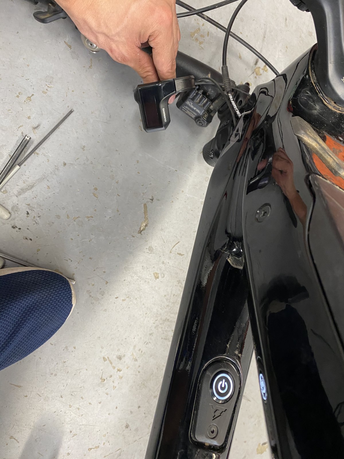

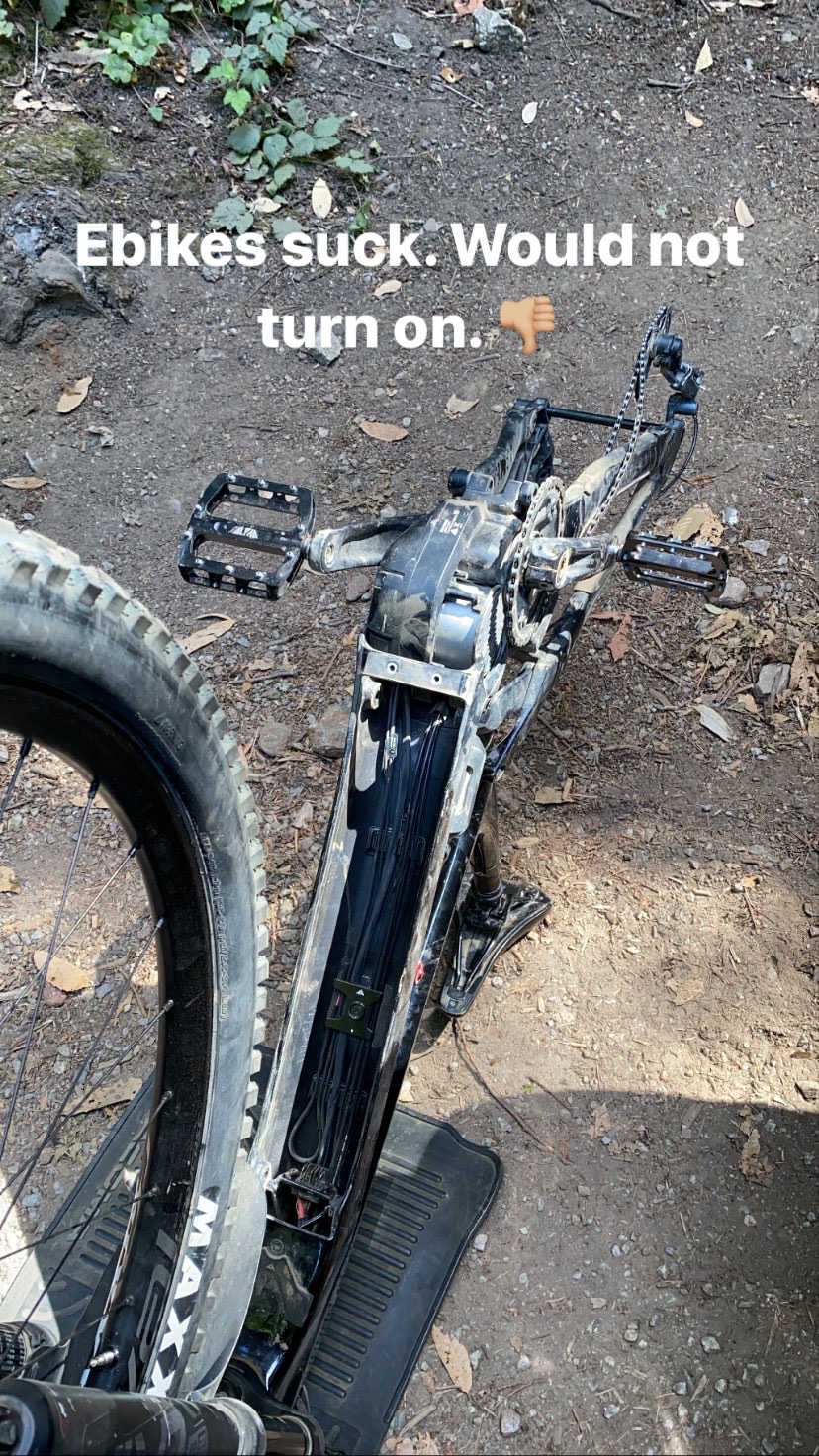

Today I tried to ride my decoy and it wouldn’t get out of the parking lot. Rode it a few days ago and everything seemed normal. Charged up normal. When I turned it on before my ride everything booted up normal. Then as soon as I was switching it into eco mode to take off, the screen went black and never turned back on. Took out the battery and motor and all connections seemed to be intact, dry, and clean. The light on the power switch is on, but nothing else seems to work. Will dive in a little further tonight, but was hoping someone on here would have some suggestions?

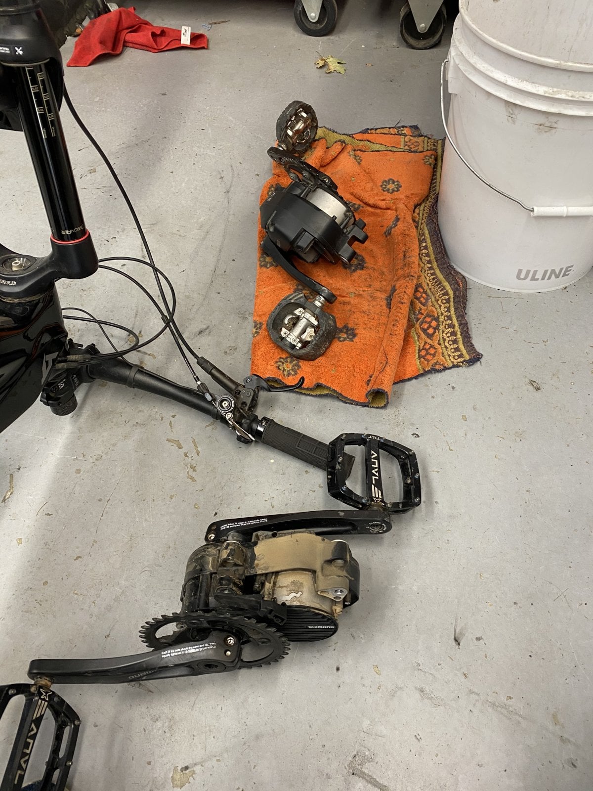

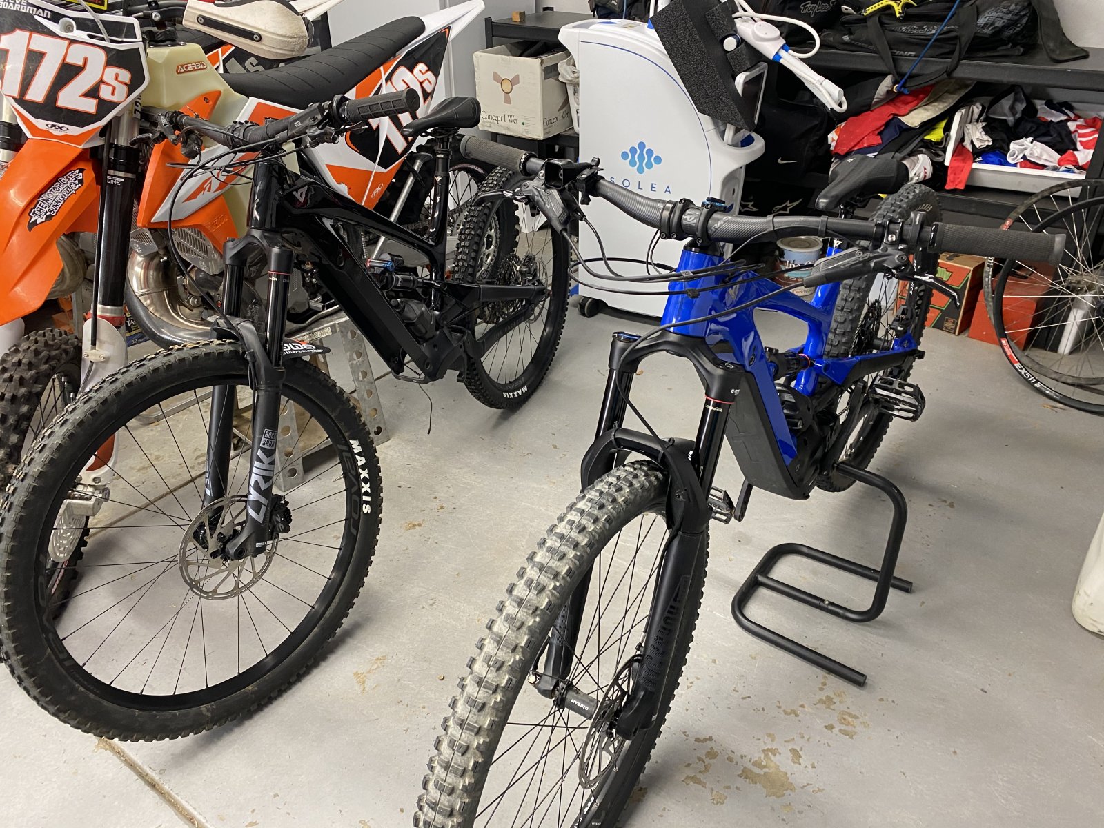

Took everything apart and could not detect any source of error. My friend also has a decoy 29 so hopefully I can borrow his and swap parts out 1 at a time to figure out what is wrong. Hoping the display cable went bad or something, but we shall see. Thank god I have a normal (2020 Enduro) bike to ride in case this isn’t a quick fix.

Are you sure that the cable wasn't just loose into the display/motor? Need a positive click when you push it in - sometimes not done when first assembled

Without a Bluetooth connection, I do not think it is possible to connect to the shimano app. To be fair I did not try, but assumed if the display is off, the Bluetooth is also off. Will try again once I get the bike back together.
No light being used on my bike.
yes, connections are clean and “snap” into place securely. No change in function.

Got another decoy. By the end of the day I will have either diagnosed the problem, or will have 2 broken decoys in my garage. Wish me luck.

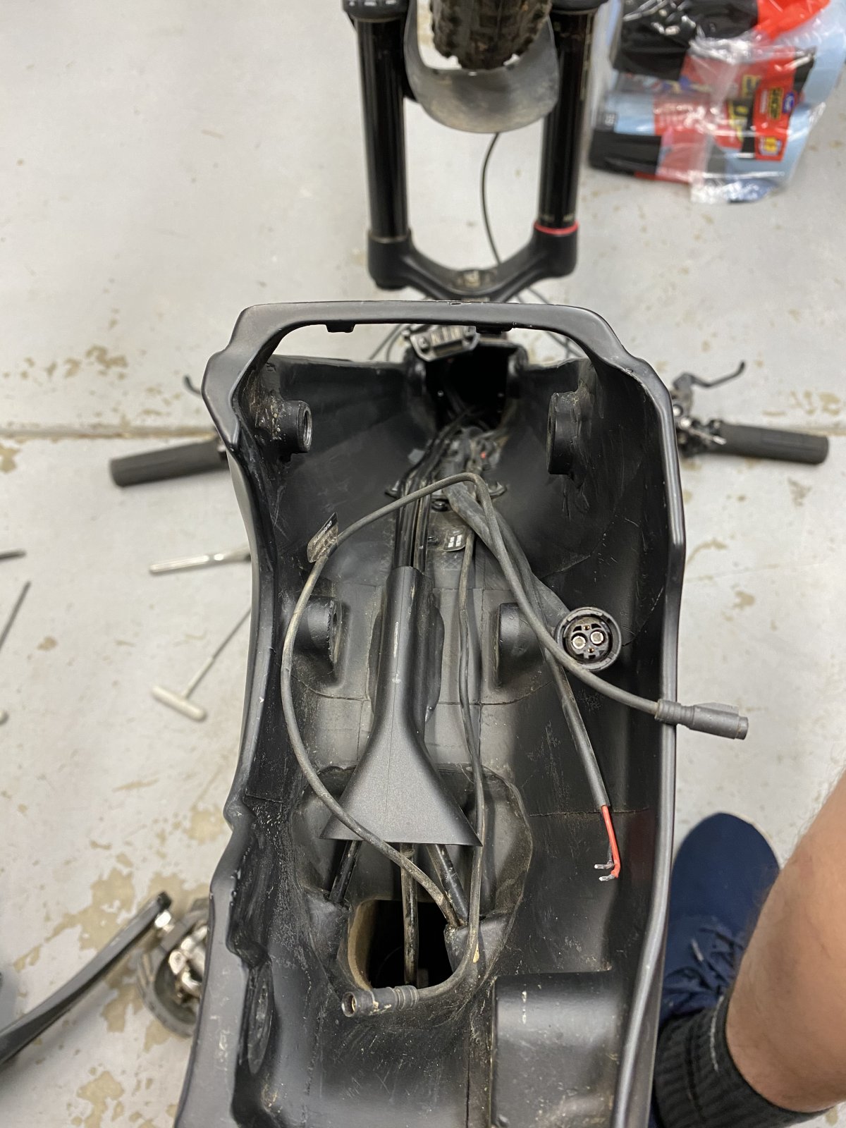

Hi RB, sorry to read about your issue with the display is this a common issue? I'd like to thank you however for the great images they really help a Decoy newbie with understanding the both cable routing and engine removal. One question are you running a light as i notice the Red and Black cable?
Thanks Again
Sven ?

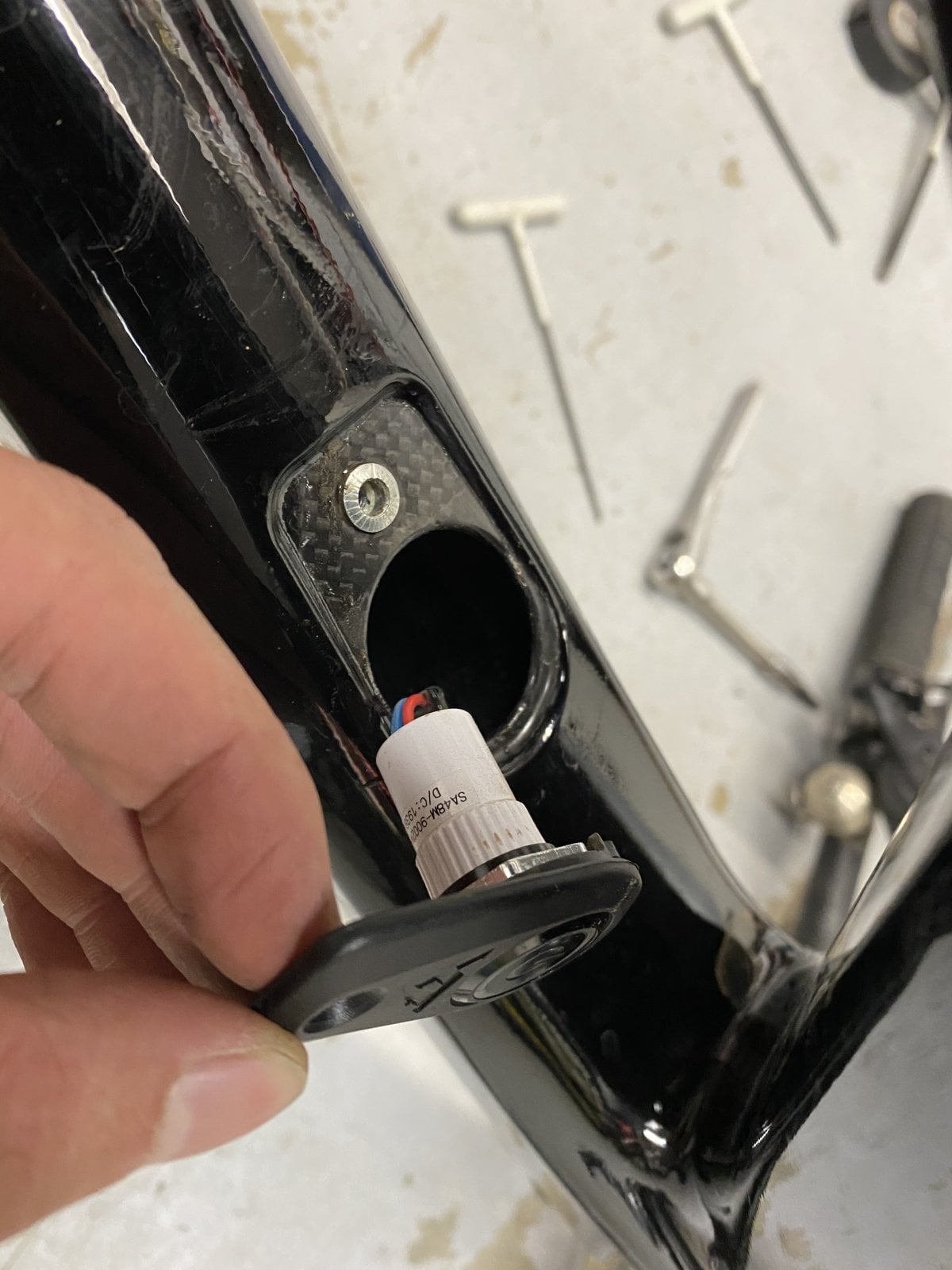

This is the one you were talking about? Is this supposed to be for a light? Wasn’t connected to anything so it’s coming out.

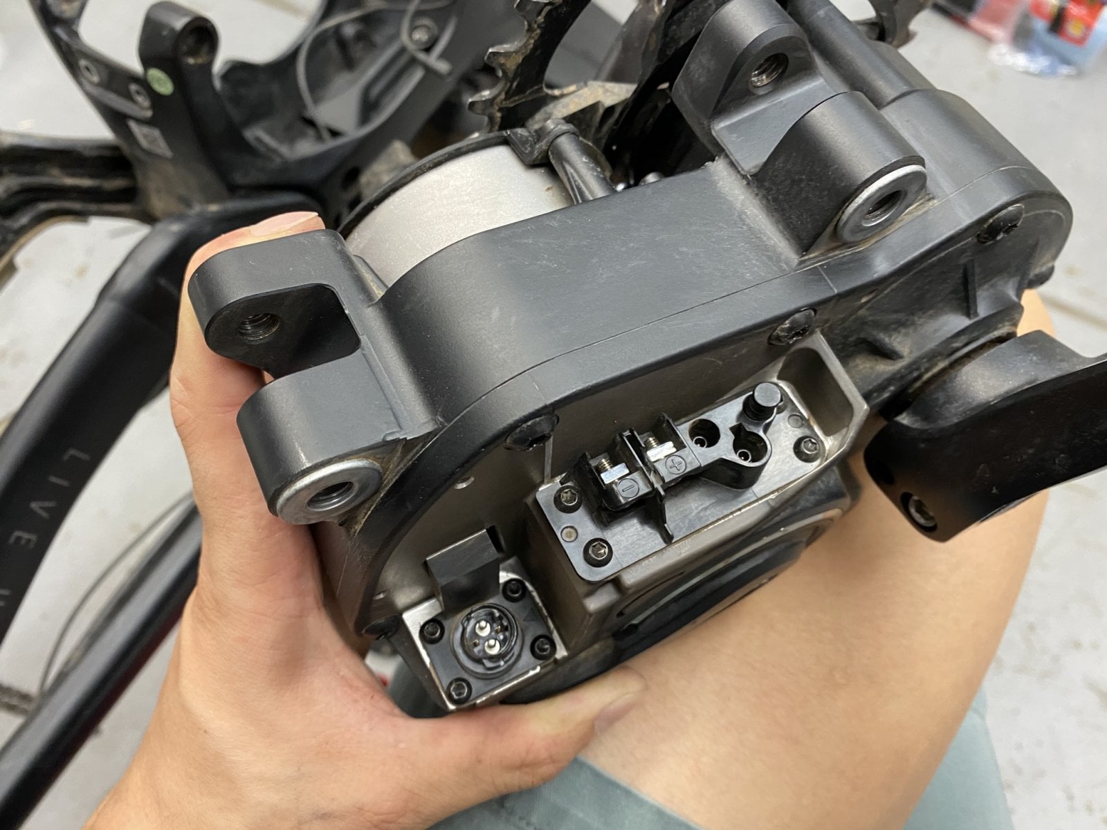

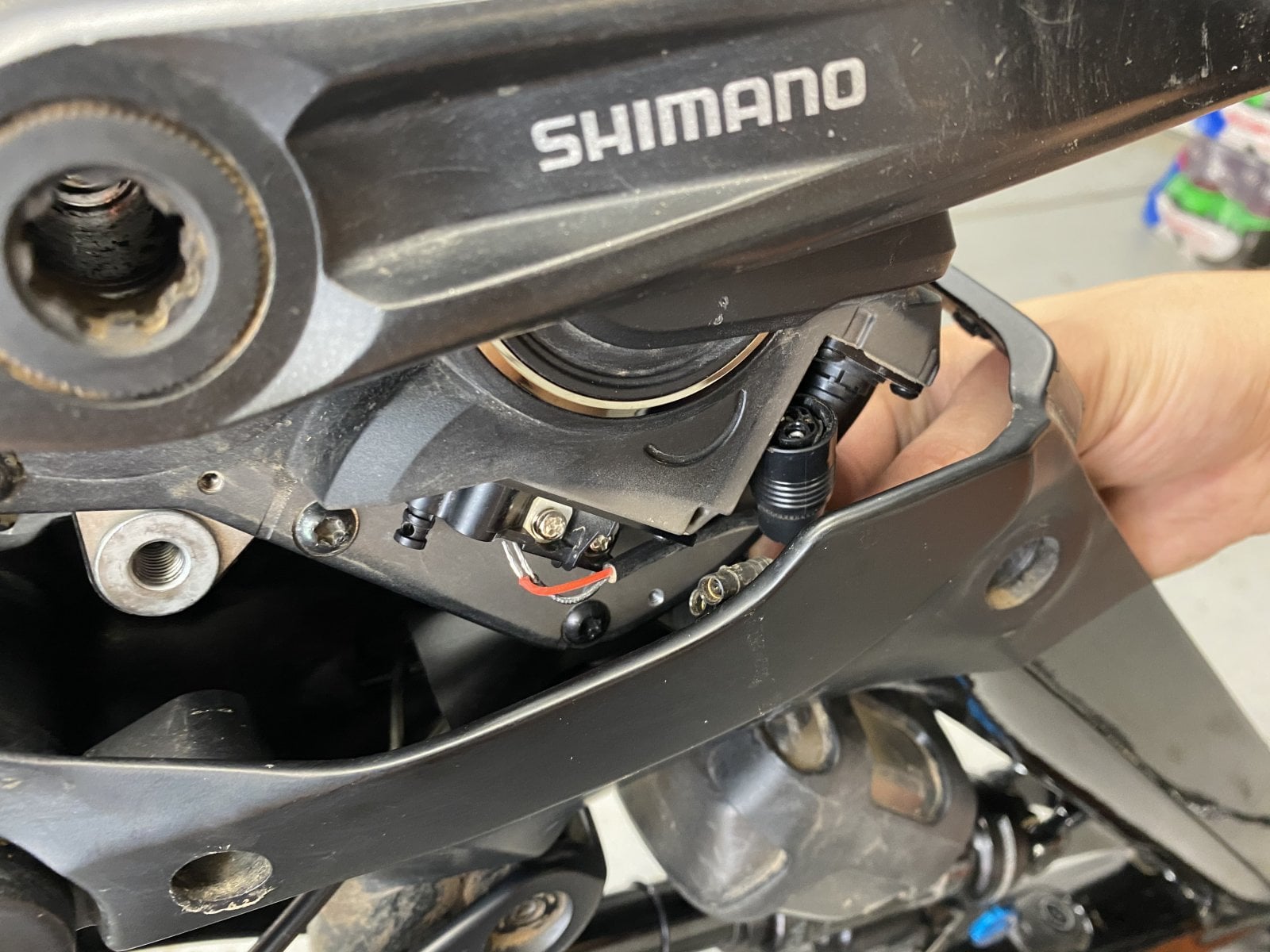

I absolutely hate how there is no room to plug in these connections due to the frame overlapping the motor. Two other bikes I’ve seen with shimano motors have a plastic cover that removes so you can actually work on your bike.
pro tip: to be able to do this with the least cussing possible, remove the battery and cable routing to give yourself more slack to plug it in before the motor is dropped into the frame.
Also flip the bike upside down so you aren’t fighting gravity with the heavy motor.

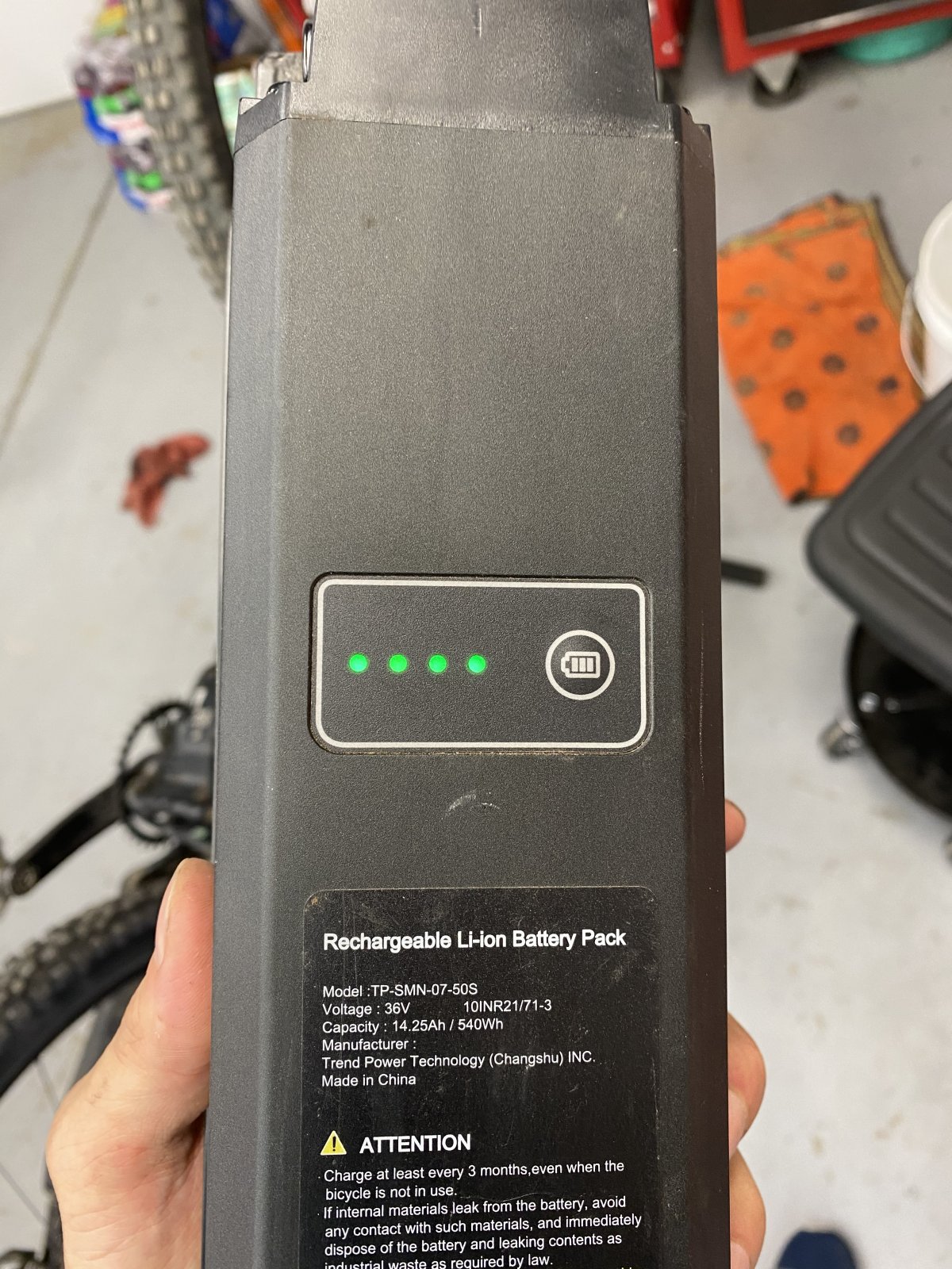

Update:
swapped displays, swapped batteries, swapped full motors. My bike will not turn on still. While I have it off I may try my parts on his bike just to verify before I start ripping out all the cables.

Update.
All the parts I’ve taken off my bike, work on his bike. Not that that solves my problems, but we are narrowing down the options.

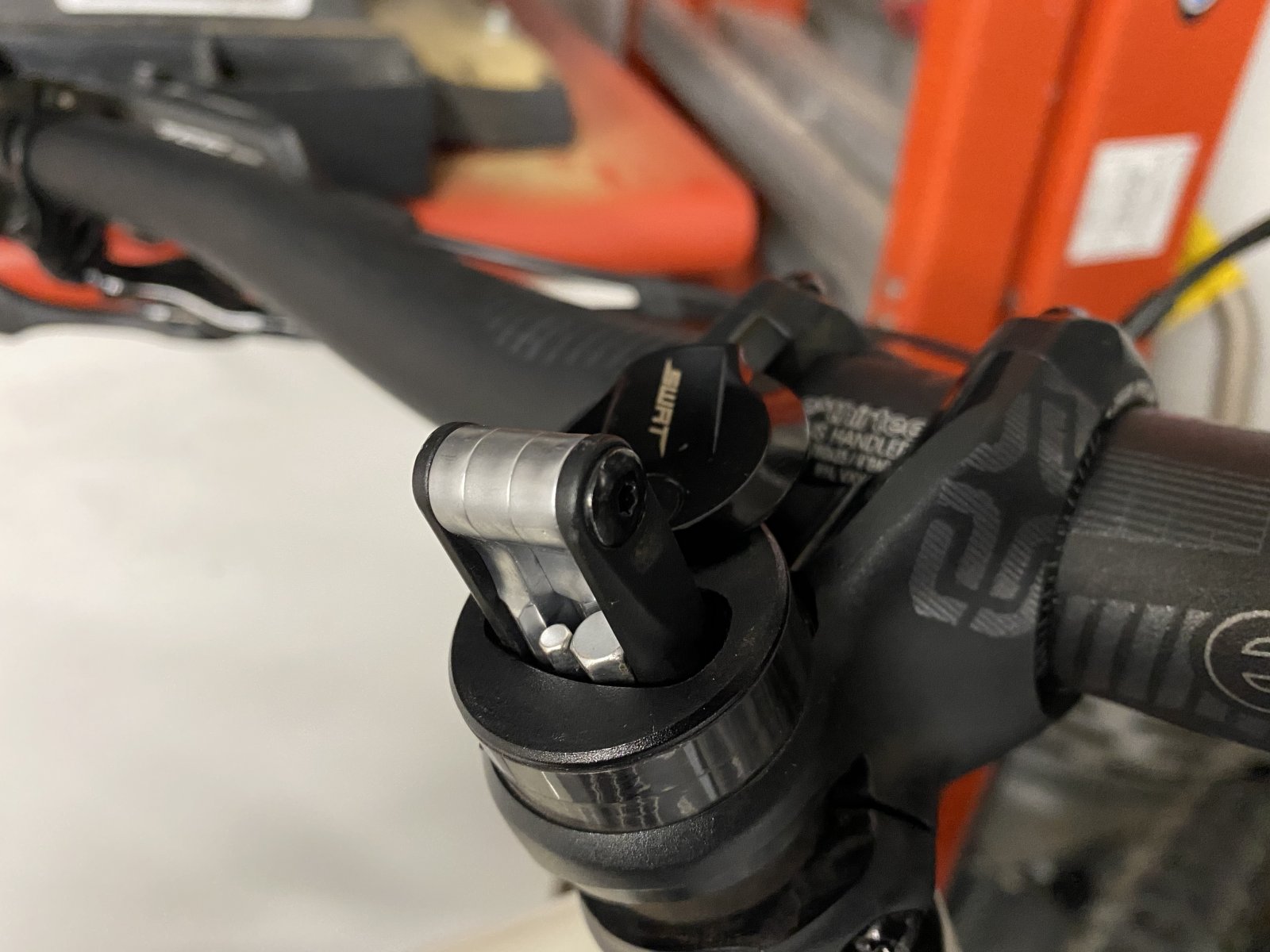

** have to ask .. what is the plug in the bottom of the steer tube of the decoy above ? (underneath photo). Is it one of the old style through headset/stem tightening bolts ? Good to keep mud out.

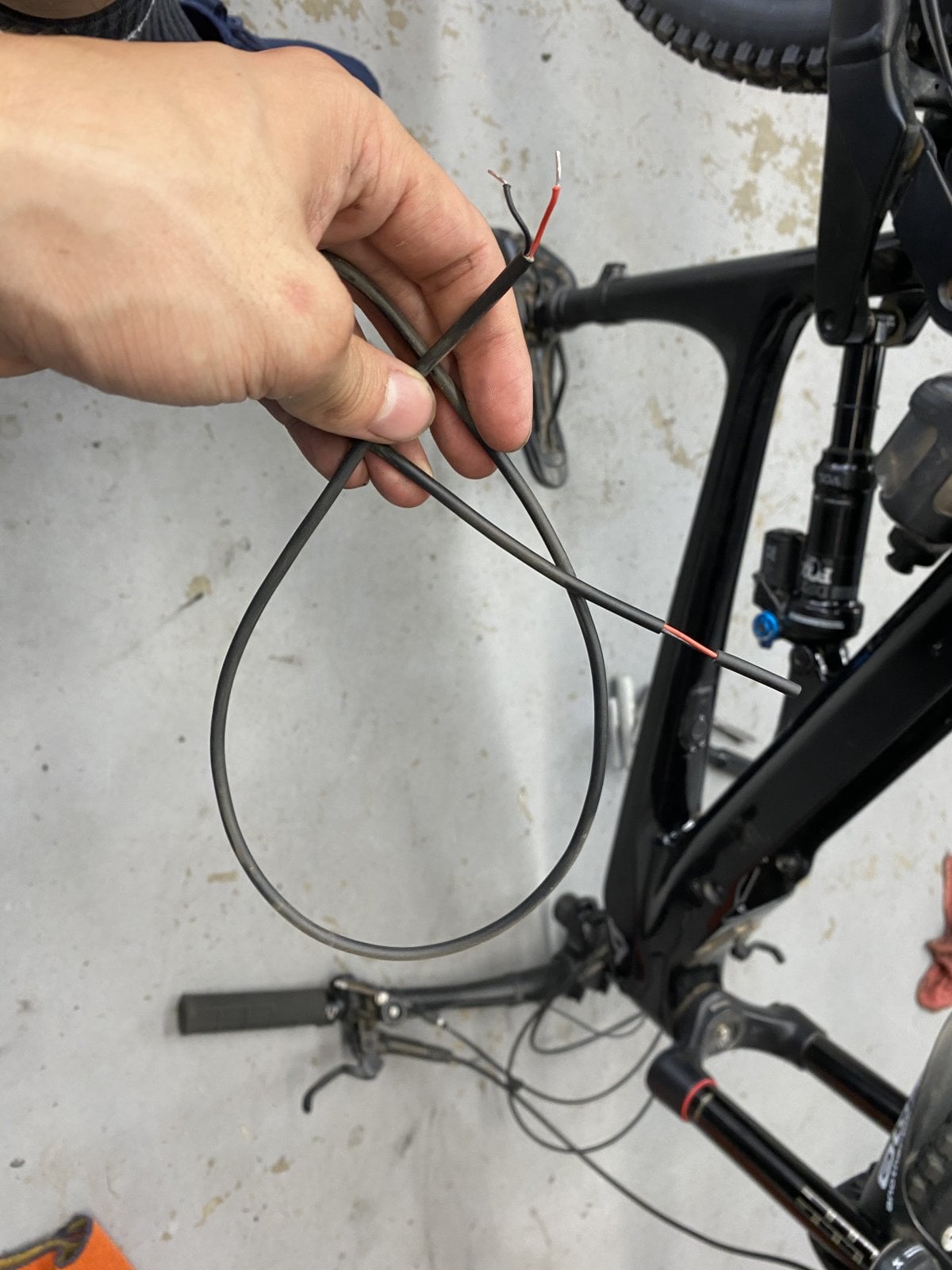

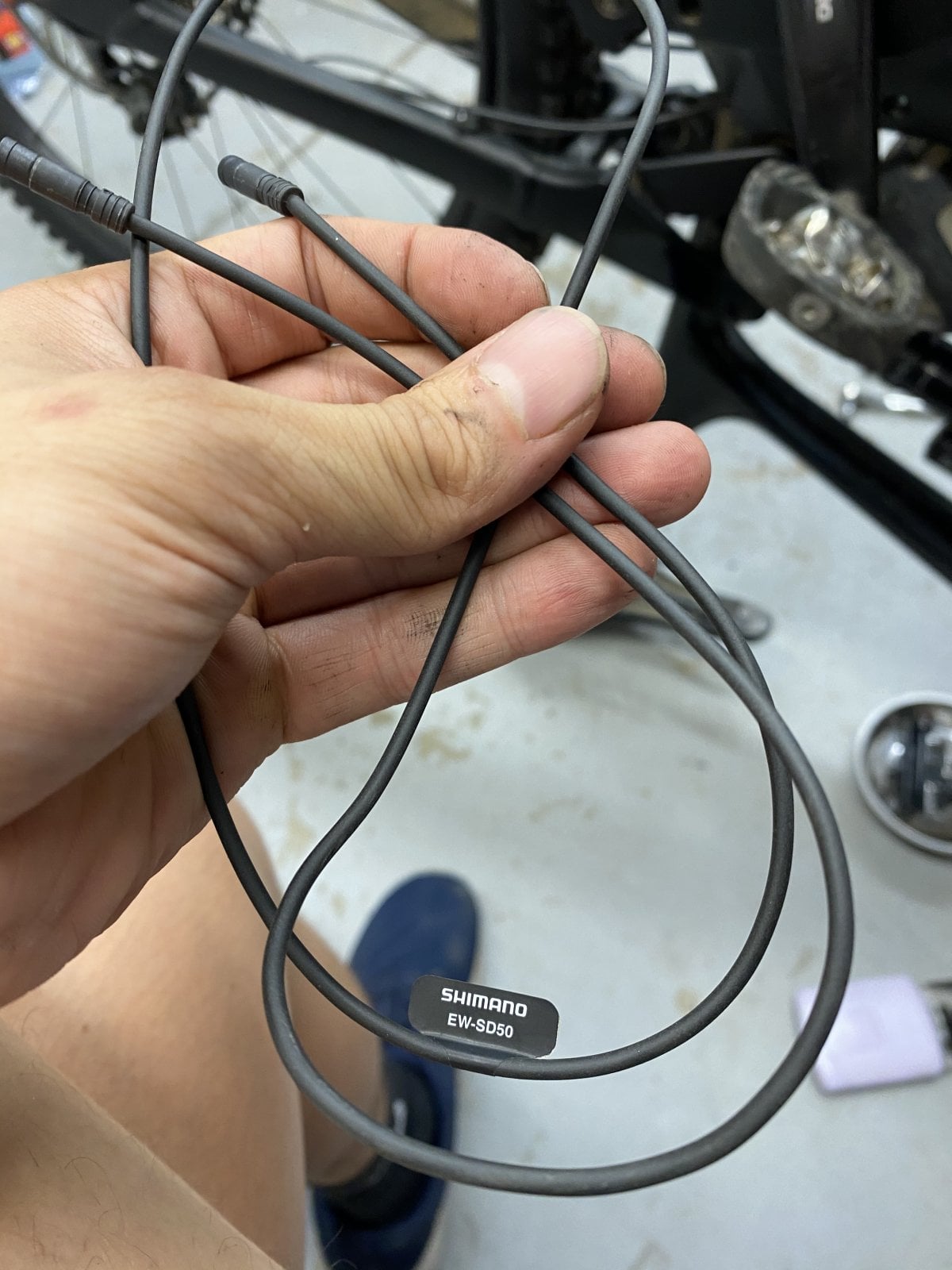

Found the culprit. Swapped on my friends shimano di2 cable that connects the display and everything is up and running again. Just to verify, I tried my cable on his bike and he also got the black screen of death. Should be able to find one online and have my bike back together by mid week.
I don’t know how or why this failed though. Visually there is no damage. Any electrical savy guys know some possible causes of failure and how it could go from working to broken seemingly randomly?
It’s a specialized swat steerer tool that I had to ghetto rig up a different bolt and washers to work with the longer decoy head tube.

Super that you found the problem. The cables from the DI2 are very thin, so you might have stretched it accidentally without realising it. If you have a multi meter you can check if the wires are broken. Should be only two wires I believe.

What is the length of that cable? I was already planing to buy a spare!
900mm.
But I ordered a 1000mm one because there wasn’t much slack in the 900, also that is what was in stock on amazon prime.

How long are the 3 cables ? Are they all 900mm?
Just wondering as having spares seems like a good idea (y)
Thumb switch one is short. Speed sensor is med. Display is long. I’d buy a long spare one, and it will work plenty fine for the other two. Just loop it and secure with some electrical tape or a small zip tie.
