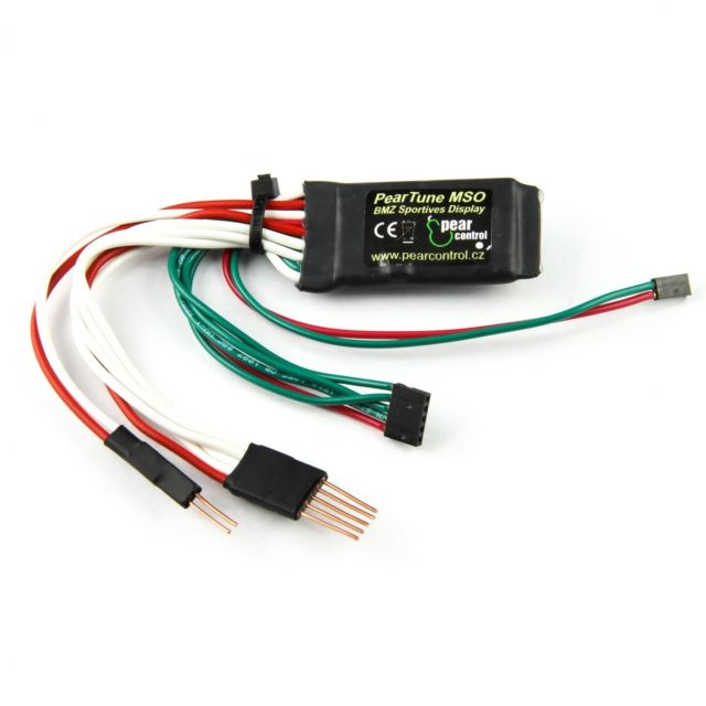

Whilst researching this earlier in the year I decided against dongles that bypass or replace the Spesh cables - not because of whether Spesh could see/tell or not but because of water ingress issues. If you see the bottom two connectors on the example below, there are no rubber O-rings or even the right shaped plugs to fill the motor sockets. Scary!
Maastricht
Oct 3, 2018
646
655
M
Whilst researching this earlier in the year I decided against dongles that bypass or replace the Spesh cables - not because of whether Spesh could see/tell or not but because of water ingress issues. If you see the bottom two connectors on the example below, there are no rubber O-rings or even the right shaped plugs to fill the motor sockets. Scary! View attachment 19813
You are 100% right! This design is asking for issues!
Have you seen however the new Levociraptor sold by Trail Watts? There water ingress is virtually impossible.
