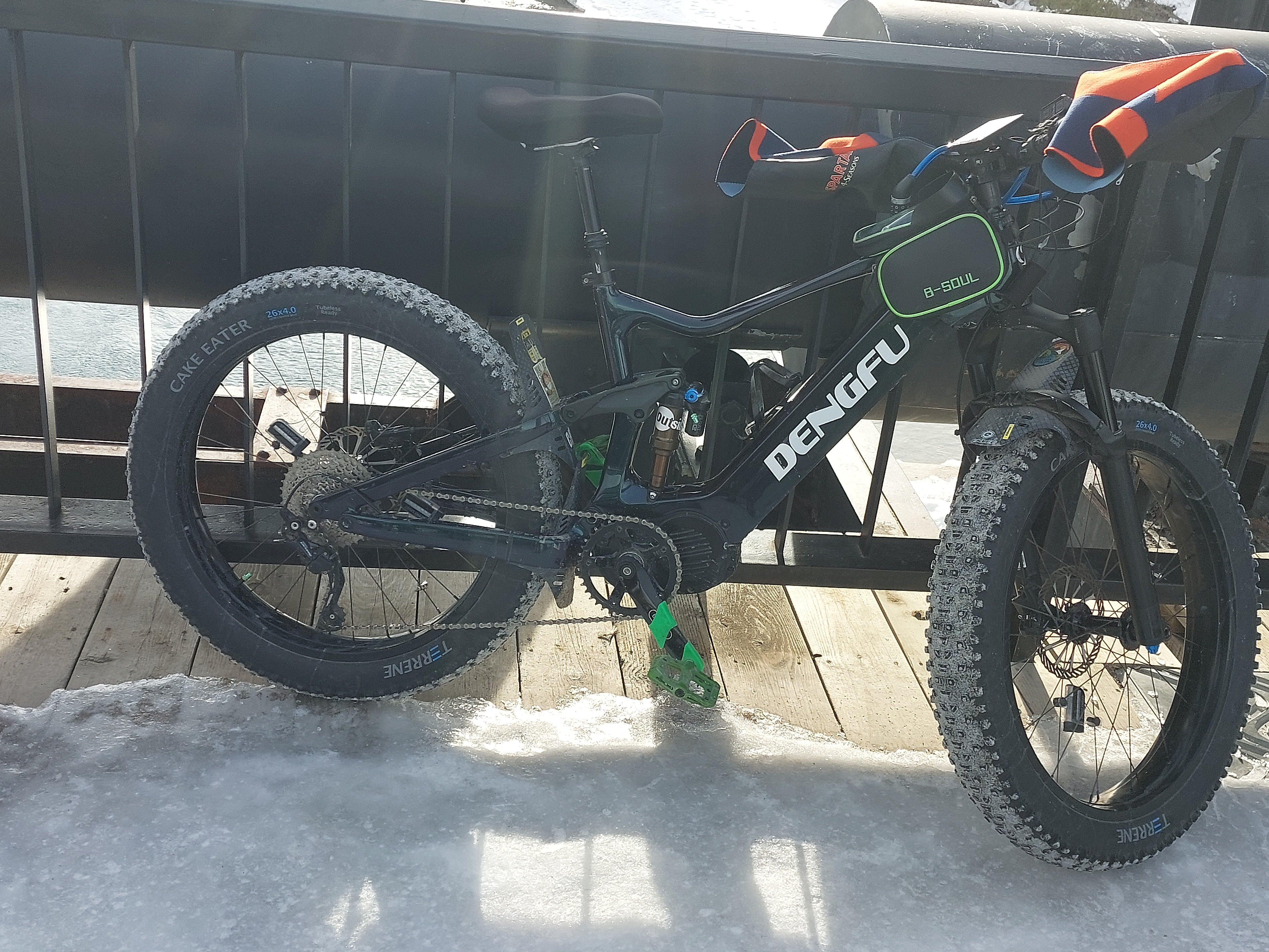

Mabman, I would love some lessons on programming my m620,have a dengfu e06 and It is a little jerky from start. I own the cord and a samsung with 2 different apps for programming.Kind of alot of parameters in the app and I'm nervous to change much .

I would do that but I've read on the net that somepeople have fried their controllers, I'm afraid of that happening. It's OK my ebike seems to be running ok after 1000 km s I'm used to the behavior it has now.This was more for my wife's build .
