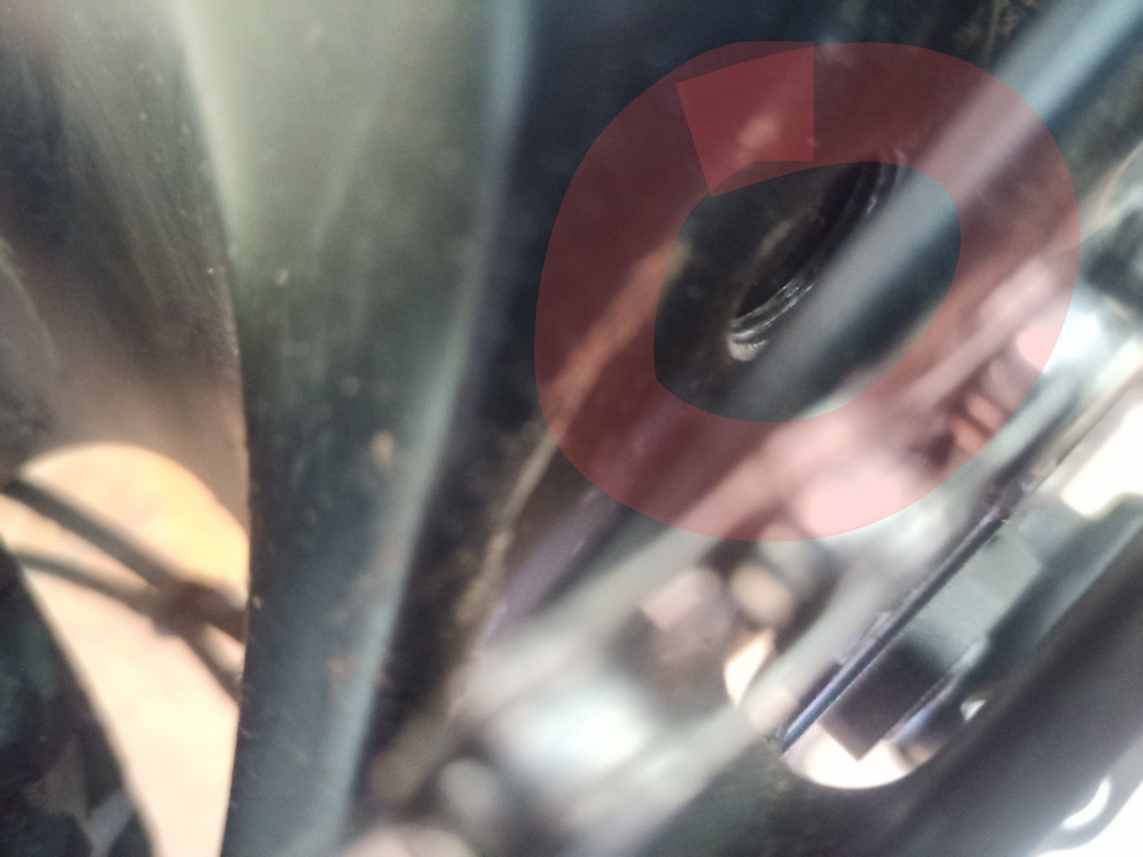

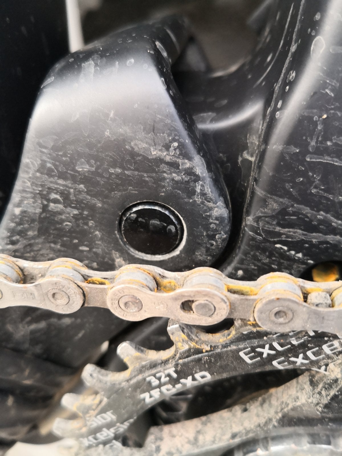

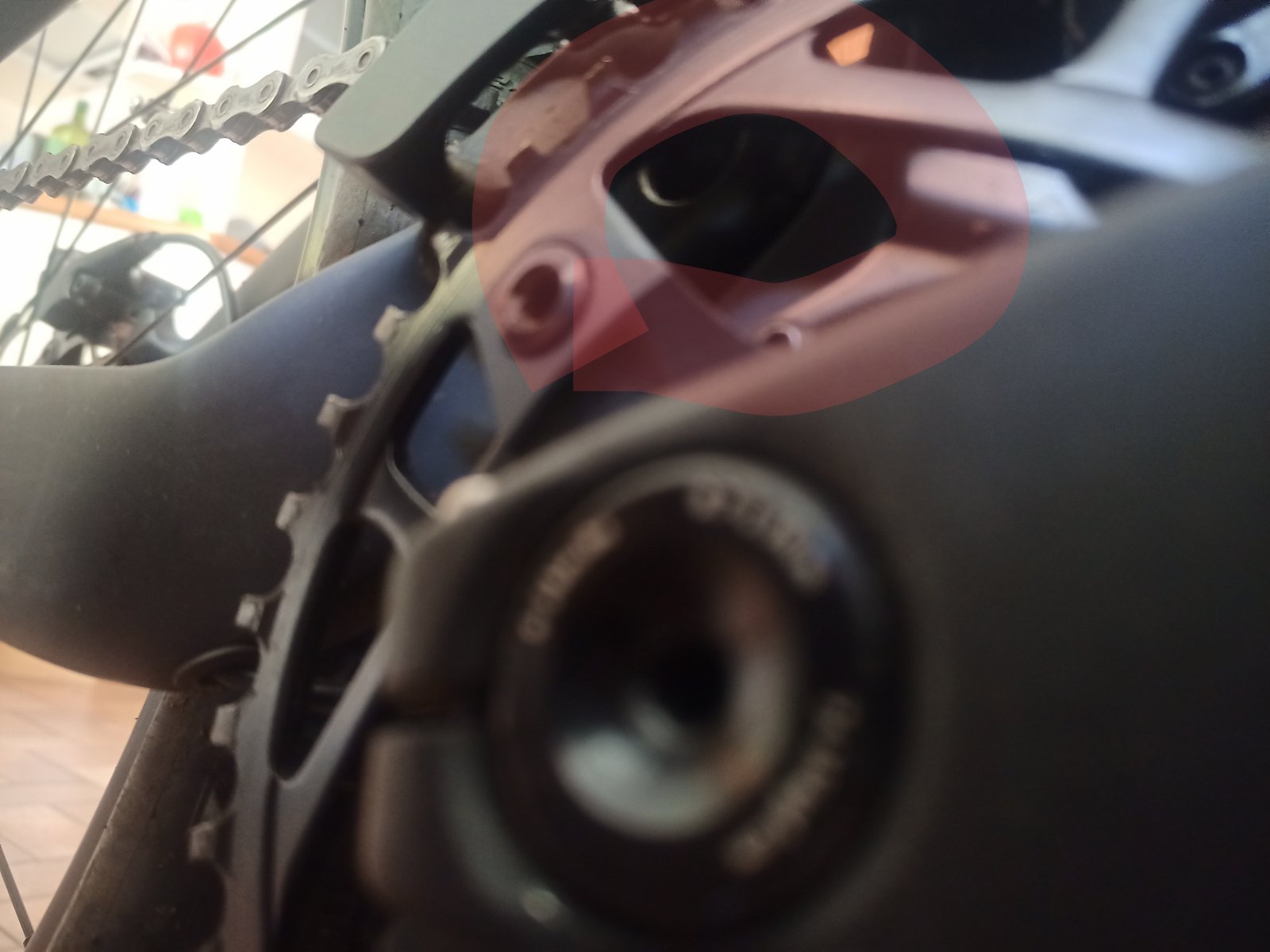

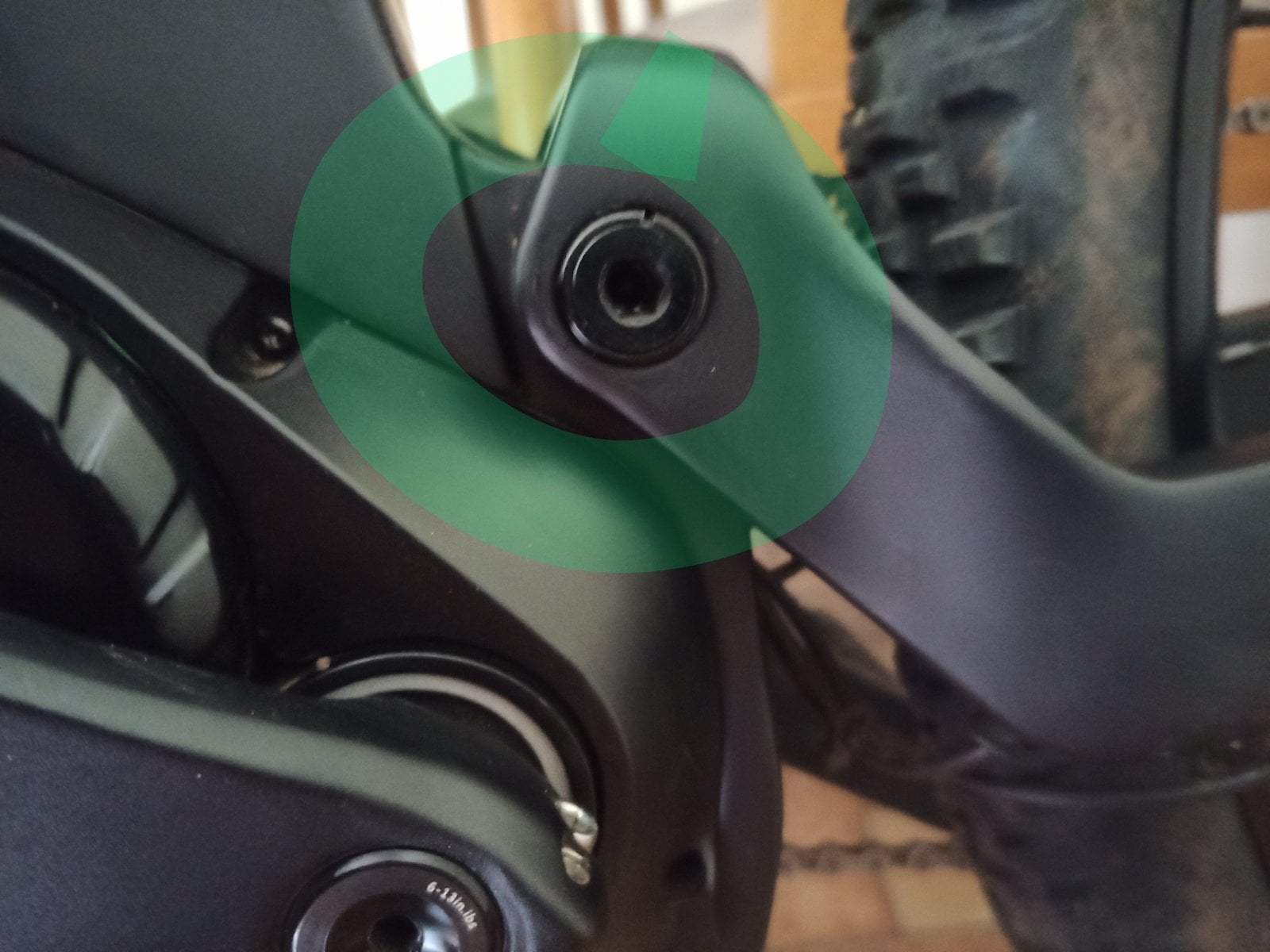

On one side of my swing arm I can see a pivot link 'bolt' as shown on the last image.
Does anyone know what torque this should be tightened to please?
On the other side I just see screw threads as shown on the first two images. Is this normal or is the bike missing a bolt or some other part that should be screwed in?

as you've built up your e10 bikes, could you please have a look at the images above and let me know if this is supposed to be a straight through bolt only from one side - or if there is supposed to be something also on the other side?

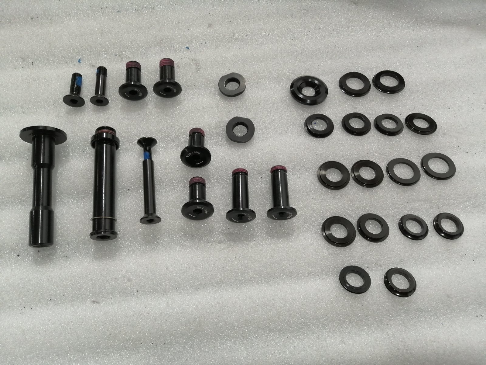

I sent the same images to Melody and she replied by sending me the image below in case I need to order another part - however I have no idea if the bike has one missing let alone which one it would be!

I didn’t remove that main pivot bolt, but it is screwed in from the left (none drive) side only. Nothing missing. Looking at the thread and diameter, I would suggest 10-12 Nm.
