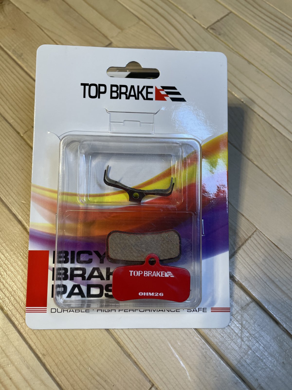

I suppose we have to use the brake pad that works best for you. My neighbor gave me these.
They worked good but eventually we all went MT7’s with 220mm rotors. There’s nothing wrong with the Shimano brakes, it just depends on the type/style of riding you do.

I suppose we have to use the brake pad that works best for you. My neighbor gave me these. View attachment 87405
