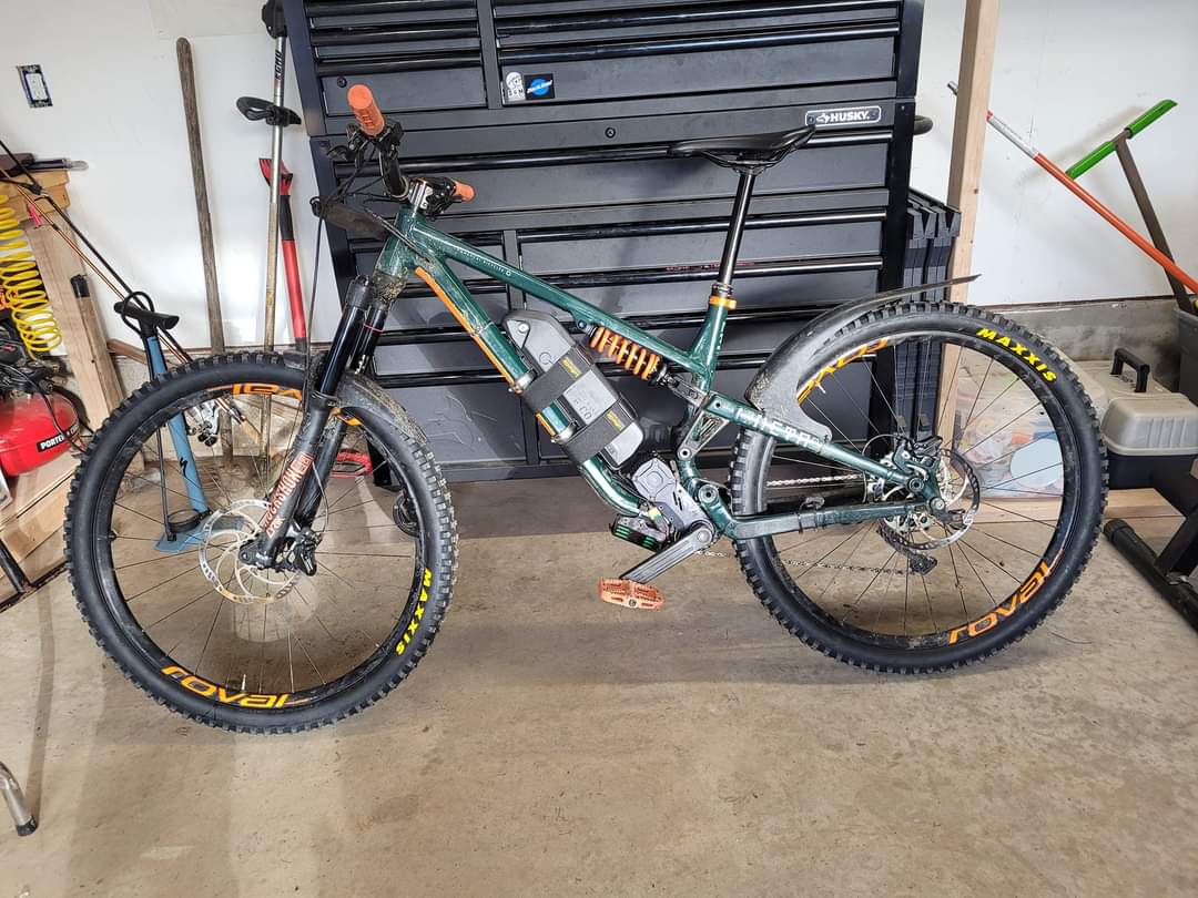

What you want to do reminds me of this build in a ebike group on FB (photo is from Seb Dean not me). I think if you have the skills to make sure to properly protect the battery from impacts and you don't mind building your own battery go for it!
Bengy22
Aug 25, 2022
125
80
Thanks for that photo! It reassures me--someone has done practically this exact battery shape and mounting location.
No problem, I've seen it done fairly often with the traditional "shark" batteries and a few times now in a fully custom setup. I would make sure to find a good way to secure it to the bike though, a few rivnuts and straps would be a good setup!

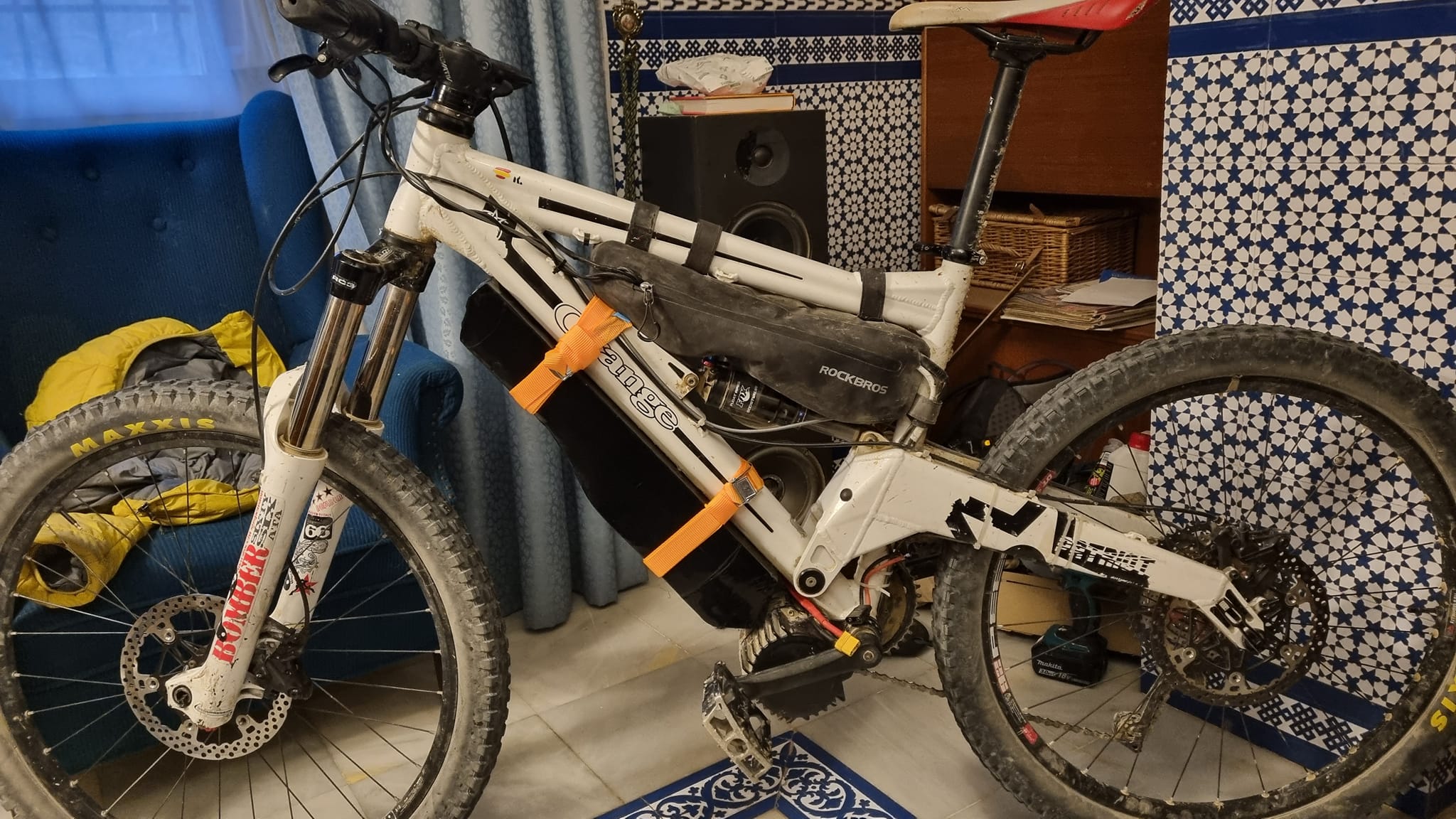

i want to do something like this with an enduro bike. i am not at all interested in a backpack solution and just want to turn a nice enduro bike in to cyc motor ebike. i just want more power than all these low power stock systems deliver that are handicapped by legislation.
14,021
20,794
Rob did quite a funky CYC build - the threads further down in that forum.
