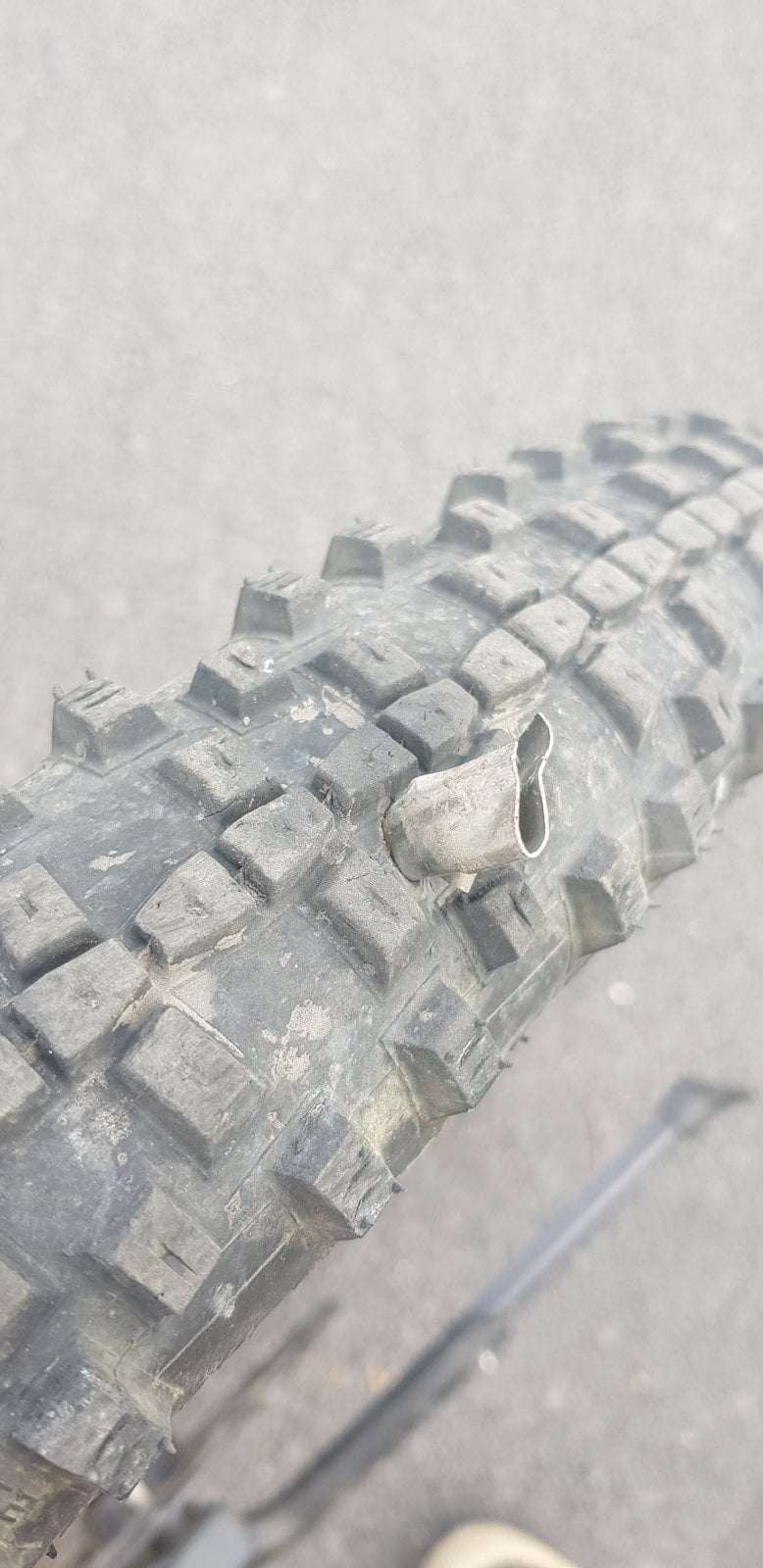

I run tubeless but learned the hard way to carry a tube for catastrophic tire failures. I was asking about running inserts with a tubeless setup.
ouch! was that with the Tannus Tubeless?
Tannus and tube, nothing would have stopped that though, joys of commuting. Luckily I was only a couple of miles from homeouch! was that with the Tannus Tubeless?
