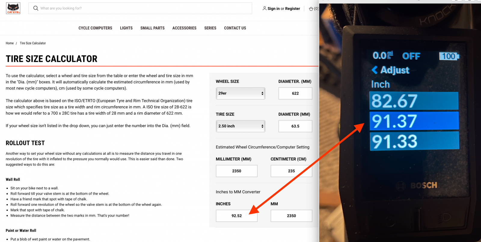

Has anybody here have a higher wheels size limit than 91.37" (2320.8mm). The highest limit is exactly to a 29x2.3" tire, based on the Cateye's tire chart (for reference). If I do a roll-out measurement, I get 92.5" on my current 29x2.5" Maxxis Aggressor. Curious to know what wheel size you have set on your Trek Rail, if you have a Kiox or Nyon? And also what size you might have preset, my original setting was 90.35", if I remember correctly.
I ask this same question in another forum, and one of the member there mention that wheel size is set by the bike manufacturer. In his case, the shop had to contact Trek, so they can adjust limits of the motor through the shop's Bosch software directly to the bike.
Side note: This has me wondering, if these wheel size limits being too low are triggering errors, that many people have being experiencing?

2211 diameter was entered in my Kiox for wheel circumference. 29x 2.6 Minion DHR 11.
(metric obviously). I hope it’s right
