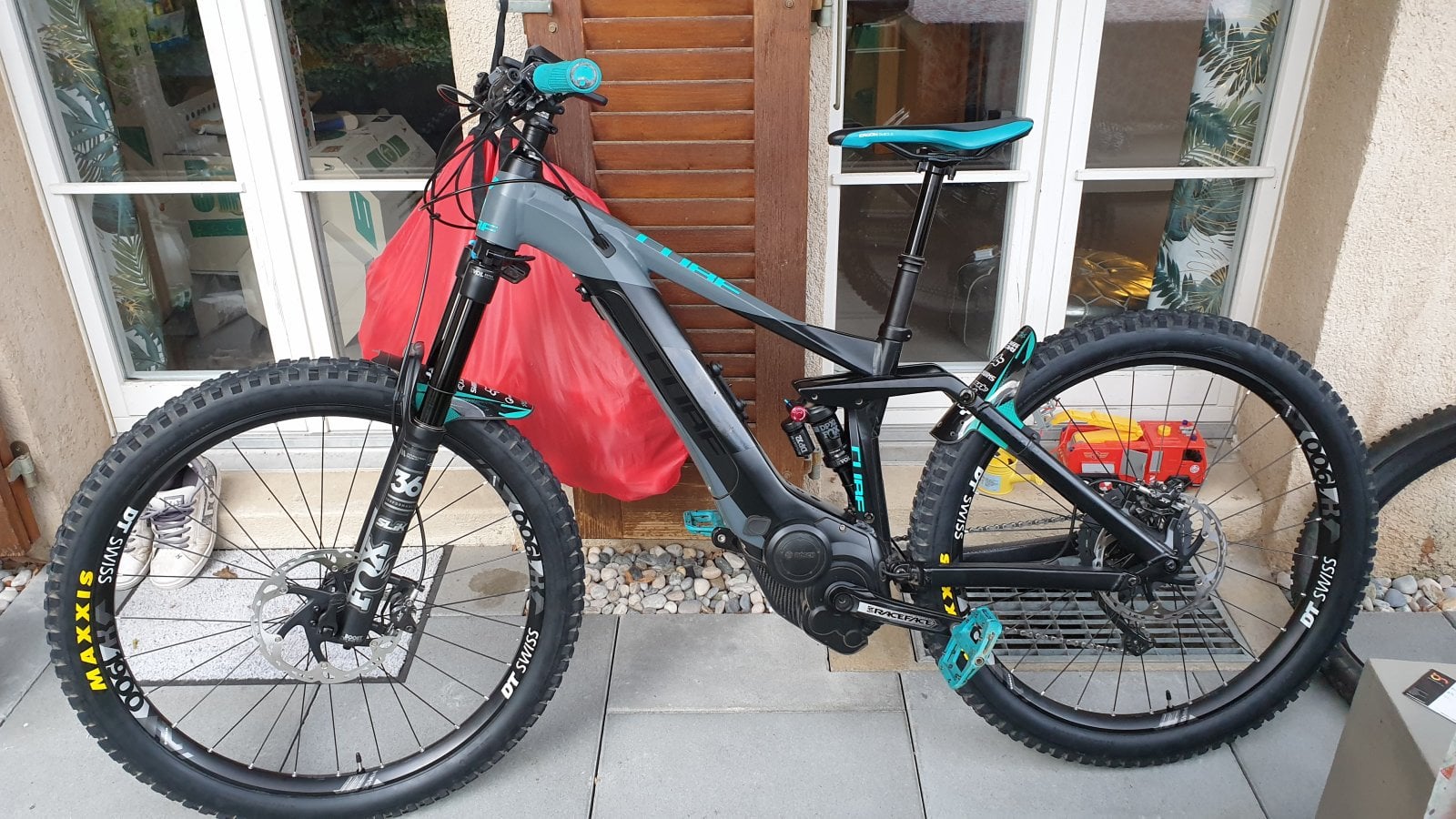

Can someone post a pic of their "size small" Cube Stereo Hybrid 120, 140, or 160?
I have a question regarding its frame shape. Is the frame for the size small exactly the same shape as the medium and large frame? In particular the upper standover part of the frame.
Some bike manufacturers (Trek) change the shape of the frame for the size small for better standover. They added a slight downward curve to it which changes the shape.

Cube Stereo Hybrid 160 SL?

One of the issues i had was that it's quite a high standover for a small, but the frames for S/M/L all have the same standover, it's only the top part that gets longer to support longer seatposts. Ended up getting the medium as the reach was better, but would have preferred a little more standover, due to the shape of the top tube it's even more pronounced as you try and straddle the bike further from the saddle!

Yep S and M standover is the same. Also went to M due to reach. Cube lunched 140 27,5 XS this year. Local store made some late unit orders to suit some clients wo are looking for less standover.
