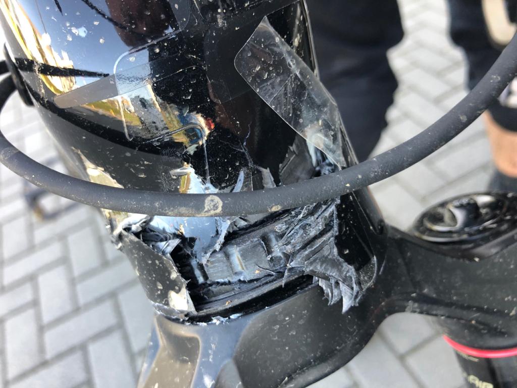

Thankfully I don’t own one, but in my group of riding friends there’s at least 4 2020 / 2021 carbon Cubes 140 and 160 bikes with cracks appearing around the lower shock mount ? infact one of them had them has had the headstock almost rip clean off.
My question is how common are these issues? and if experienced did cube or the dealers mange to resolve things?
Can you post some pictures of your friends bikes so we can see the issues you're talking about, Im especially interested to see the pictures of the "almost ripped off headstock" are they all looking at warranty frame repair/ replacement?

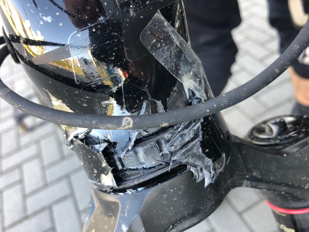

This bike was just 12 days old, 10 weeks later and it’s still broken, so much for cube warranty.....

Wow thats the first picture ive seen of a total failure of the frame, that must have been defective at manufacture to have failed so spectacularly.
I hope Cube gets this all sorted under warranty, Id be furious if that was my bike.
thanks for sharing the photos and keep us posted on the outcome with Cube.

I just checked mine. 2020 TM 160. over 3000 km (nearly 1900 miles) mostly trails & Transalp with heavy backpack. Looks clean as a whistle to me.
That headset photo looks nasty!

How are dealing the warranty claim? Local shop, other?
It’s a friends bike, it was taken back to the shop it was bought from, as far as I know it’s still there and still broken. Sounds like Cube has been extremely unhelpful. People buy bikes from local dealers for the support and back up they can provide, unfortunately major warranty decisions still come down to the manufacturer and in this case it’s been appalling.

Interesting, here even small issues with the frame are solved quite quickly by Cube. Maybe the dealer is a bit slow in dealing with the RMA?

Looking at the first image, toward the bottom left of the headstock just above the lower cup, it may be possible to measure the thickness of the carbon fibre. (at a point where the carbon fibre hasn't delaminated)
Although hard to tell from the photo it looks thin.
If I owned the bike and was in a dispute over the repair, I would then ask Cube what the thickness of the carbon should be at this point on the headstock, next step would be a report from an independent bike mechanic into the failure.
It would be terrible for the reputation of Cube bikes and poor PR if they didn't warranty replace the frame if it was independently inspected and deemed to be a manufacturing flaw.
These bikes are sold to withstand the rigors of riding off road, if this happened landing off a small jump and the rider did not exceed the specified weight limit of the bike then the LBS/ Cube could be challenged to have sold a product 'not fit for purpose'.
