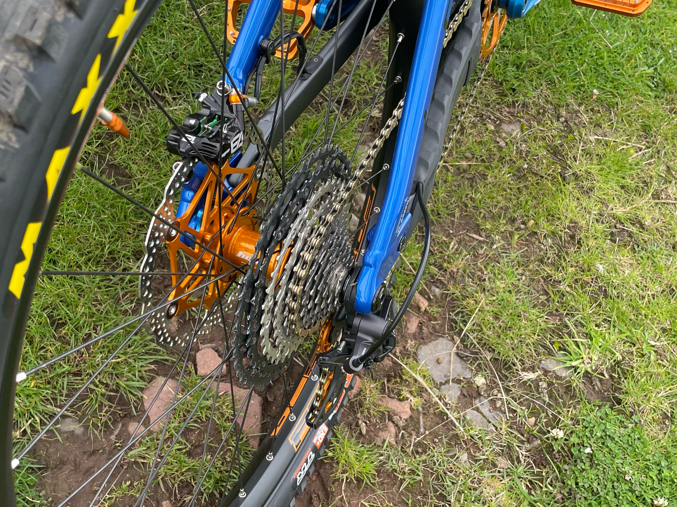

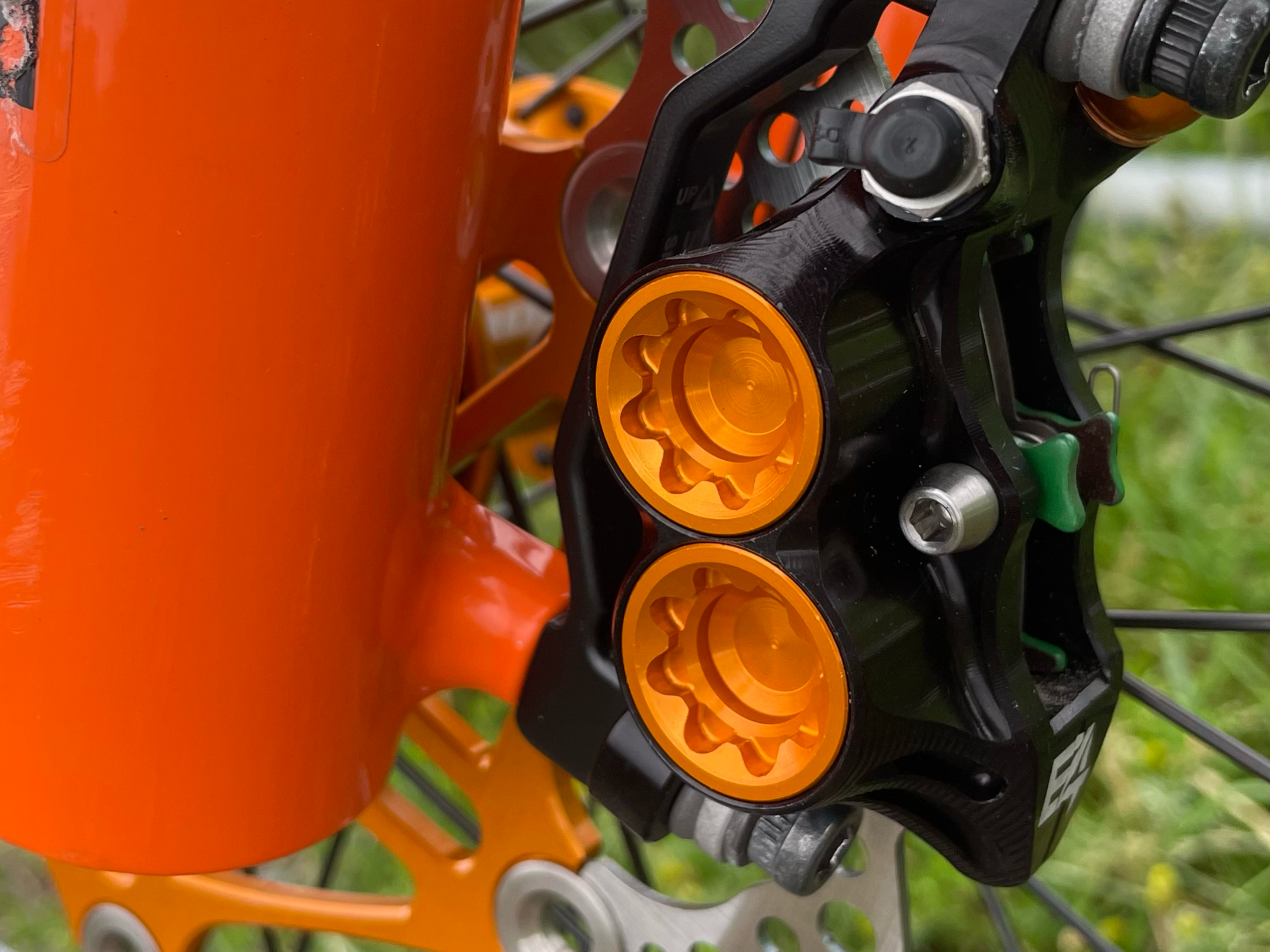

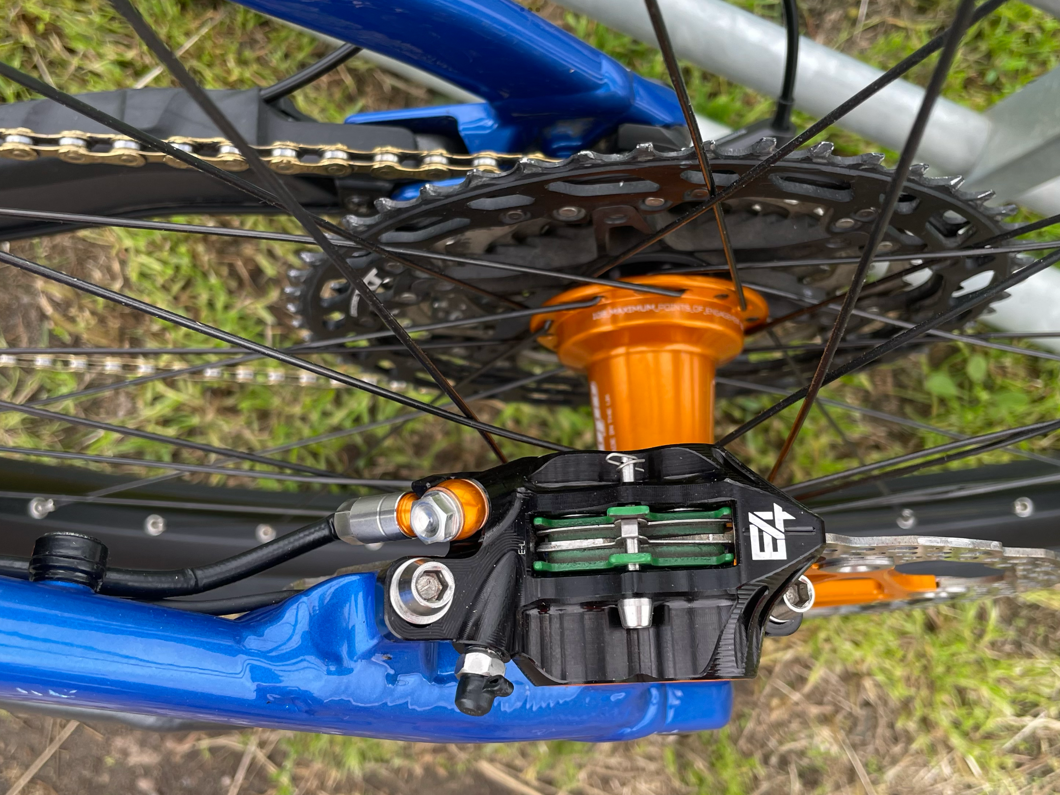

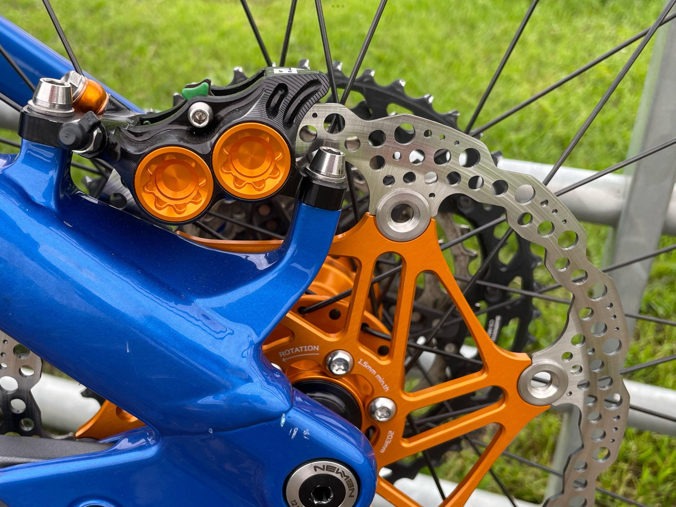

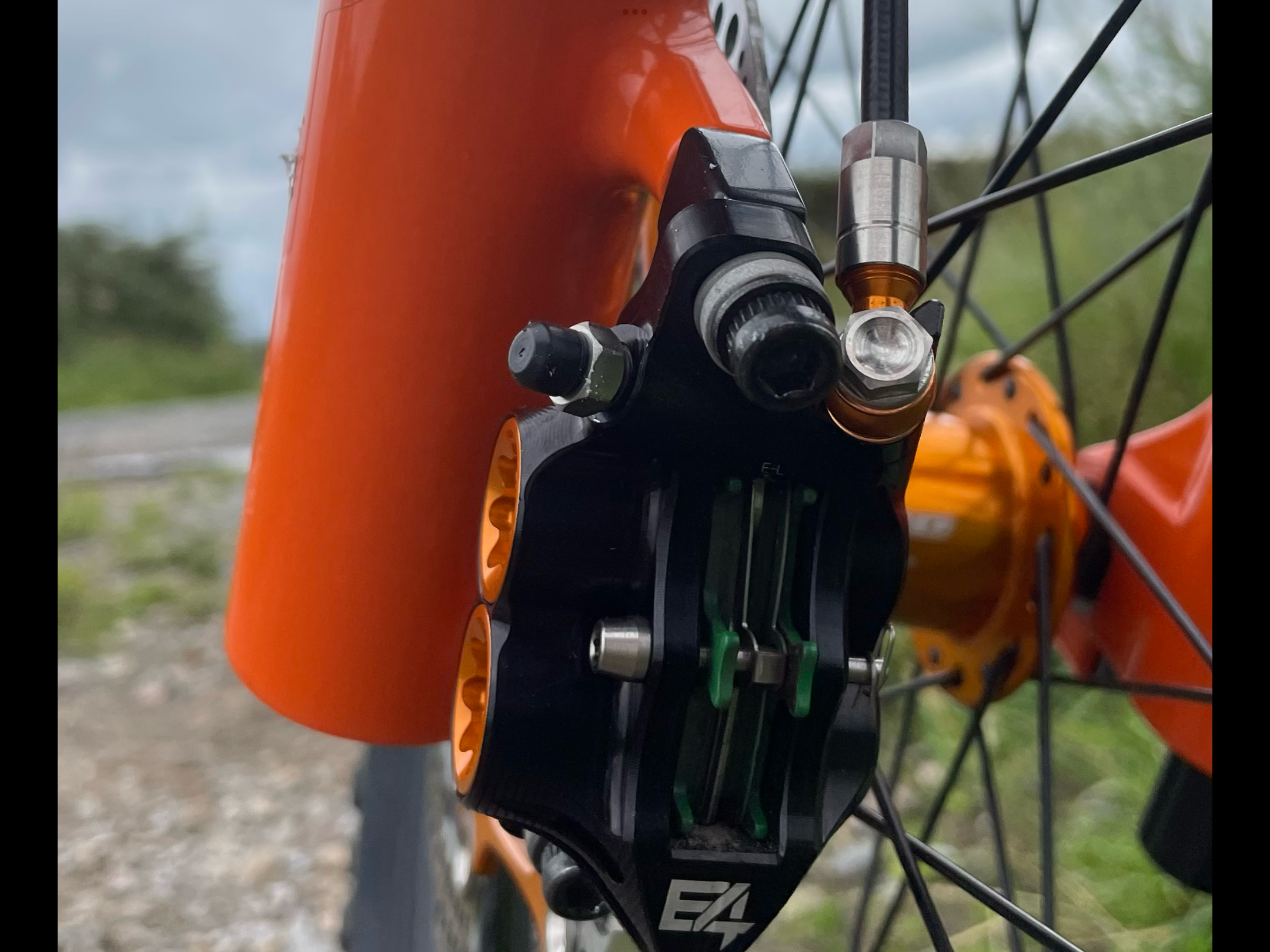

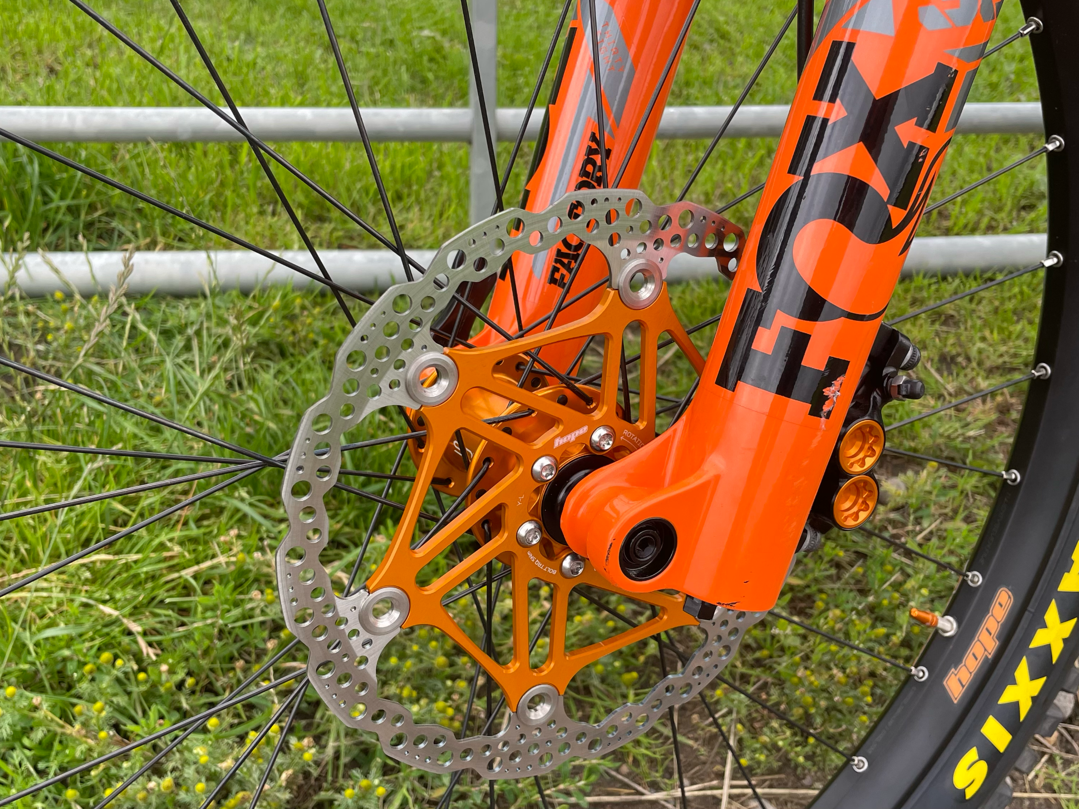

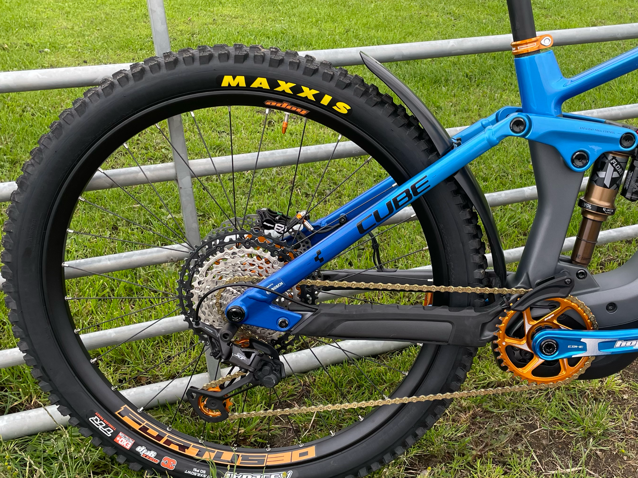

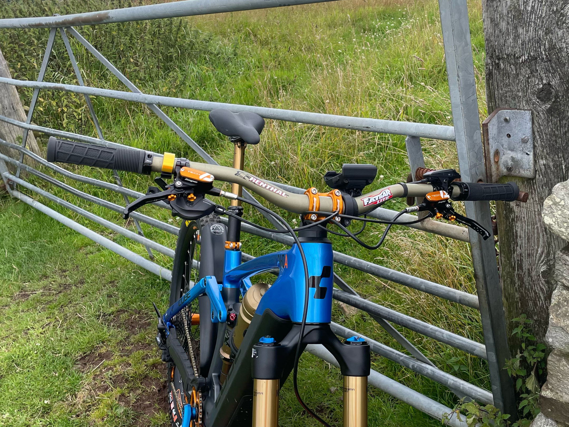

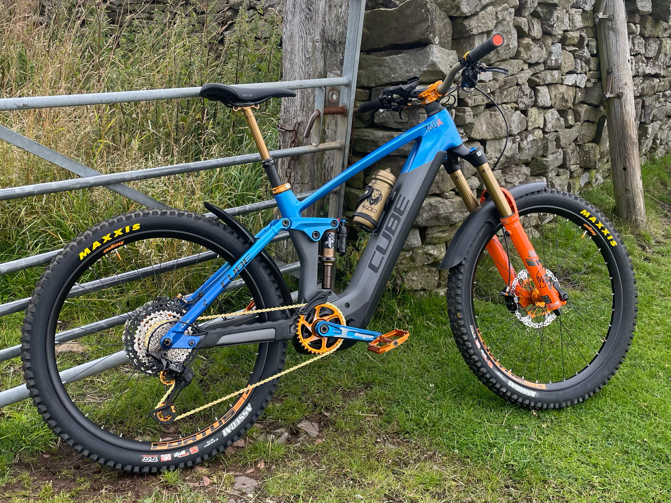

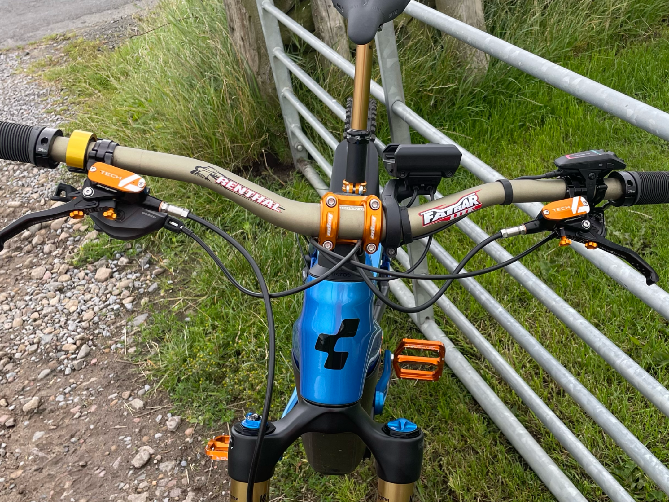

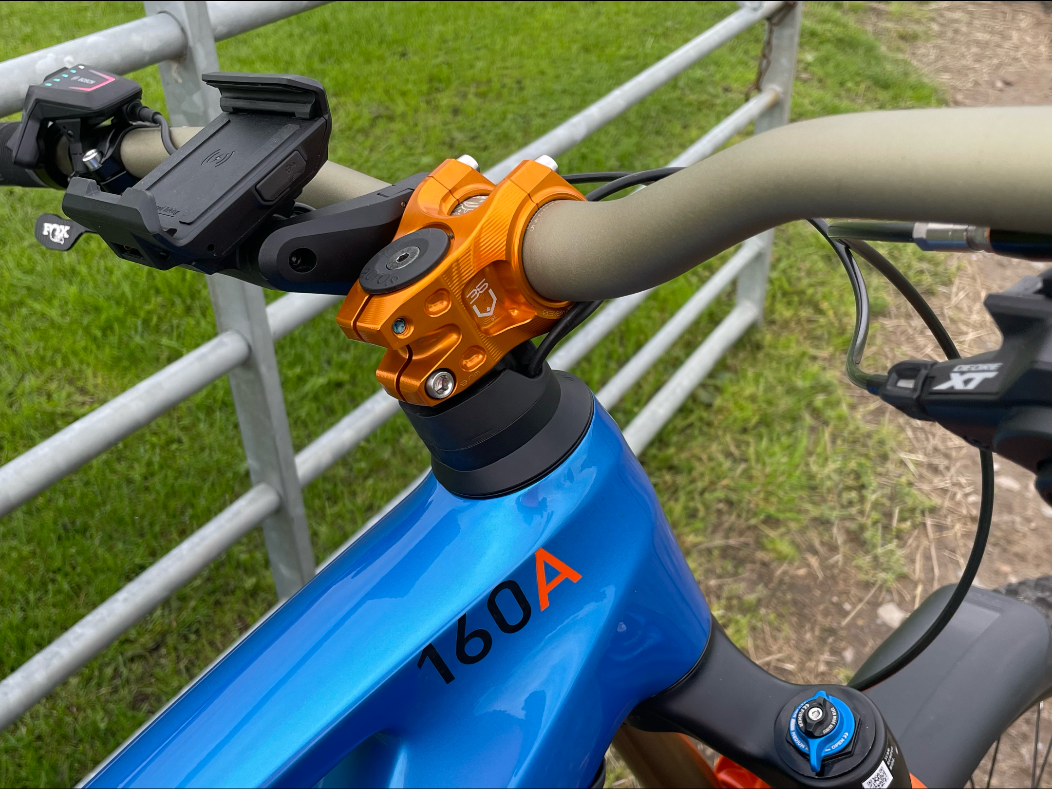

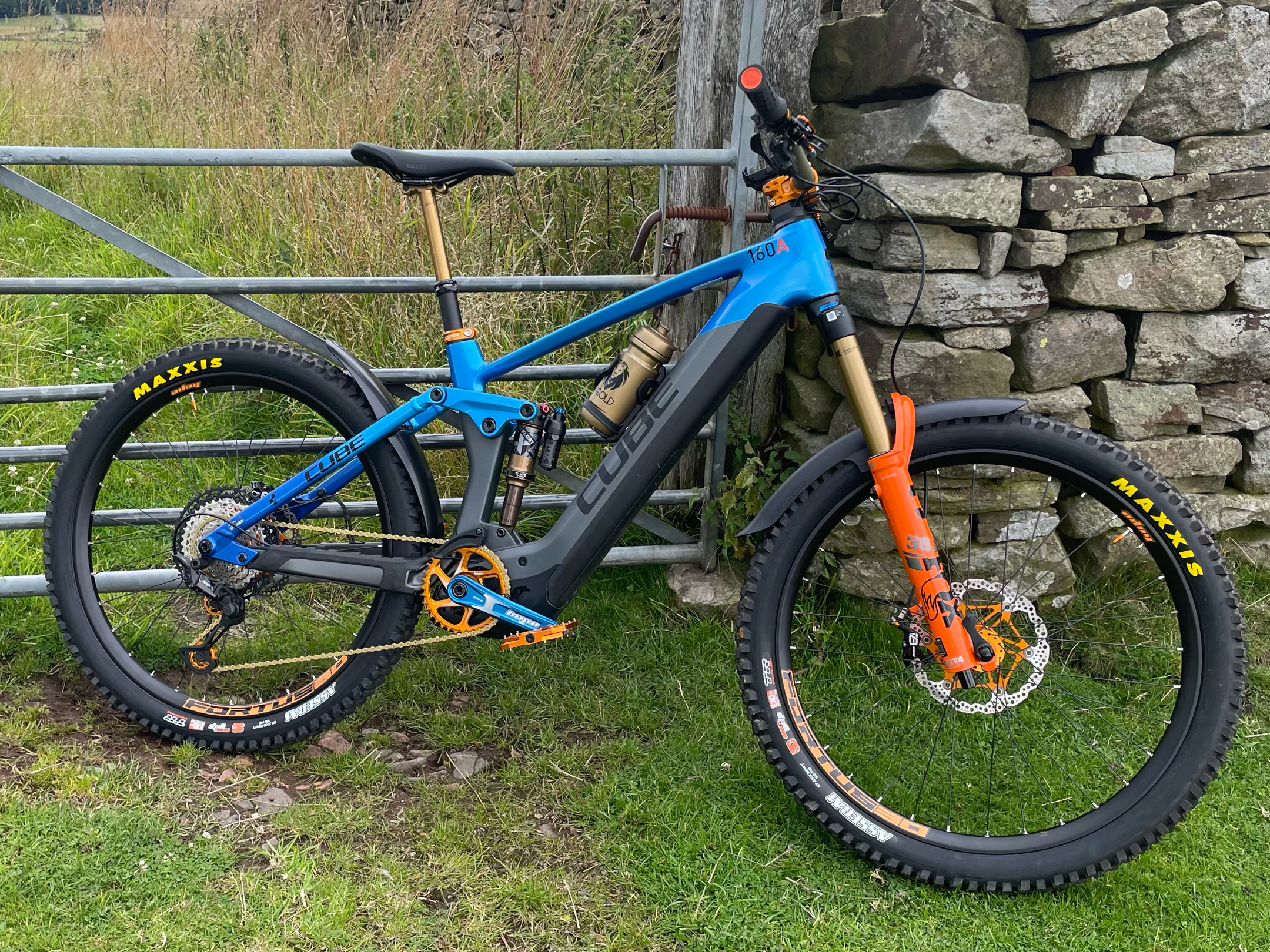

Hi I’ve decided to post some pics of my Cube Actionteam 160
I decided to basically strip everything off except forks and shock and change everything out as I love the bike & the colour scheme but just wasn’t happy with lots of the standard parts, so here goes
Hope Fortus 30 wheels complete with orange Hope pro 5 hubs & e-bike specific stainless steel free hub, Orange wheel graphics
Hope Tech 4 E4 black and orange brakes
Hope orange 203mm rotors
Hope sintered pads front & rear
Hope Tech 4, EV Shimano shifter mount
Hope blue e-bike 165mm cranks
burgtec penthouse 5 pedals
Hope orange 36 tooth chainring
KMC gold Ti-N X12 chain
Renthal fat bar light gold bars
Hope orange Gravity stem
WTB Silverado saddle
Hope orange bolted seat clamp
Hope orange jockey wheels
Bosch smart phone grip
Hope blue R32 speed sensor magnet
Maxxis Assegai Maxx Grip 2.5 Tyres front & rear running tubeless
Proguard direct bolt on front mudguard
sicomb cube stereo specific rear mudguard
4-Gold Kashima coloured water bottle
Standard parts left
Fox 38 forks
Fox float x shock
Fox transfer dropper post
Shimano XT Derraileur
Shimano XT shifter
Bosch Gen 4 motor
Bosch 750wh Battery
Carbon frame

Hi sorry for the delay just noticed this reply

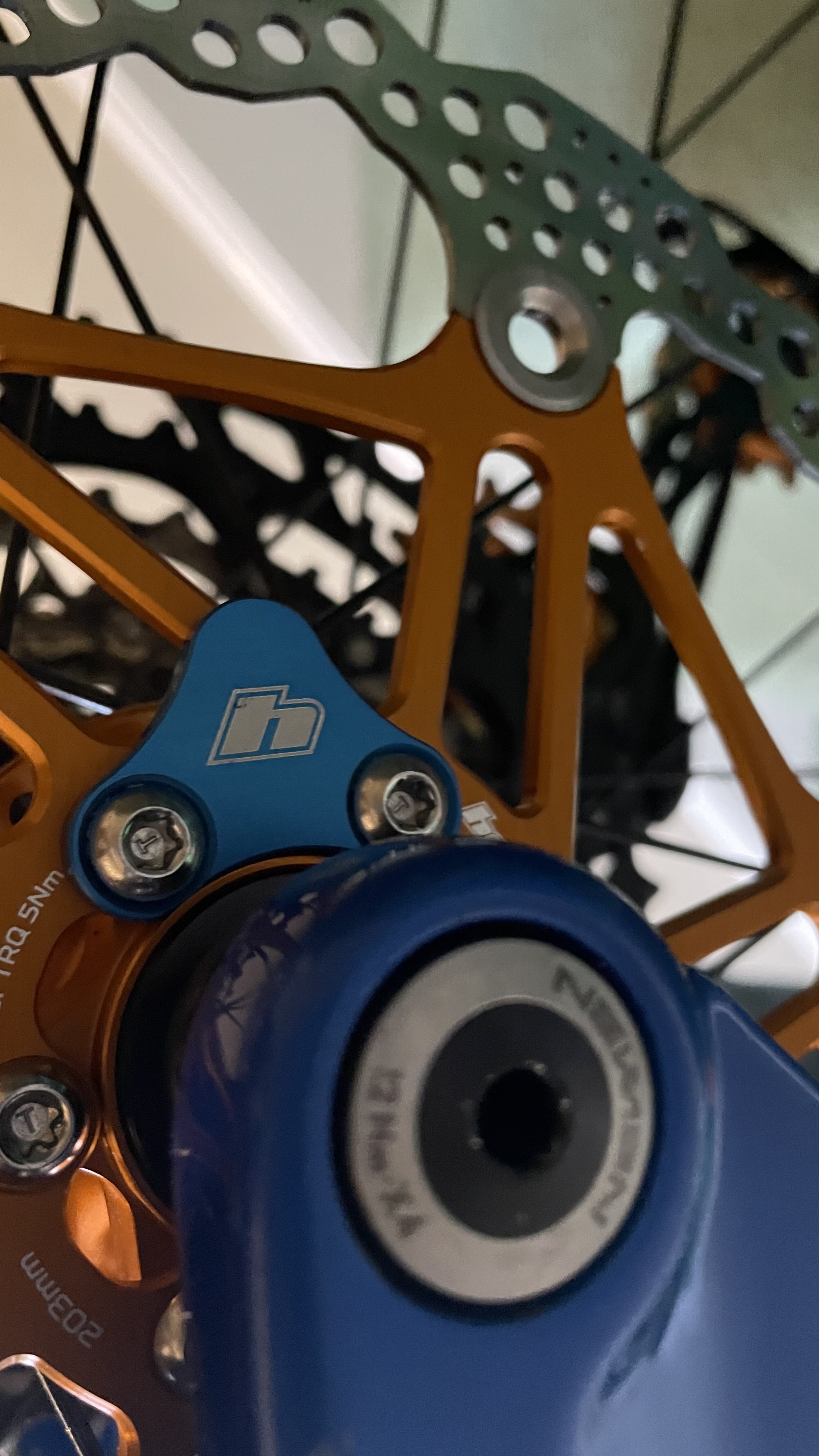

I mainly changed nearly everything for Hope as I love there stuff plus it’s bombproof always loved there hubs there wheels cranks etc a lot of it is just for bling too hahaa, as for the saddle it killed me so changed that for a WTB Silverado and it’s like going from a kitchen stool to an arm chair no sore buttocks now I also bought a Bosch smart phone grip and I now use my I phone instead of the kiox and it all links to Strava/Komoot and just generally a larger screen and better for maps when planning routes on Komoot.
i also changed the speed sensor magnet as I had a times where the assistance would shut off motor still on but no assistance and when I looked at the standard magnet it wasn't a very good fit so now I have a Hope one attached to the rotor bolts on my Hope rotors and yes all brakes changed as Hope brakes are excellent

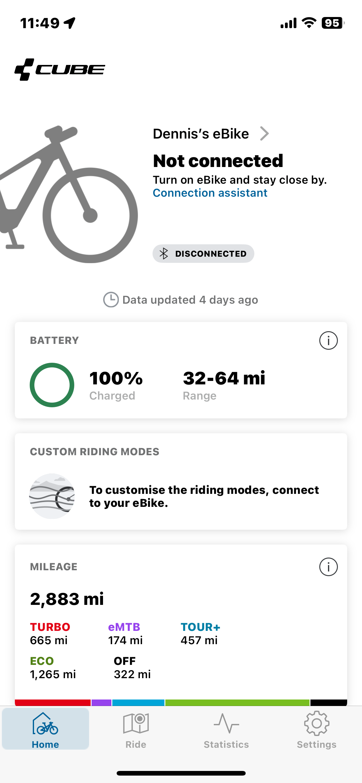

Hi I’m running the standard 27.5 front and rear I presume it means the fork can run either wheel size,as for the headset I’m running into nearly 3000 miles now without a hiccup IMG_4499.png
