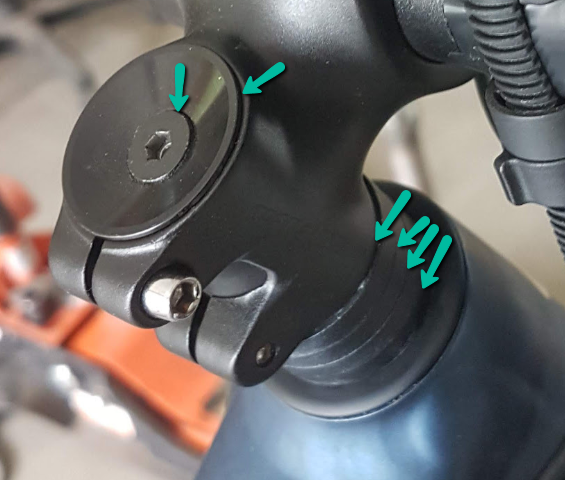

Did you ever fix this ????
I've just found a new fox creak and discovered that incredibly it can be caused by the steerer tube cap being too tight ?!?!?!?!? some weird creak reaction with the star nut when I did it up too tight. Loosened it and now I can't get it to creak ... ?!?! madness.
Take a really good look at your head tube, preferably with an xry machine to pick up those subtle carbon cracks before they become less subtle. Oh, and when the creak goes away stop riding.
Nah, just playing with your head. It's the seat tube :rolleyes:
