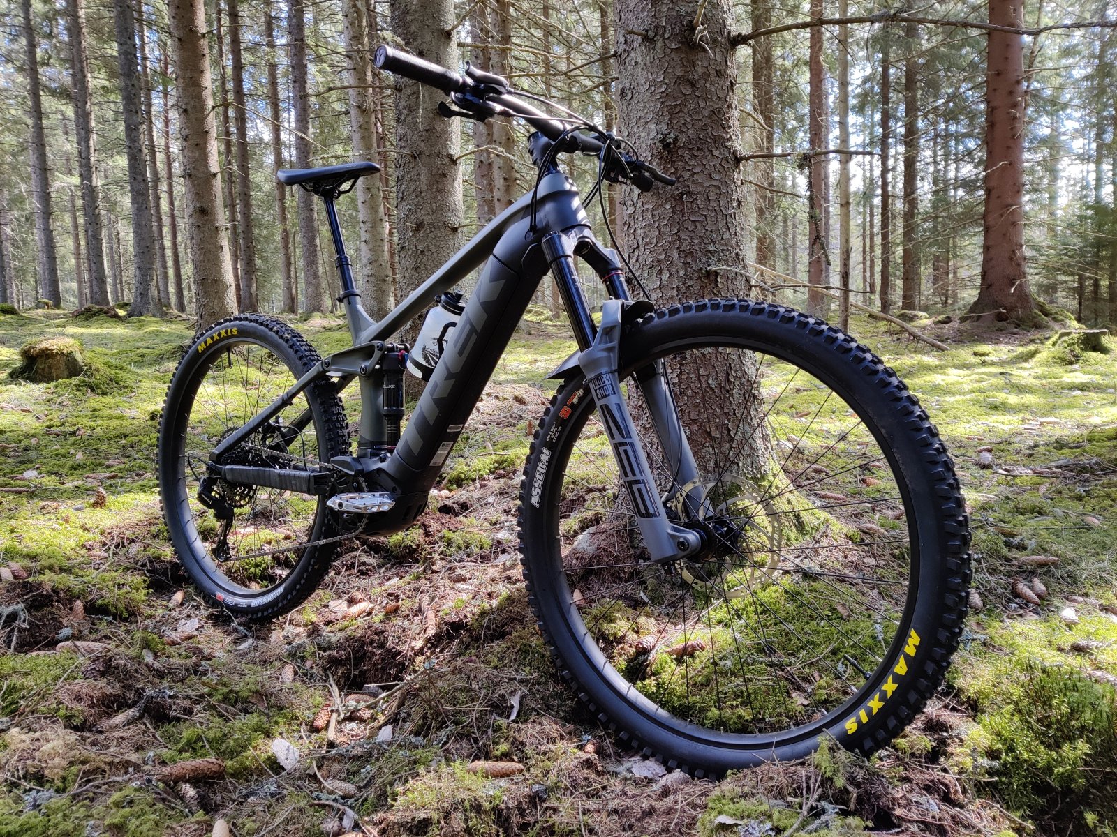

Just got my Rail 5 home and in the process of changing tires, brakes and fork.
Is there anything specific one should do on the Rail before use, known issues? Grease, tourque bolts or other? Should I give the electrical connections a dose of ACF-50?

All bearings were installed dry in the frame so added some grease and acf50 where appropiate, axels however were greased.
Torques were off in some bolts. Still waiting for the chainring tool.
Alex Rims are holding air so far with the tubeless setup.
Did a small test runt yestersay and a longer ride today. Both yesterday and today I got the Error 500. The motor however still provided power and the display went back to normal by pushing the powerbutton. The bike still works normal but this feels a bit sketchy, will give the dealer a call tomorrow.
