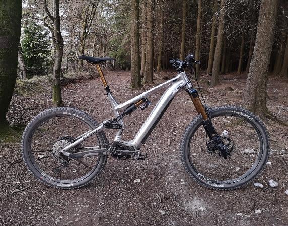

Hi guys,
My bike has developed a creak from the shock/linkage area. Occurs when the bike flexes, making me think it's the shock.
Have had bearings out and all greased and replaced. Have also taken out shock, and mounting hardware obviously, and done the same.
It's better than it was but not totally gone. So yeah, when it flexes, or even, under load on climbing, it's not a pleasant noise.
Any ideas appreciated.
