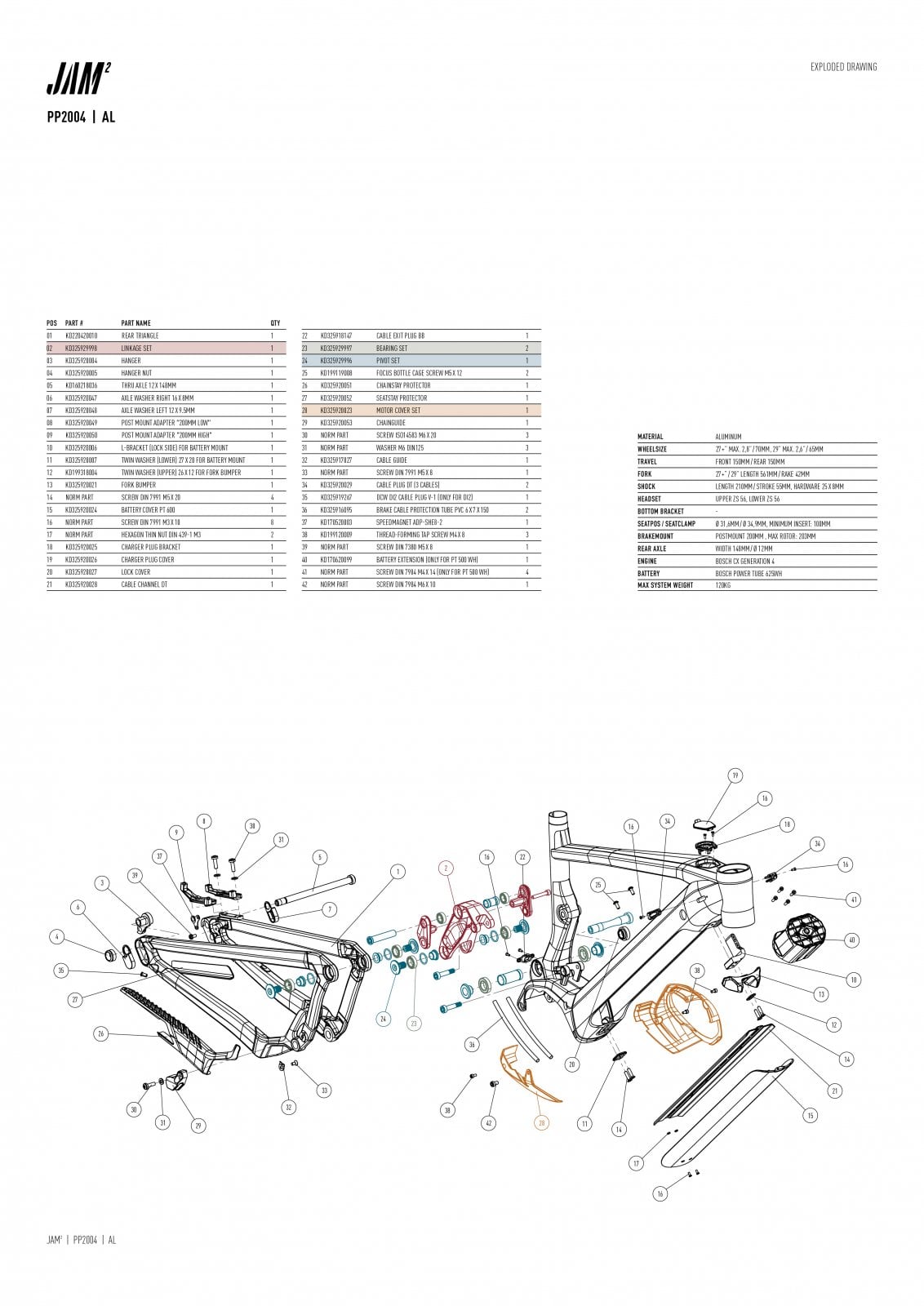

On closer look this is for Bosch version, I have Shimano model. The rear shock mounts are probably the same but although I can identify the rocker arm or linkage set from the diagram, item no 2, I cannot see any mention of rear shock or mounting hardware. I checked the Focus website under tools and maintenance as well as components/rear suspension and cannot find any mention of mounting kit or bolt. Also checked Sram website along with some suspension tuning sites but cannot find 25x8mm shock mounting bolt anywhere.
Ah well, no problem. All the exploded diagrams and parts lists are on this page about halfway down in the tab called "Exploded Drawings".

Was anyone able to get the single bolt replaced? The only option at my local dealer (in Germany) is a "pivot set" (K0330019039 for the sam2) for 90€, and shipping being being delayed to at least mid-october.
The source of the creaking seems to come from the shock mounting moving directly on the bolt, as the shock doesn't have ball bearings in the mount. My mounting bolt is pretty badly worn by now.
