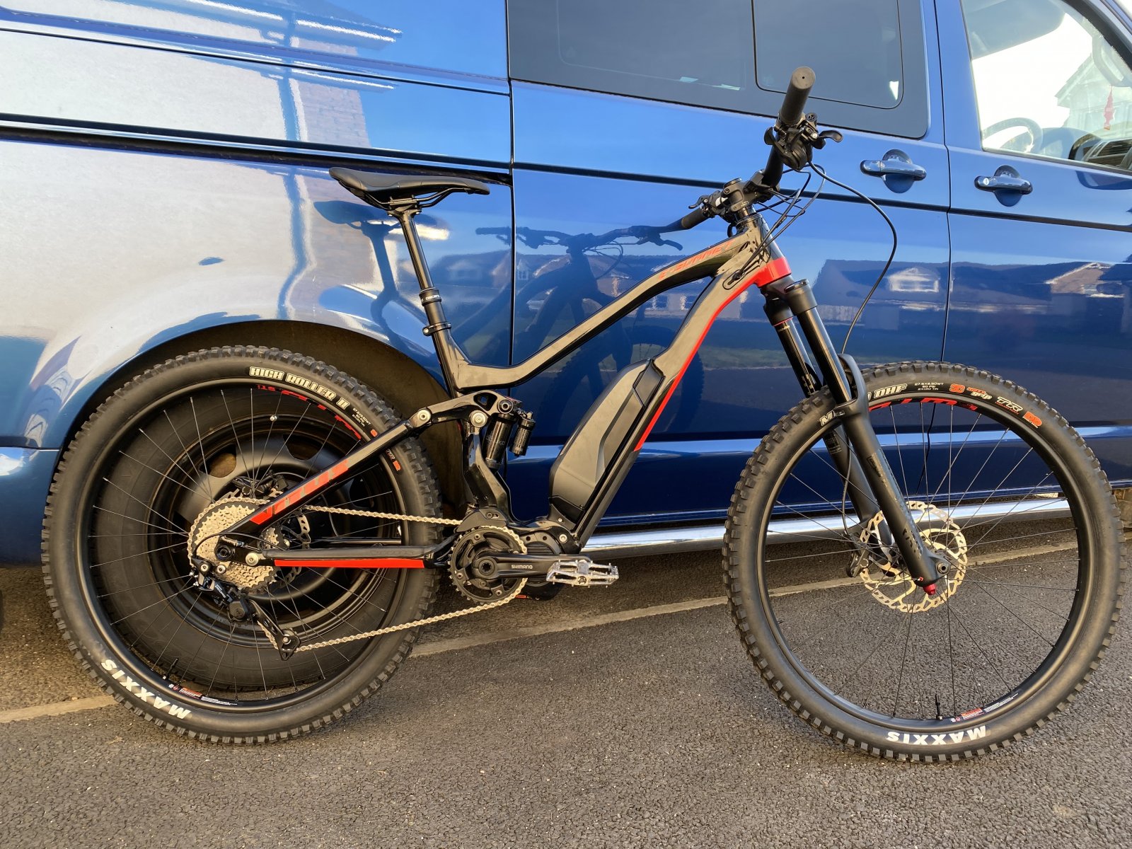

Well it’s finally arrived and I am very chuffed.

Great looking bike, was tempted to get one of these had my LBS not had some great run out deals on a Focus Jam 6.7 late last year.
I think I still prefer the looks of the Vitus, and the battery size is sensible as well.

@Tooks just buy one, you wont regret it! Youve just missed a massive sale CRC had on the XT model was down to £3200.
