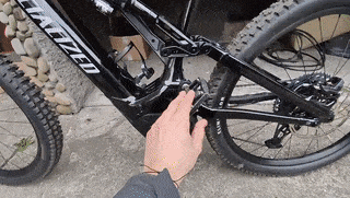

Hi. I have brand new Levo gen3 and I wonder if the motor is alright. When I kick cranks backwards they have so much resistance that they spin maybe 180 degr. What it looks like in your bikes? See the comparison to my old Levo in attachment.

Hi !
Has nothing to do with the belt.
New and greased needle- and spragbearings will dampen the rotation. Smooth braking is a good sign that there is fresh grease and not already washed out as in my Levo after 1 year.
In addition Speci is now placing an O Ring under the driveside crank is compressed an brakes the rotation.

Thanks guys, I feel better now. I was going to remove cranks and inspect this myself, or WD40-ing, but I leave it and just ride !
