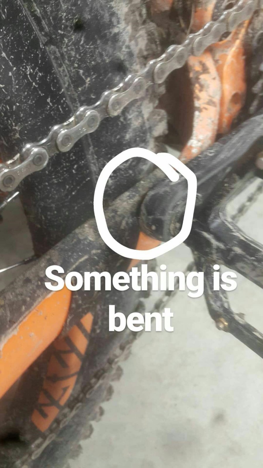

Hi. I bent my drive side crank arm like in the picture. I cant find anywhere that does a replacement, even the UK distributor doesnt have one on its web site. Any sugestions where I can get a Praxis replacement or equivalent?

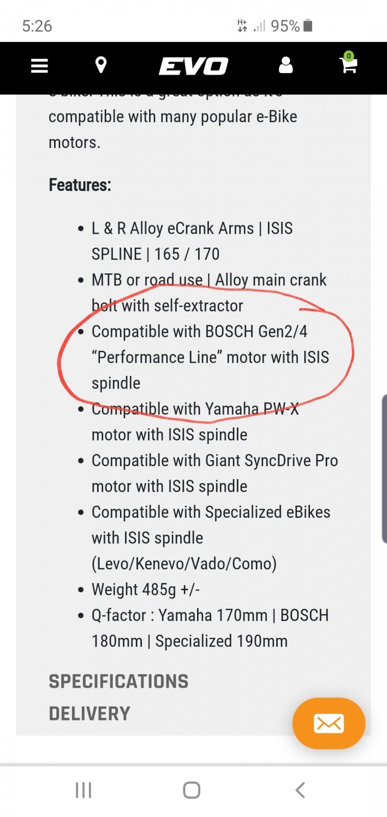

Taken from Evo cycles for Yamaha Praxxis cranks......useful to know.
Anything ebike with isis spindle may work, not much in NZ it seems, Sram do some....search ex1 isis on Trademe.
