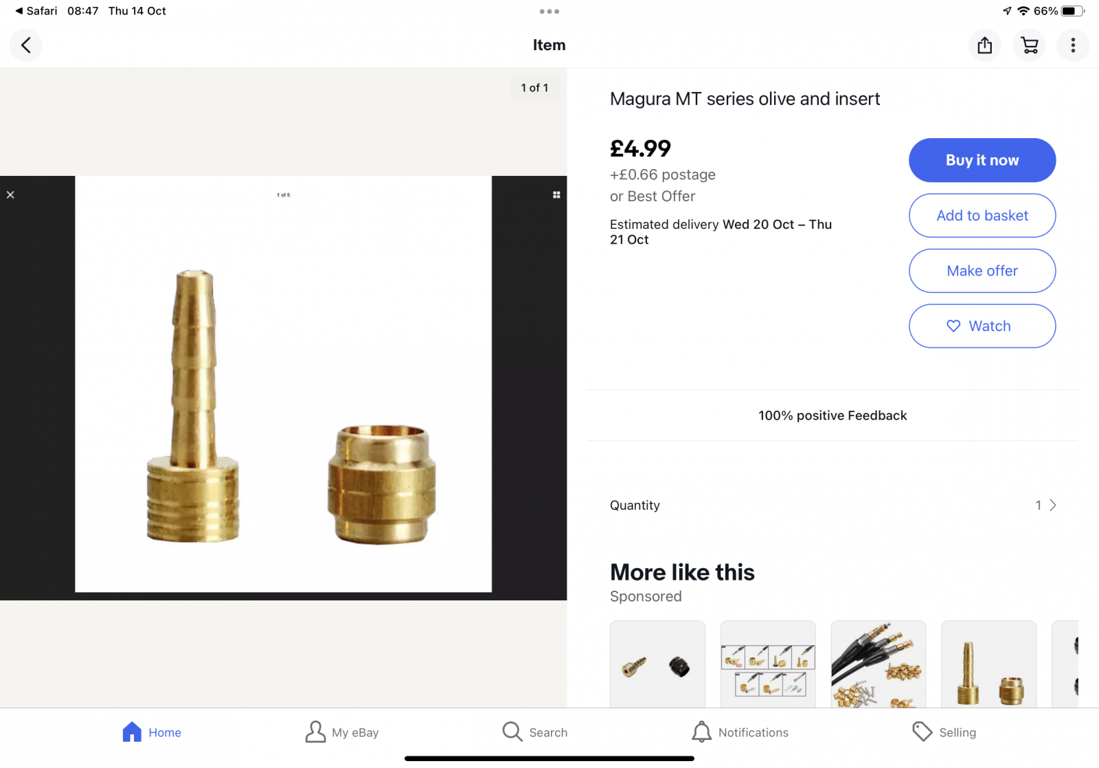

Mine was on a levo, so I used a little connector thing a majig to screw into the hose and used the old one to pull it through. Very easy. if you use the existing hose, you’ll need the inserts and olives changed to match the magura.

I just switched out to Magura MT5 calipers last month. You want to use the Magura brake line and barb and use a Shimano olive. I’ve had zero issues. Love the added power.
I have XTR levers.
