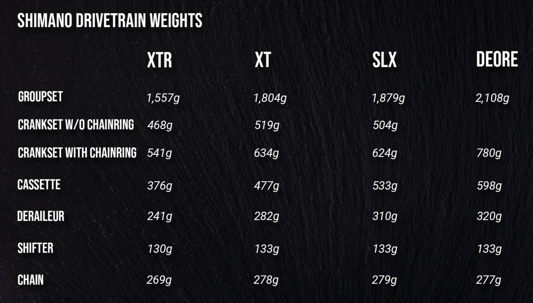

What the OP needs is a list of the various transmission options in descending order for Shimano and Sram
For Shimano its XTR at the top, then XT, then SLX, then err, what comes next? Is it Deore? :giggle:
XTR is for those who care about minimum weight, but it comes at a price. I have a mix of XT and SLX. XT is a bit heavier than XTR, but XTR will have other benefits of which I am unaware as I've never experienced it. SLX has all the performance of XT, but is again a bit heavier than XT. Over the years, I have read multiple times that SLX is the sweet spot for performance and price. That is the case for cassettes, rings, chains and brakes. I once snapped an XT mech. It was during the pandemic and all I could get at short notice was an SLX mech. I honestly could not tell the difference in shifting performance.
Not sure about Sram:
XO, XO1, GX......somebody help please. :giggle:
Yes, Deore.
The XT shifter can shift down two gears at once, while the SLX shifter can only shift down one gear at a time. Last year saw a couple of silly cheap XT shifters at Merlin Cycles so grabbed them. Nice when you need to slam down through the gears quickish ...
XX1 > X01 > GX, and X01 is the sweet spot. I think XT is the sweet spot on the other side of the fence.

Shimano weight table.
