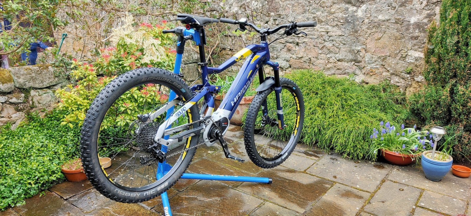

I am not keen on hanging my bikes from the dropper posts so bought a Park Tool PRS 22-2. Feedback do a similar workstand called the Sports Sprint. Both support the bike using a combination of a fork mount and a support under the BB area. I use my workstand with both a Levo and Whyte 180RS and really like it.....especially being able to rotate the stand to gain access to both sides of the bike.

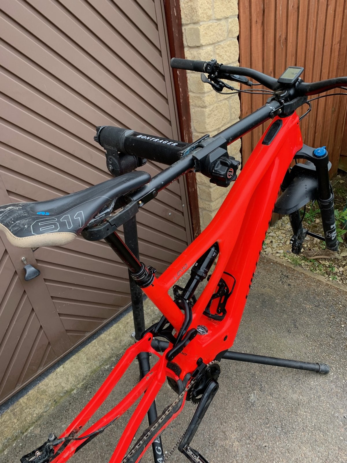

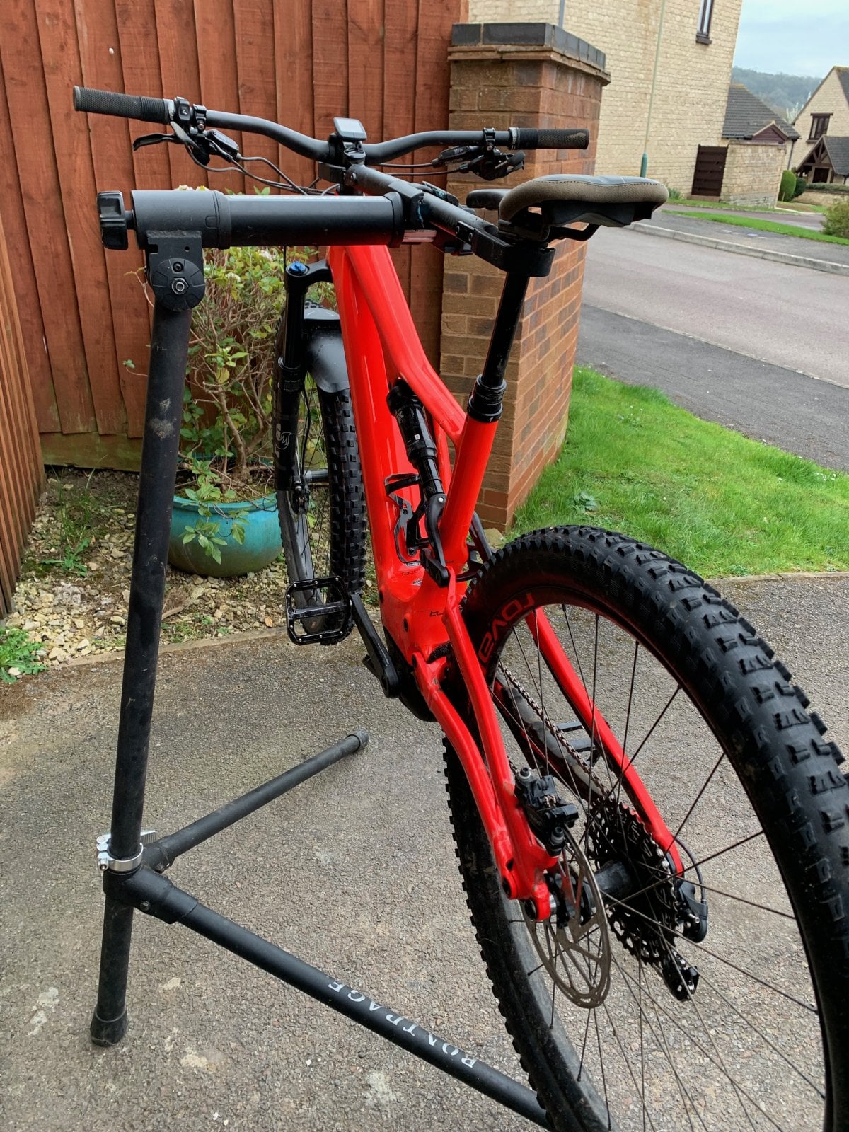

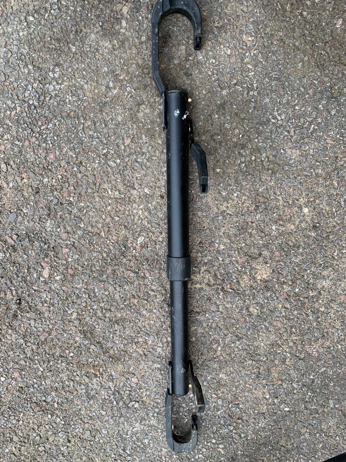

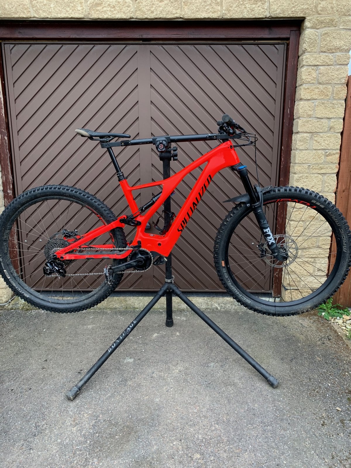

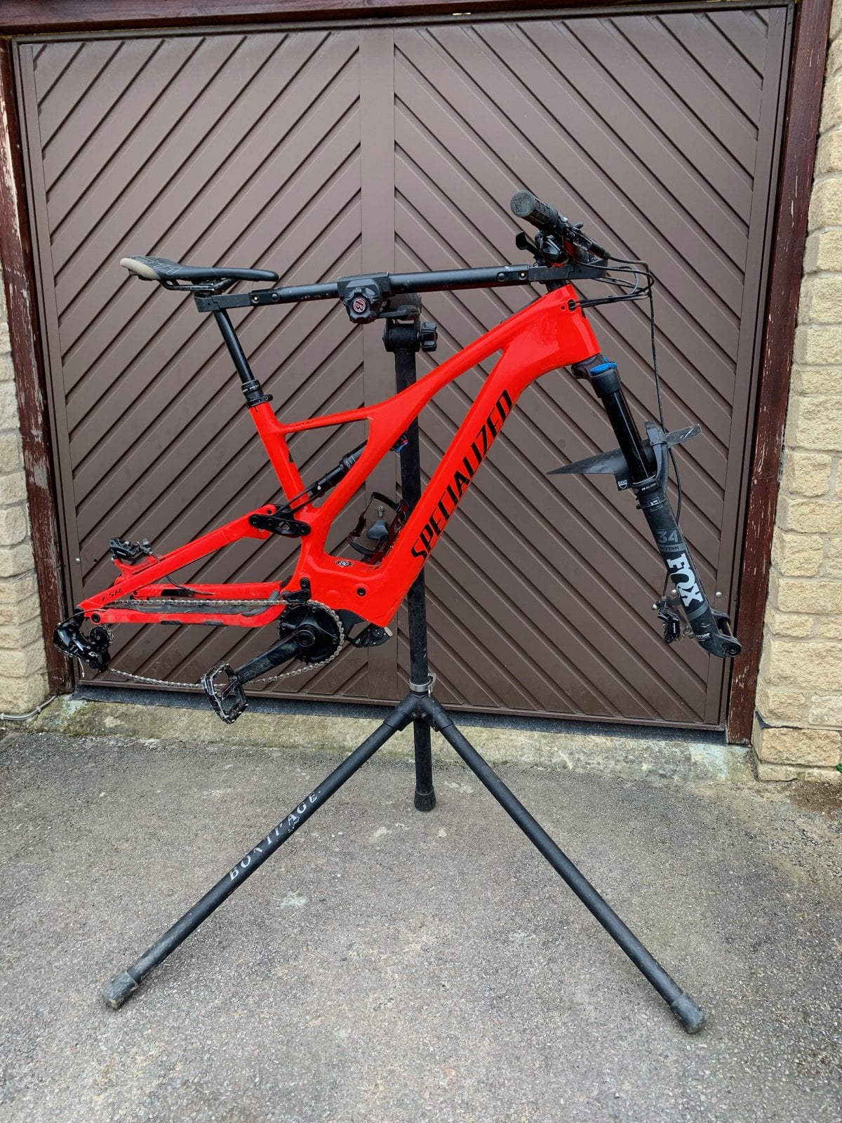

Ive already got a homemade bike stand which is bombproof, i reckon i could hold my old analogue bike in it and sit on it and pedal. Its made from 30x30mm steel box, today ive extended its height by 300mm, as the emtb is sooo much taller. next im making a bar to span under the handlebars and going backwards to sit under the seat. No way am i clamping carbon,im sure it will crunch, its not made to be clamped there.clamping the seat post will only elevate the rear wheel.
The bike sits front heavy due to the battery and motor, but suspending it from the bars and seat should be ok.
Got a pic?
Techno
Oct 18, 2020
73
19
dartford
The main frame of my bike stand is now 300 mm longer, im going to make a pop in top tube to go in between the fork stem and a fully extended seat post. pictures, hmmm im trying to master them. Ill hook up my i phone, pay the five quid to go advert free,then try again. watch this space.
