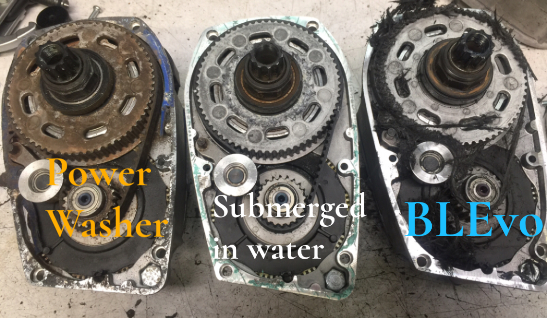

I am now seeing a few older Levos coming through for repairs that are out of warranty.
These are the three biggest causes of motor failures that could have been prevented.

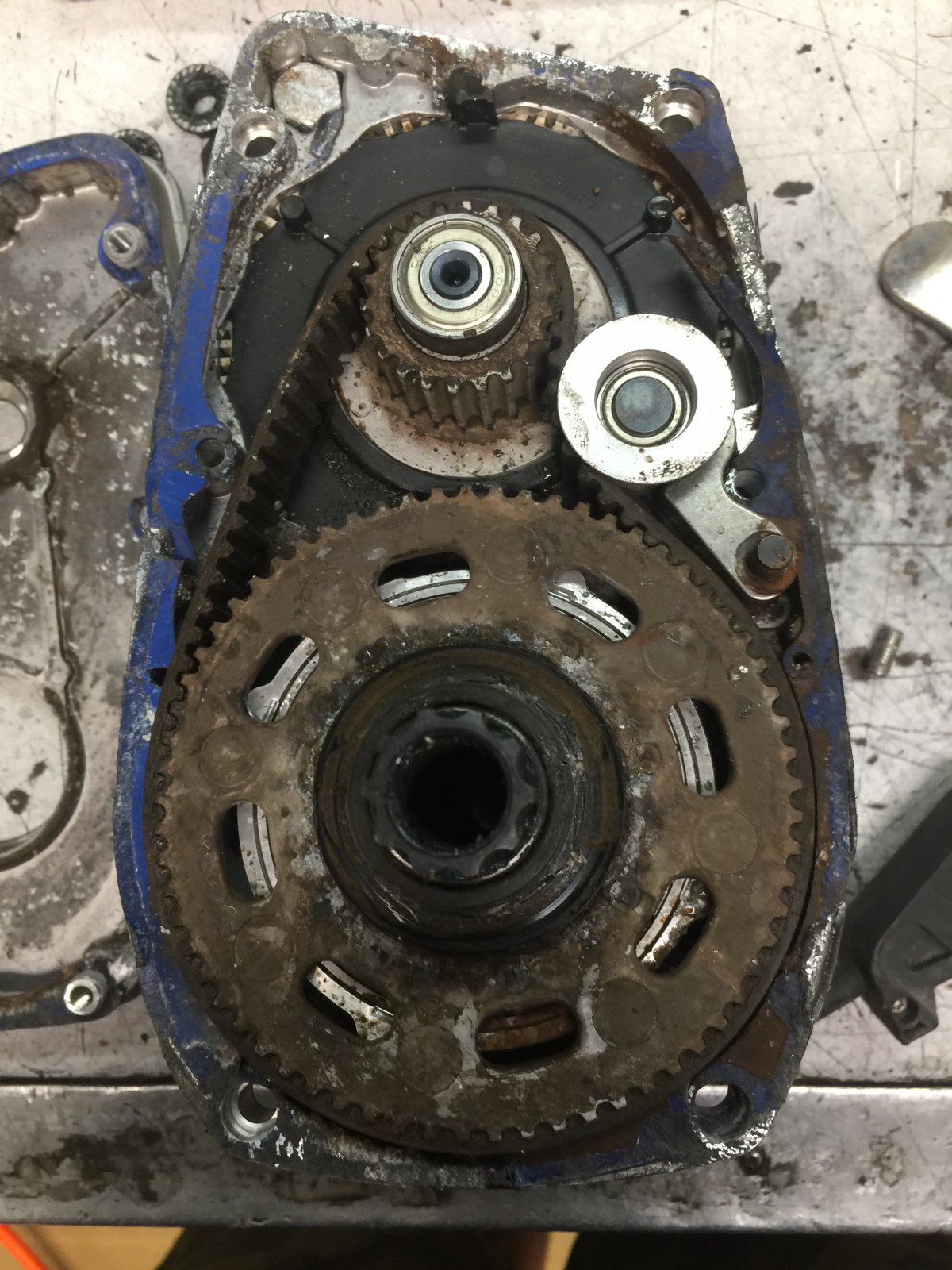

Are you replacing belts now Al? :unsure: Could you determine a specific point of water entry? ie thru the bearing itself
How are the bearings holding up and is there any other noticeable damage due to general wear & tear?
Did you belittle the guy with the power washer? :D

Al - Water ingress I can understand.
Why do you think BLEvo caused the motor to eat the drive belt?
Is there another explanation?
Because in every shredded belt incident the owner was using BLEvo on the most ridiculous settings possible. I don’t care if anyone uses BLEvo, but the belt doesn’t like to go over 30mph.
Also customers lie to me and tell me they aren’t using it when all I have to do is check with my phone.
Some of them come in acting like they are entitled to a warranty motor replacement.
It’s the chance you take.

With the power washer the water comes through the bearings bringing dirt in the motor casing. When I first opened this motor a year ago, it was still wet inside.
The bearings are pretty tough, but they won’t last forever. Most of the time the strange noise coming from the motor is dry bearings or bearings with dirt or debris in them.
I didn’t belittle the customer, which took a great deal of restraint on my part.
I have sarcastic streak that is only amplified by my aspergers. Aspergers=Asshole
He got a crash replacement motor, I installed it for a fair price and then the bike was stolen.

When BLEvo arrived, I immediately set about to find out just how fast I could make a Levo go. I changed the gearing and I changed out the wheels and tires with the lightest set I had. I moved the magnet to the cranks and played with BLEvo until I got the Levo to go 42mph.
Wasn’t that big of a deal, there are a shit ton of electric mountain bike styled motorcycles that would laugh at that.
On a 98 degree California day, I went for a quick ride on a trail behind my house. I could tell the motor was getting hot but I was going to do one last climb and head back to my house. There is a really steep climb called big red and I wanted to see just how fast I could climb it with this new power. I went as fast as the bike would go on the flat section leading to the climb, but when I hit the transition to steep at the bottom, the belt slipped for a pedal stroke about five seconds later the bike sounded like my wife’s Vitamix and there was no resistance at the pedals. The noise stopped about two seconds later and I could smell burning plastic. I completely fucked that motor over.
It was excessive heat build up, a belt that was only designed to go 28mph and the sudden change in load on the motor that led to its demise. When took it back to my shop after my ride was done, the belt actually was starting to melt because the motor got hot.
It’s still kinda gooey to this day.

So does that mean there is no thermal overload protection on the motor and is that still applicable on the current generation of Levo motors?
BTW, thanks for all your feedback Al
There is thermal protection, but after messing with BLEvo it never went into shut down mode. I don't want to come off like I am bagging on BLEvo, I really like most of the features and changing the top speed isn't a bad thing when used within reason.
