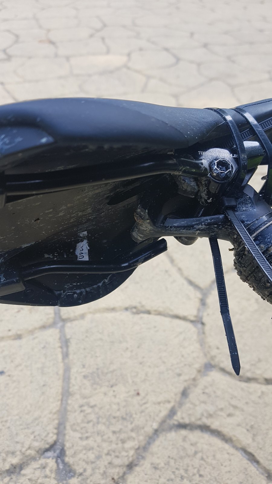

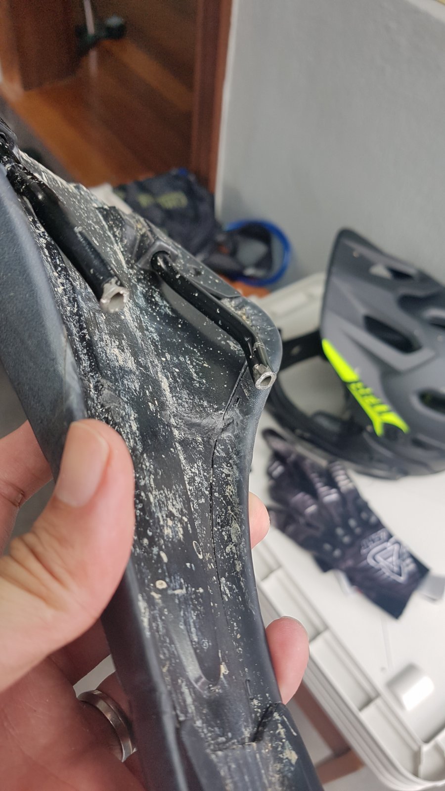

*warning* Incoming rant on CP and Spez seats
I had my first command post back in 2012, came with my FSR Stumpjumper Expert. Failed within a year..same with my ride buddy who bought same bike.
Fast forward to 2018, i get a new Sworks Levo, hated the CP at first use...it just wants to kick me in the balls every time and reducing the pressure didnt help, cos it causes it not to rise to the max.
Creaked like mad...sent it back to LBS after 200km...they agreed there was something wrong with it, and fitted a brand new one, no questions asked. (this was 2 rides ago)
Today...this happens....Seat rails sheared clean off ...not even at a jump/landing...just a simple fast uphill. Had to ghetto fix it with cable ties to get home.
Spez makes awesome bikes....they make shit seats and droppers. I have owned 2 KS, 1 reverb, 2 CP over the last 10 years....the KS and Reverb were bomb proof tru years of abuse.
The 2018 CP has the most frustrating seat clamp design in the world...fiddly, hard to adjust and creaks
Ok thanks reading my rant if you are still with me.... both are being junked...putting back on a reverb and WTB Volt

Yeah my Spesh Henge snapped the rails too and no warranty on that. Replaced it with the sports henge with solid steel rails as opposed to the original Comp with hollow CrMo.
No problems thus far.
