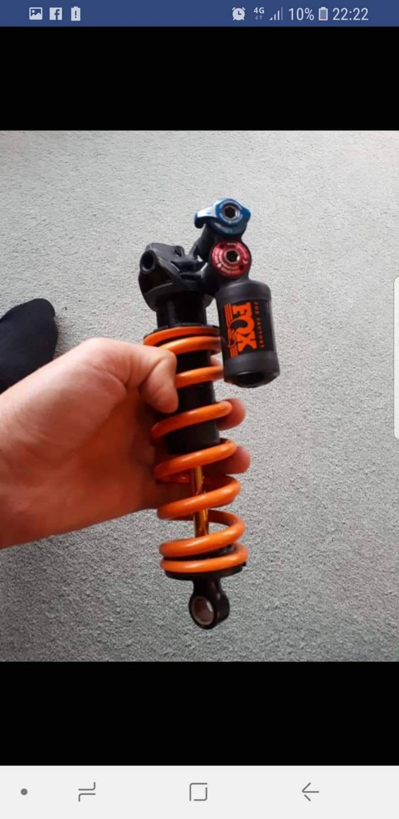

think am going to try the fox dhx2 as I can get my hands on one... Do you know what size / spacers I would need for the top and bottom??
The fox I can get is 205x65 so am guessing it be the same as the jade and give me the extra 5mm travel :).... Definitely going to increase the travel at the front as well to 170mm....

All you need is the mounting hardware that came off the bottom eyelet of your old shock. You have to push/tap the central axle through the eyelet and then put on the 2 x spacers each side.
I guess the only thing I can't verify in terms of fit in the frame is where the top of the spring meets the seat tube. On the Jade this is very tight, but on the Cane Creek there was a bit more room. The DHX2 takes the same inner diameter as both of these shocks, so you should be fine unless the spring is 'fatter' on the outside or the preload screw plate is wider. If the spring is really fat you could go to a Valt, which is slimmer and lighter by at least 100g.
Unfortunately looking at the pic I don't think Fox have made a 65 stroke by using a longer stroke with a spacer under the spring, so you will be stuck with 160mm travel, which is no big deal.

I was very lucky a guy here in the south island of NZ has it and manage to get it for 525 NZ dollars ...from the pic the stoke is 60mm but its at a bike shop at the moment getting the spacer install with some fresh oil :)
ok thanks hopefully i wont need to get another spring but if it does then i get a valt one, what size spring are you running for the 65mm stroke?

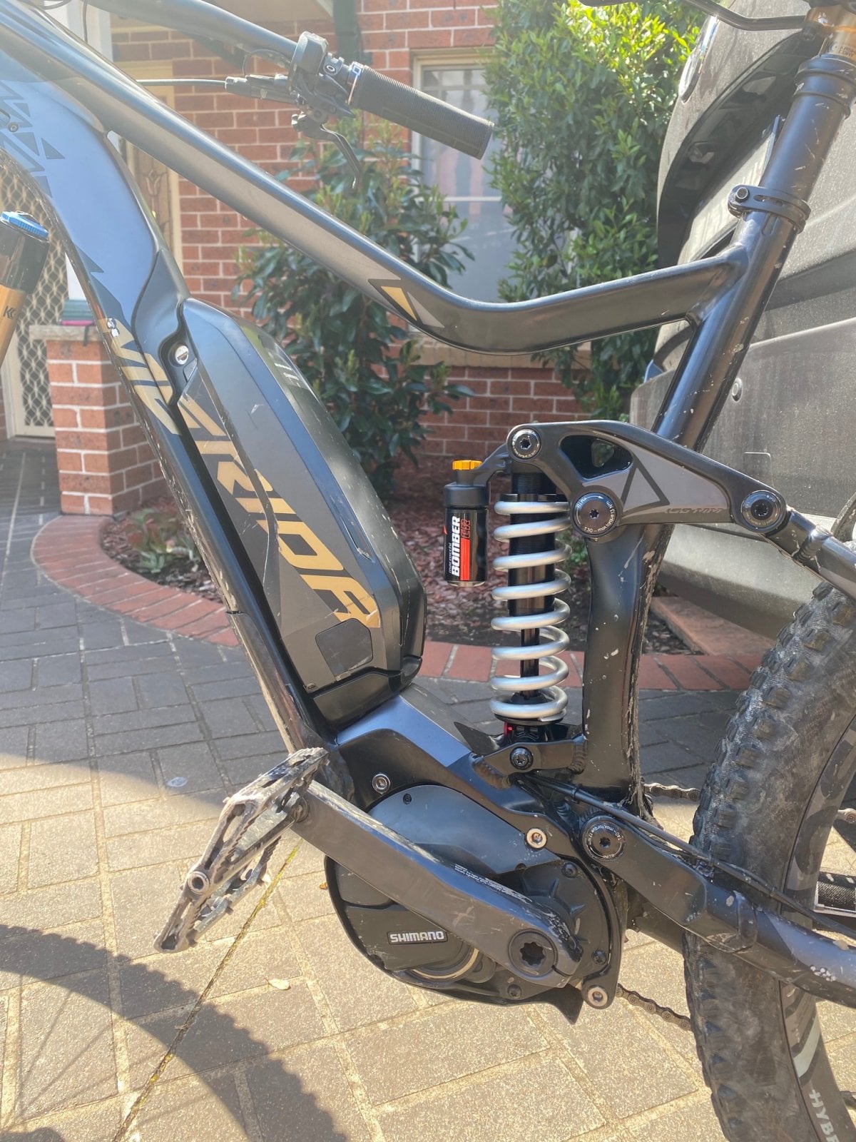

Got one fitted to my 900e yesterday.
Few small challenges. Thanks to covid I could only get a 205x60, this isn't a huge problem. Under the bump stop is a 5mm delrin spacer. Carefully snip that off.
Well, that didn't go 100% to plan, I accidently knicked the damper shaft resulting in a small scratch. Fixed that up, some 1500grit sandpaper and some nail varnish. Should keep the seal in check.
The preload adjuster and spring comes close to the downtube, but it clears by 4mm which is fine. A longer spring (I'm using a fox 500lb steel at 140mm) could hit the frame.
So far, the driveway test was very impressive. People think i'm nuts for replacing a fox X2 with a cheap marzocchi but we will see.

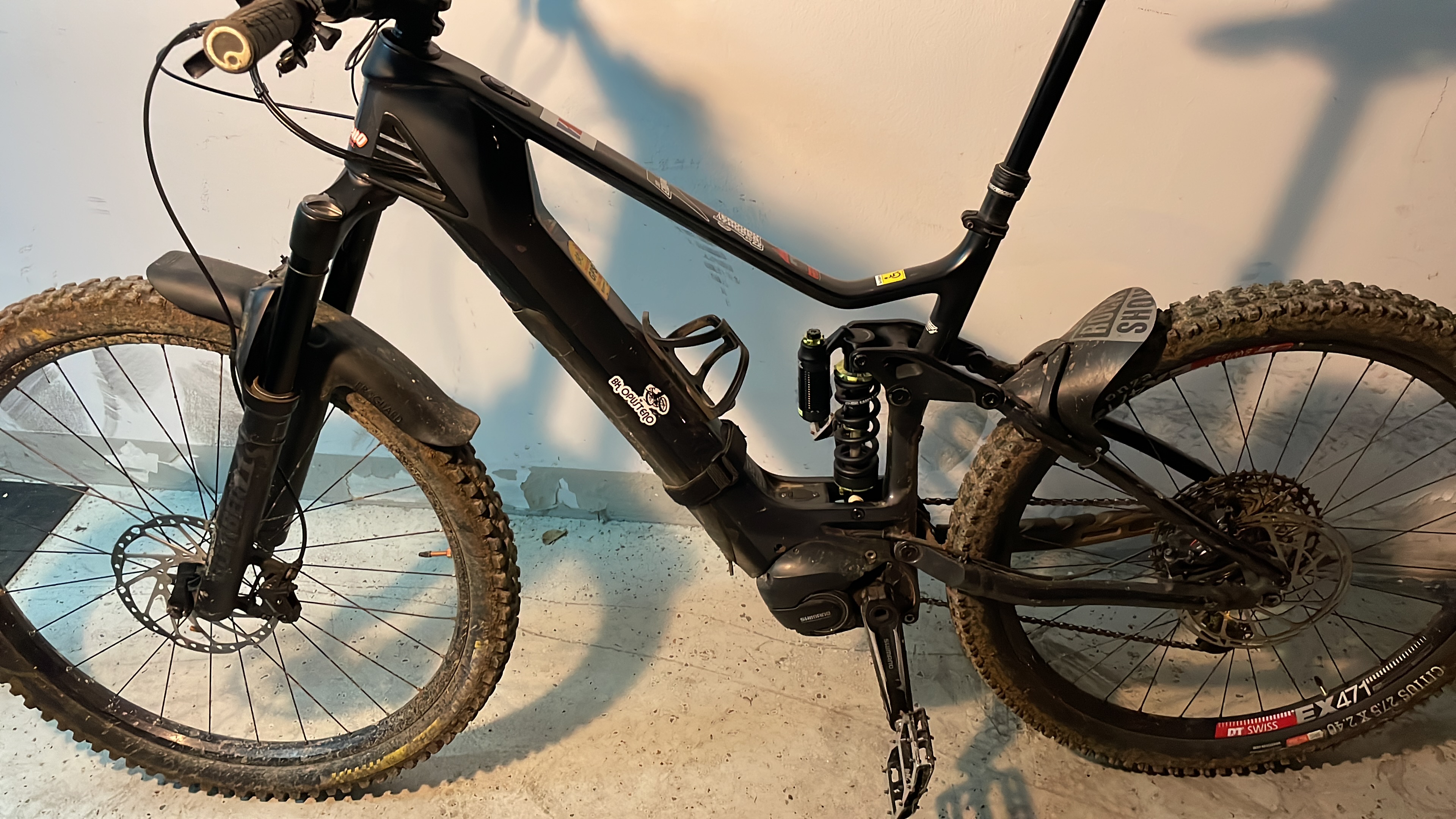

This post got me thinking and this is the result:
