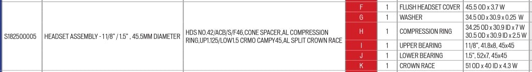

Gen 2 headset bearing kit is Spesh part number S182500005. An internet search will provide a list of resellers.
