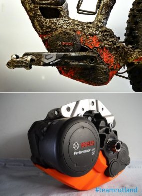

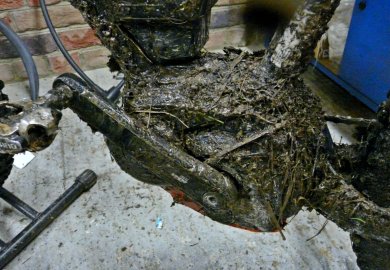

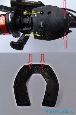

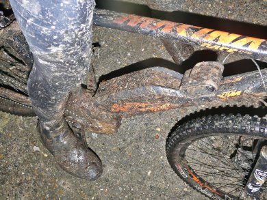

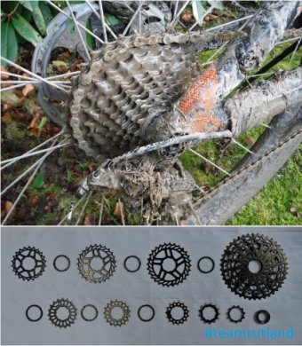

EvoKenevo, if you don't mind waiting a while, Through #teamrutland and Rutland Cycles I am in the process of producing what I hope will be one of the most comprehensive articles written about cleaning, detailing and maintaining eMTBs. I had hoped to have had it finished and published online by now, but there have been a few delays.
Although many aspects of the article will be cross compatible between brands, it will initially cover both the Shimano and Bosch systems, and then over time expand to cover other brands as the opportunity arises. The article will cover hopefully every thing that you will ever need to know, plus some of the pitfalls.
By comprehensive, I mean comprehensive. Just a little taster with some low resolution photos.
