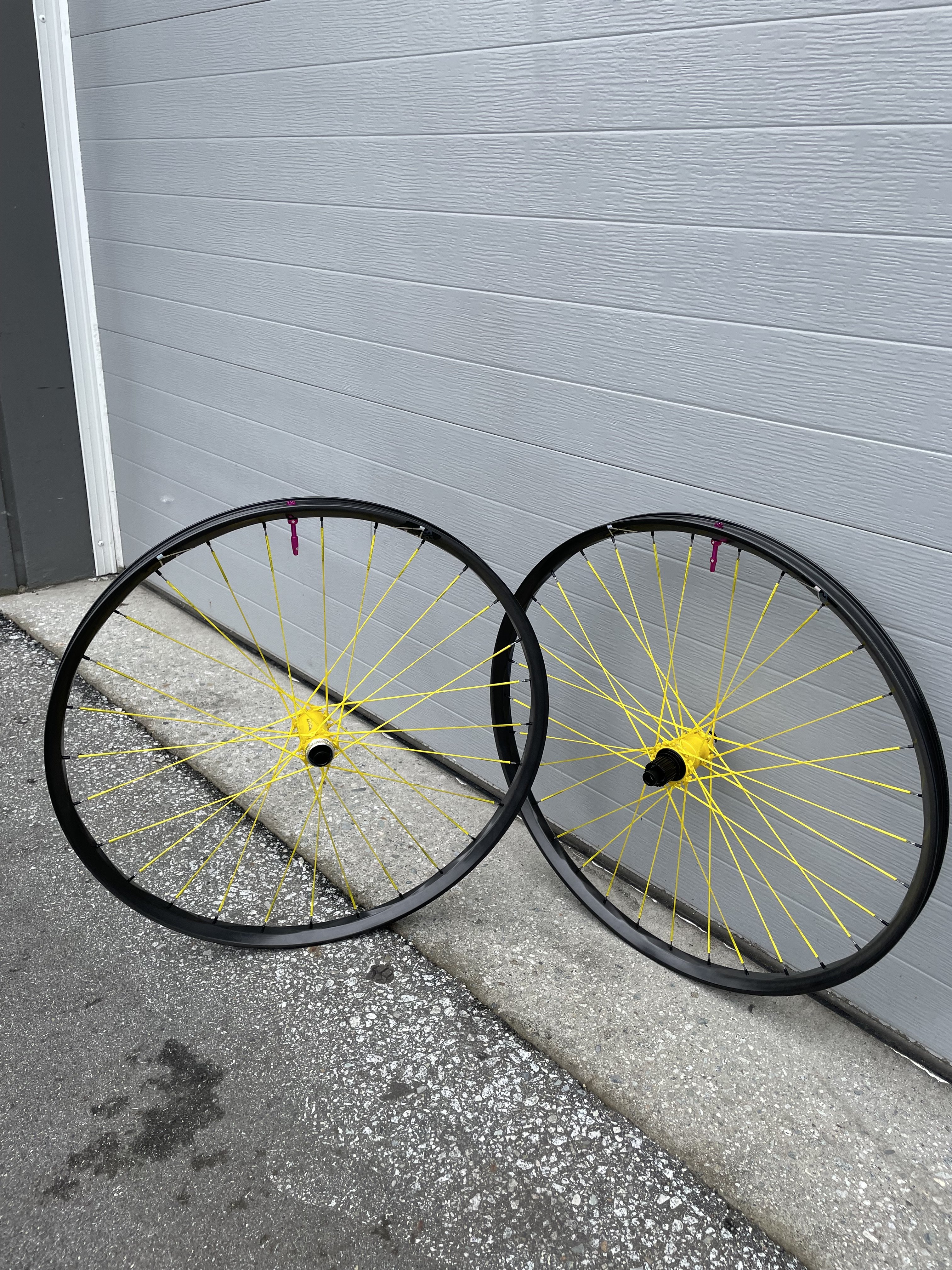

Maybe this guy could still cancel his order and get something more practical. IMG_6423.jpeg
@ragnor I think you have a good approach building a second wheelset so you can easily swap your wheels based on the terrain you'll be riding on.
I did something similar and always keep a second wheelset ready to go, in case I badly damage a rim or detroy a few spokes. I just don't want to deal with the downtime or miss a good ride!
For affordable, quality wheels, I would recommend the DT Swiss H 1900 Spline. For less than 300€, you get a very good set of aluminum wheels, 370 hub, ratchet freehub, 150kg max weight, ASTM 4 rating. Worth considering in my opinion!
