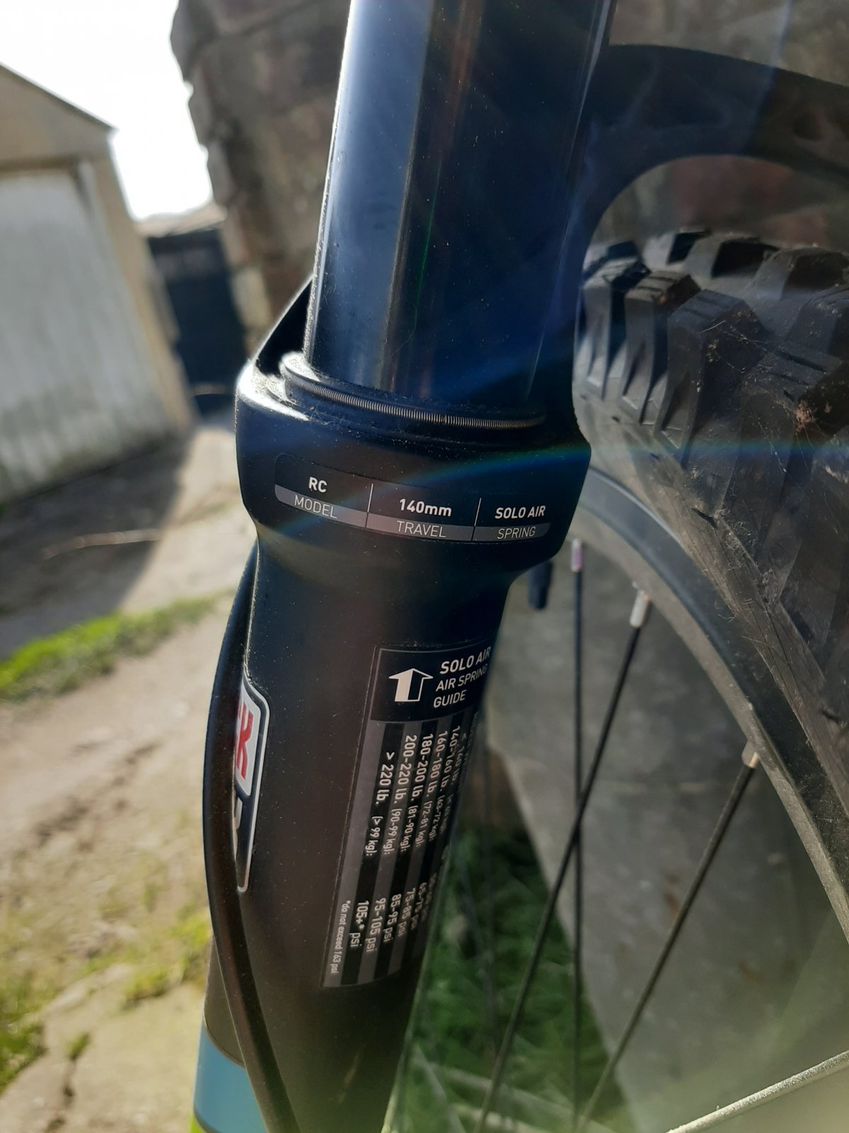

Hi, I have a spare pike with a charger damper (see photo). Would this fit into my 2018 revelation? I've put a 160mm air spring in the rev, if this makes a difference.
thanks in advance.

Ok, I've done a bit more research. The charger 2 rct is compatible with both my forks. So surely my normal charger from the pike would fit?Anyone done this before I start pulling things apart.
Thanks again

Revelation and Pike can be swapped. Lyrik and Yari can be swapped. I put the charger RC out of my pikes straight into the revelations and upgraded the Pikes to 2.1
This was on a 2019 Levo expert and a 2019 Levo Comp.

Thanks for this, did you notice a big difference with the charger over the motion control?
