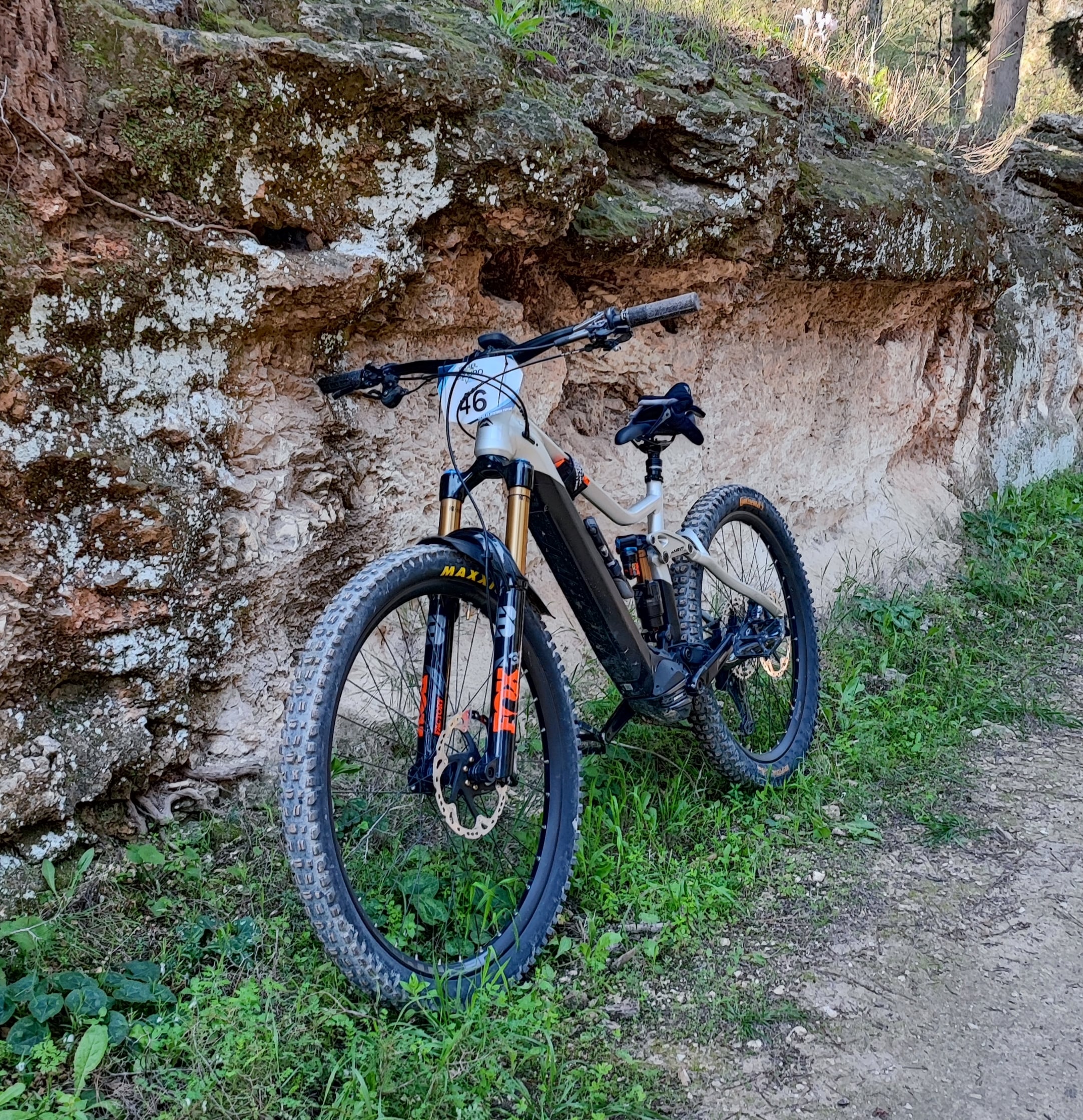

Hi friends.
Has anyone tried to change rear wheel travel? From 150 to 160?
Is it even possible?
Bike like the levo's has the cascade option.
