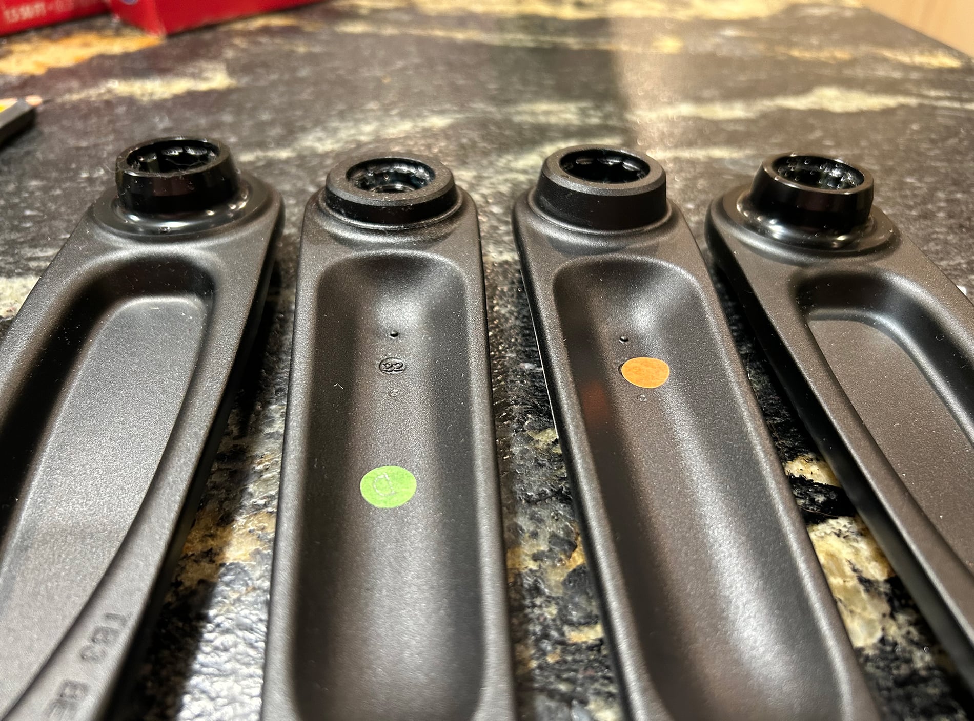

Hi Sam_pinnd,
You mentioned "We are working on these and they aren't far from release (next couple months)". I'm curious, who is "We"? I recently swapped out my Specialized OEM cranks (Praxis Offset) for a set of SRAM XO (Brose) cranks, and as you mentioned, created a 4mm divergence. For me, the difference has been negligible but I'm always interested in other options. I believe Hope Tech makes a Levo specific crankset but it's not within my budget at the moment.
For anyone interested, here is a comparison photo of the Praxis (middle two) and SRAM cranks (outer) side by side. One other note, the SRAM XO and GX (Brose) cranks are identical other than the finish (and price).
