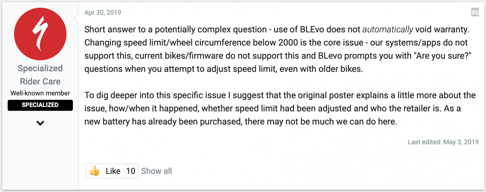

I’m not sure if this is the same thing, but according to this it can be changed down to 2000.

In EU speedlimit is 25km/h. Now i'm mulleting(or 27.5 to front also) my 2021 Levo and if you set the wheel size below 2300 it voids warranty.
Sucks.
This is not true, changing down to 2000mm won't void warranty.
You are right, i asked that from Specialized Nordic; if dealer changes tire size to measured 27.5 tire it won't void warranty. But i think changing down to 2000mm will. :unsure:
Again, if dealer changes it down to 2000mm it won't void warranty.

I have it set to 2000 from day 1. After 4kkm they replaced motor under warranty...
