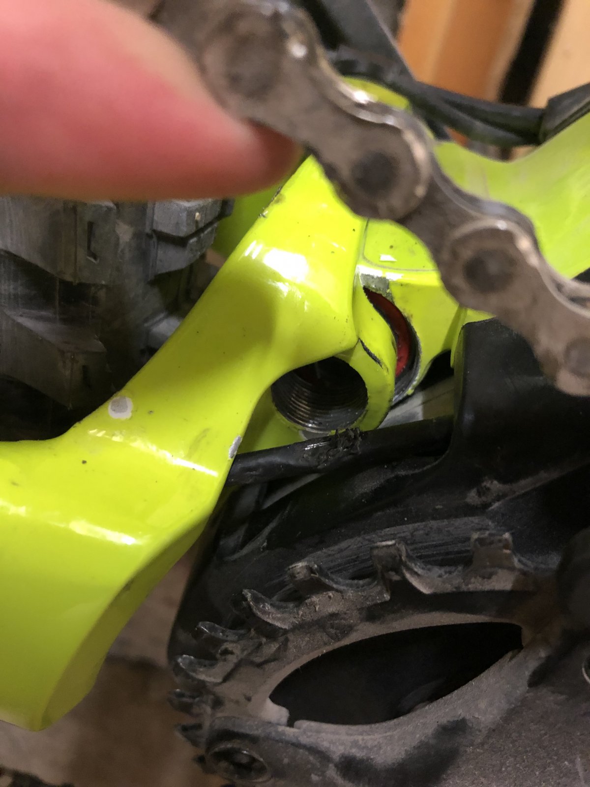

Mine snapped on Monday the bike was only two rides old..

I've snapped the pivot bolt as well. How did you manage to get the old one out? The bolt now just spins. Also, the threaded end is still screwed into place. Is there a special tool?
No special tool to remove the threaded part. Find something to grab it from the inside, I used a pair of scissors. For the other part you have to find something that fits and hammer it out.
