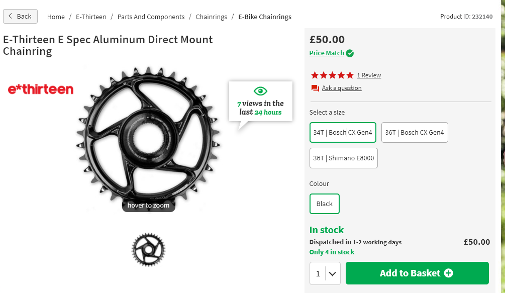

The chainring though is baffling me. I ordered an e thirteen chainring to match the spec of my Trek Rail, whcih clearly shows the Bosch Gen 4 as compatible. Upon arrival, the spline teeth are much finer that my bosch motor (which I guess means its a shimano part?)

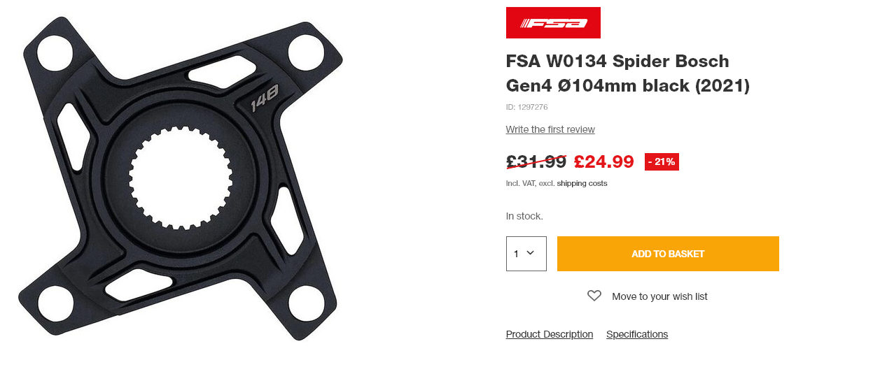

It looks like I can get a spider for next to no money (anyone know if these are any good?)
Meaning then that all I need is a chain ring with 104 PCD (no probs) that is compatible with 12 spd...

Have you got a link to that spider? I seem to recall they do boost and non-boost so you need to be sure to order the correct one.

I think I've managed to get my hands on a direct replacement for the stock part, but it seems so easy to make a mistake or to simply not find the thing you need... It's bizarre.... Perhaps I should start manufacturing chain rings!

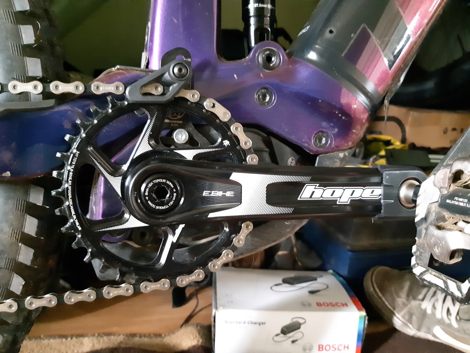

I ordered 4 chainrings after nuking mine, get the ethirteen steel 34t chainring direct form E13 and you will be good. aluminium would worry me steel bent like a pretzel as it was.
