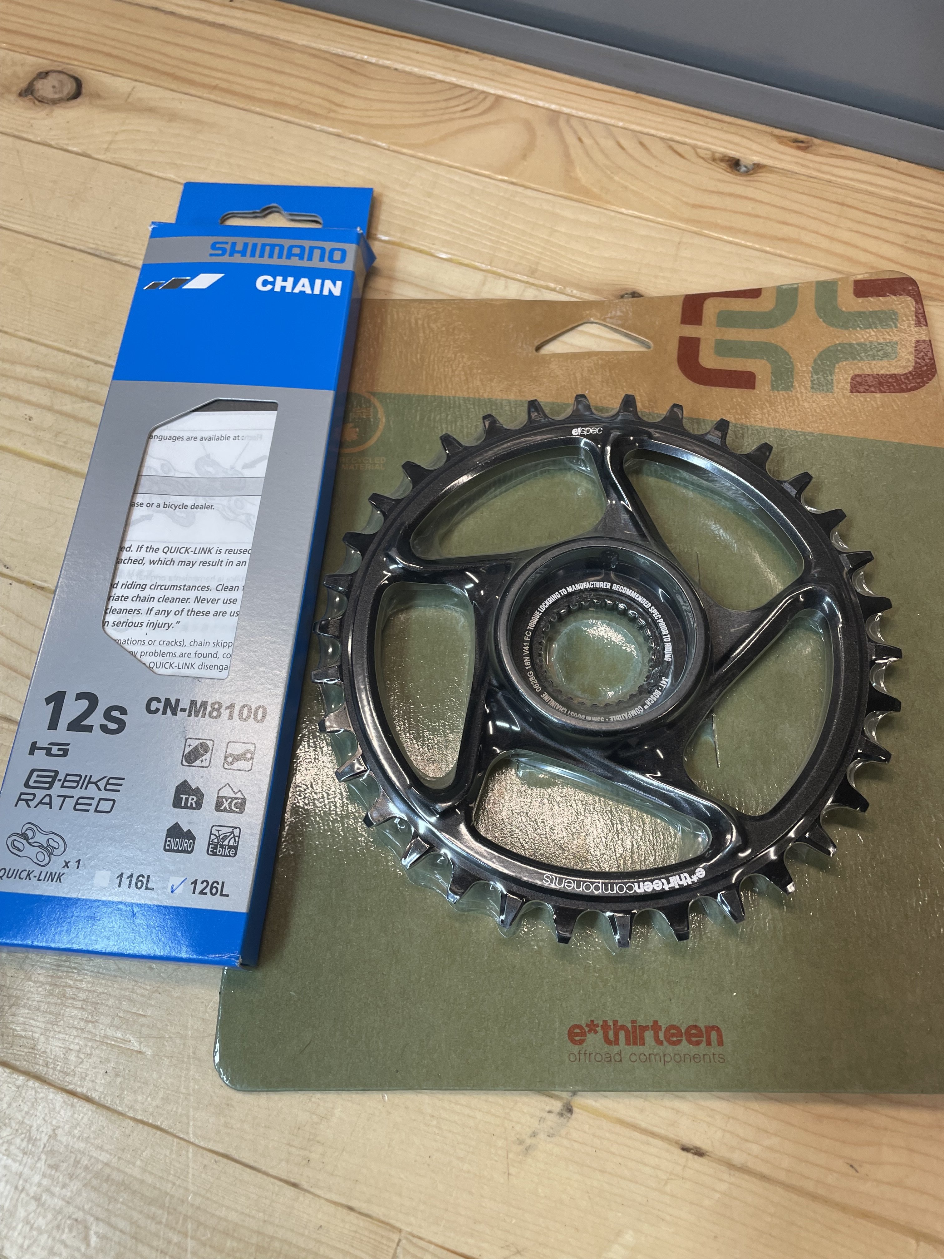

Anyone move to 36t and if so what chainring?

I’ve replaced the chaining twice on my Rail after it became worn out. An ethirteen 34t was my choice.
The clearance was not an issue with this 34t chainring. However a small ring-washer had to be omitted for proper alignment. A raised portion on the new chainring eliminated the need for this washer.

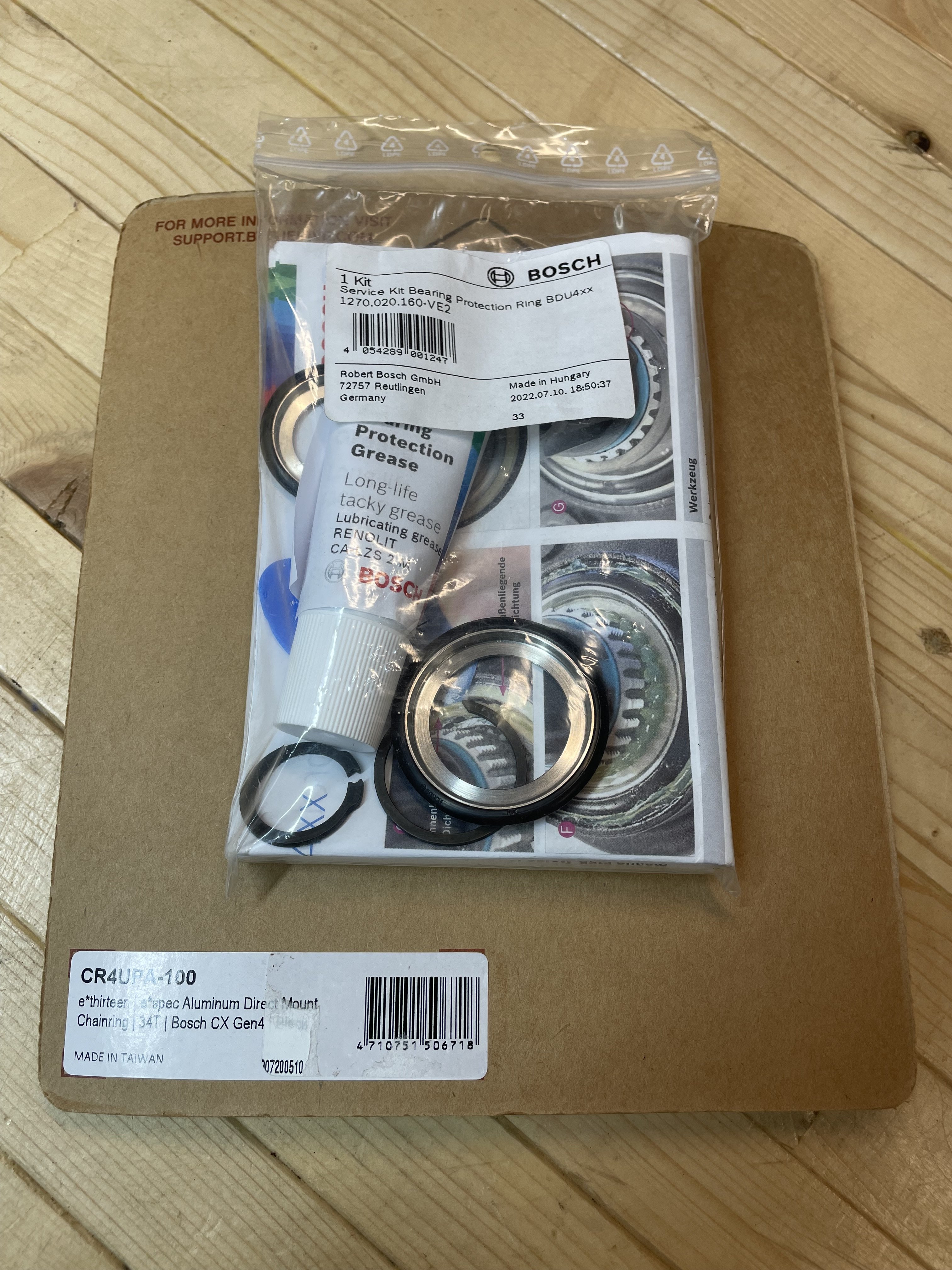

While you’re replacing the chainring, do a bearing seal service.

EDIT: went to e13’s website, noticed they have aluminum and steel (out of stock) chainrings, with this difference:
Chainline:
Steel: 52mm
Aluminum: 53mm (Boost chainline)
Looks like you have the Aluminum one, and Rail specs show the original is steel … I wonder if that 1mm chainline difference is where the ring washer comes into play.

The difference between steel chainrings vs alloy chainrings is wear vs weight …respectfully. I prefer an aluminum chainring.
I really recommend the bearing seal kit for the Bosch CX motor. The type of grease used is more resistant to water ingress. Removal of the crank bearings is not necessary or required during installation of the bearing seal kit. Both drive side and non-drive side is fairly easy when installing the seal kit. Apparently once a year is recommended. The kit is usually less than $20.

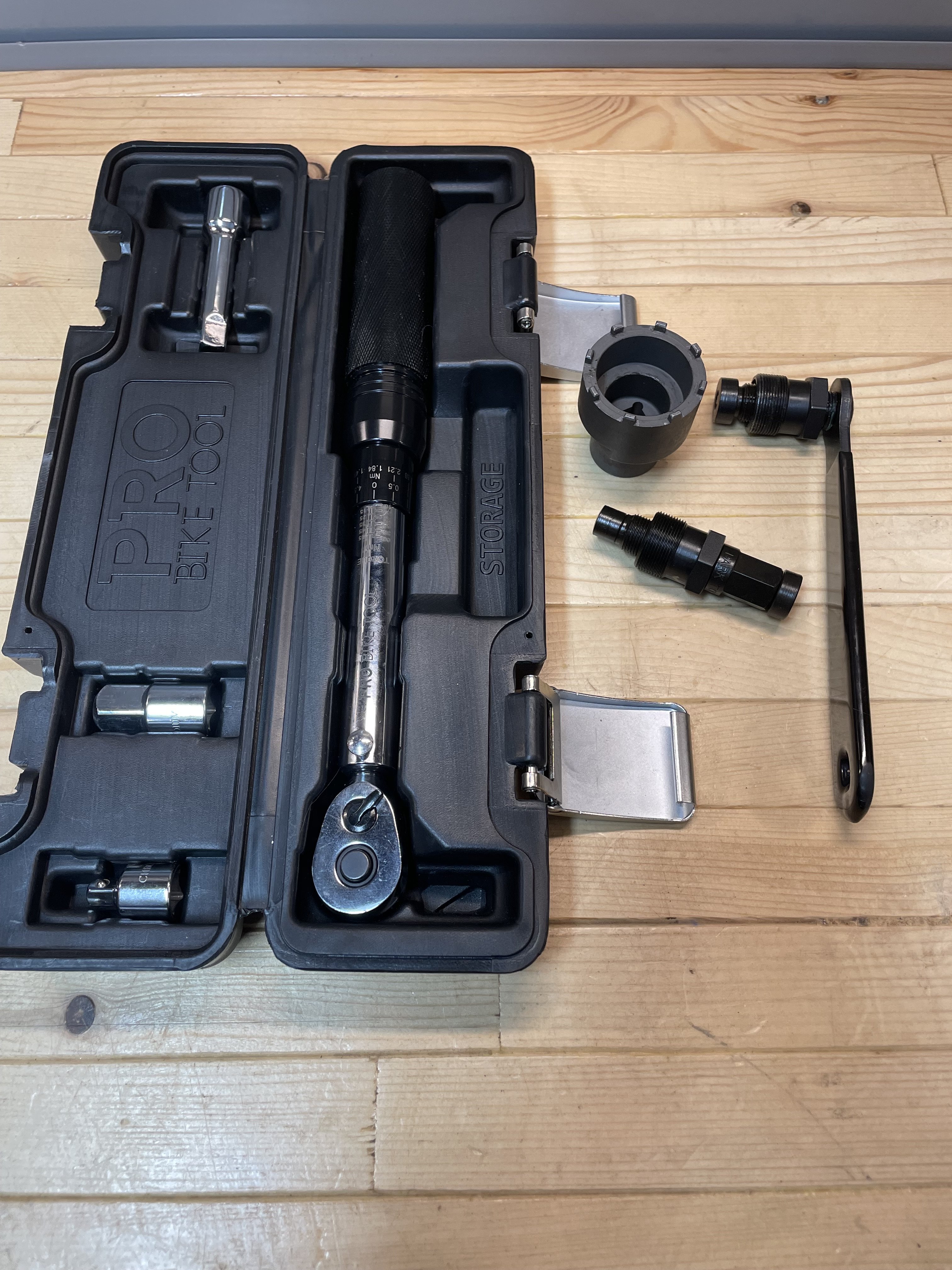

Could you please let me know the name or the place you purchased you chain ring locking nut removal tool (for want of a better description).
Is there much a drama with the seal kit installation as this is something I haven't thought about but can see the benefits of replacing while I have it apart. Thanks in advance, cheers Steve

I believe I ordered the Castle socket, or spider socket, through my LBS (Trek).
The first time I installed a bearing seal I had to familiarize myself with the process. The next kit I installed was easy(45min maybe?
