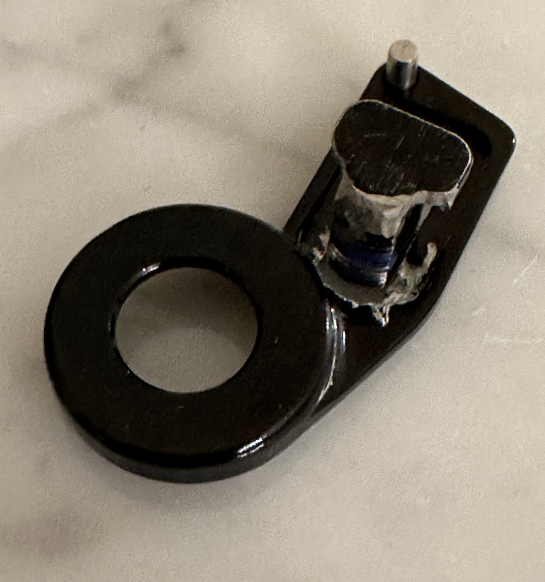

Installed the Praxis 36T and stock chain guide on my 2022. Chain guide I modified with a dremel to gain the 3mm needed to fit the 36T chainring. Thanks to this forum I've learned so much.

The dremel grinding I did to get the chain guard to fit was to the stud and mounting bracket. Took some time to get the two pieces to fit but no issues with installing and clearance is perfect.
Painted bare metal areas with enamel afterwards.

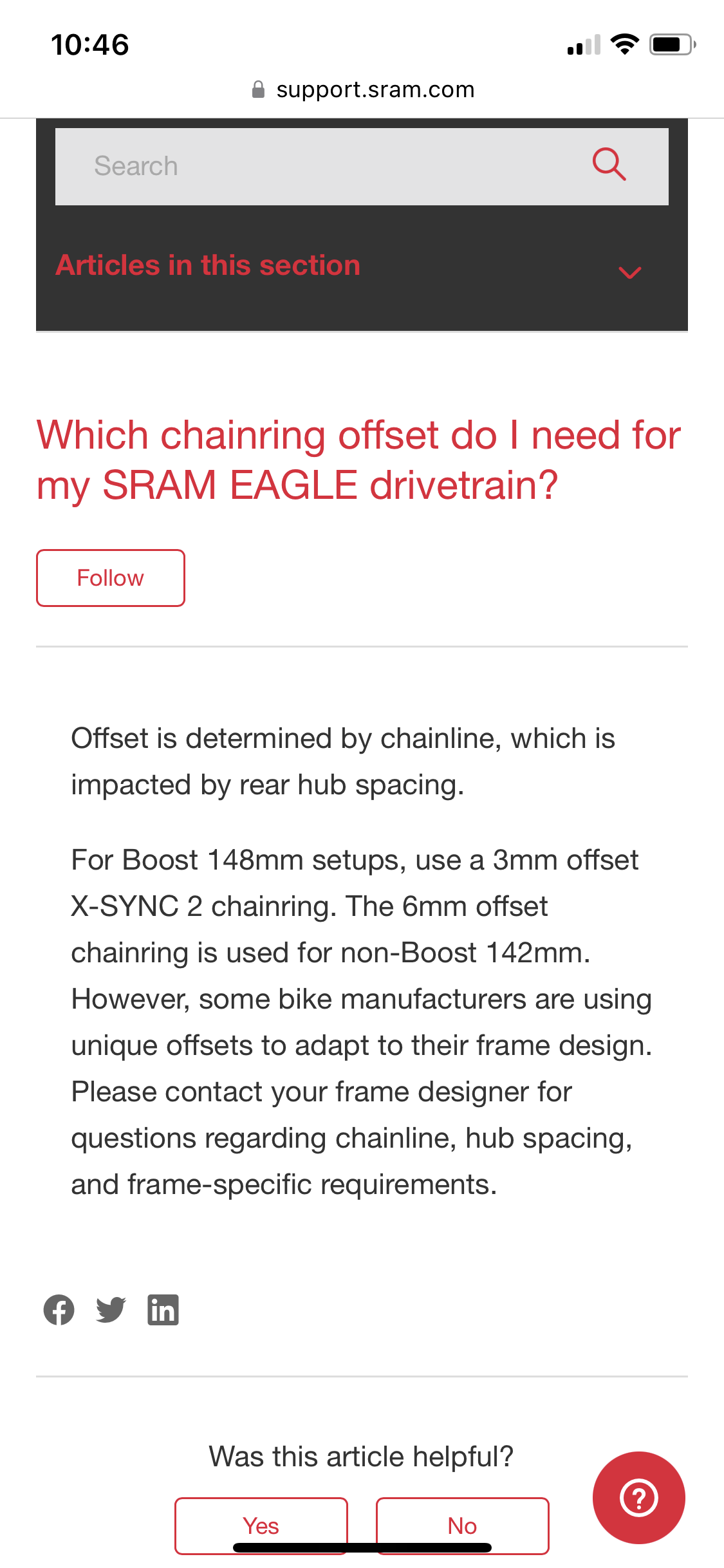

Hi. Did you have any issues with the chainline with fitting the praxis to the Gen 3 ? As I believe the standard sram x sync 2 chainring has a 3mm offset. And going by the measurements taken above this would be correct Thanks

I removed the chain guide as it’s not like the Gen 2 versions where you can just twist the whole thing around to fit the bigger ring & I’ve not bothered to modify it. The inside plate has a small pin that sits in a hole in the frame so have just left that piece there.
