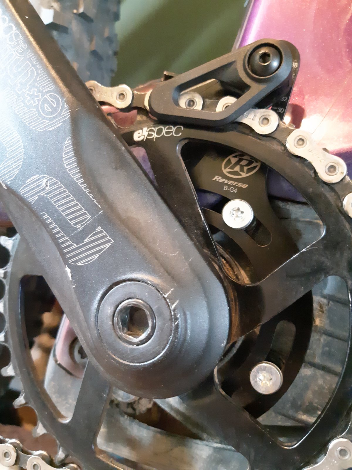

Reverse Components B-4G is good replacement.
Pros:
- metallic
- adjustable in horizontal from the black allenbolt (you get enough clearance for the chain on left and right
- adjustable in vertical (allenbolt behind)
- cheaper than e*thirteen

Did you need to remove the chainring to fit?
No.
You can see the access to the fixing bolts. Also fitted one to my wife's alloy Rail.
Edit: but you need to use the original bolts and spacers.

I did, but you can access the holes through the chainring if you want, I take my chainring off, clean up around the bb/axle area, then there is a clean area where the chainguide goes and easier job, I dab a bit of grease on the washers, which helps keep them in place on the arm when lining it all up. Then loctite the threads on the chainring lockring and tighten up as much as needed.
