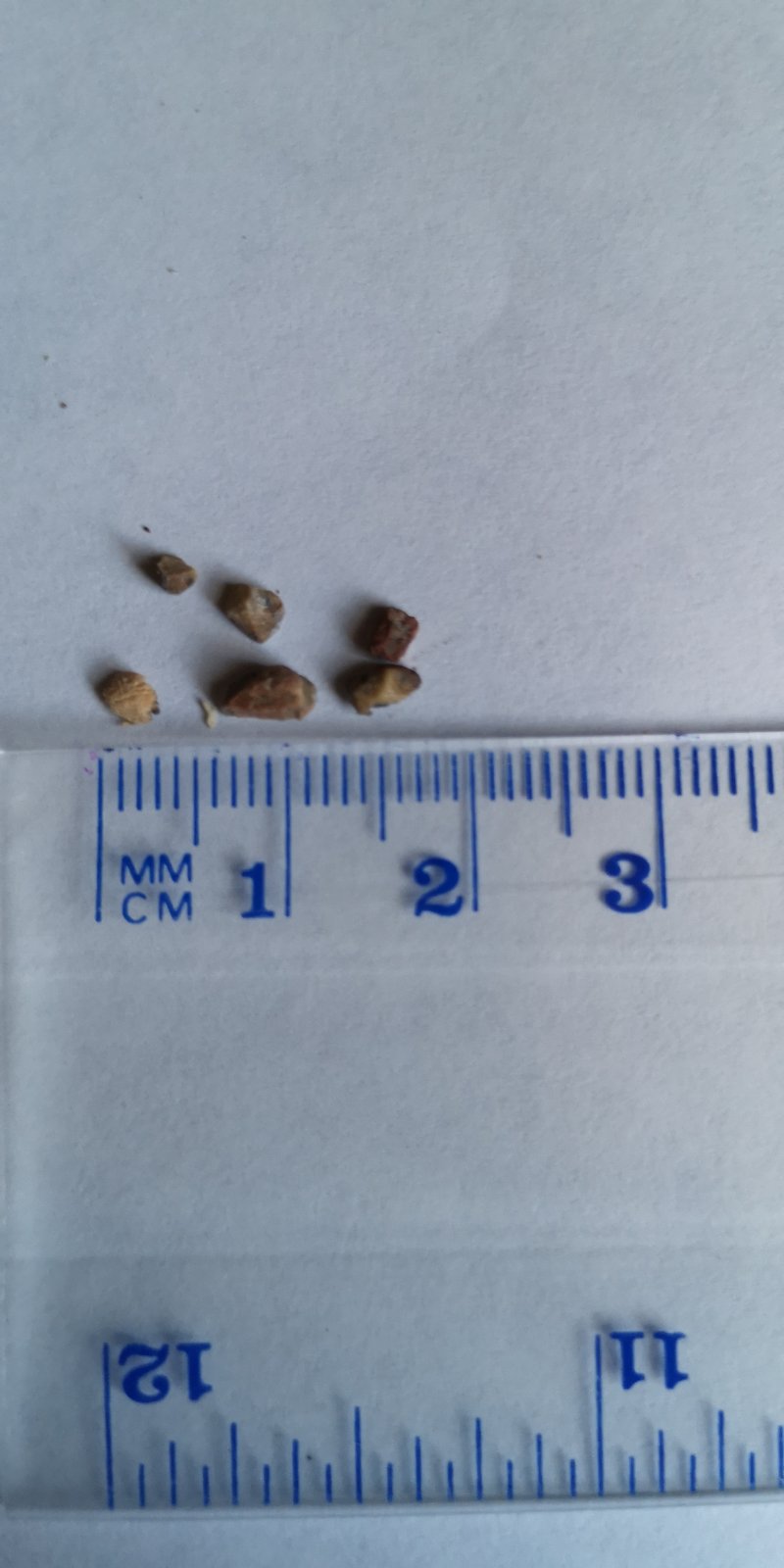

Out today, 15 miles from home the chain started jumping when on the 14 tooth cog. Nothing visible except the usual crud stuck to the cassette. Full clean-up and inspection once home, found these stuck either side of the cog.

Out today, 15 miles from home the chain started jumping when on the 14 tooth cog. Nothing visible except the usual crud stuck to the cassette. Full clean-up and inspection once home, found these stuck either side of the cog. View attachment 85328
Geez, I probably have the same thing - I'll go and look now. Talk about brain dead. I've felt a bit of a slip in the higher gears, gave a casual glance, looked at derailer alignment, and continued on - doh!

18 years of riding, 4 bikes & numerous rear cassette's/ chains I've never had anything except grass in-between the cogs. It's got to be down to the grit finish on some of the cycle paths & footpaths. The mud and puddles are better surface for bikes.
